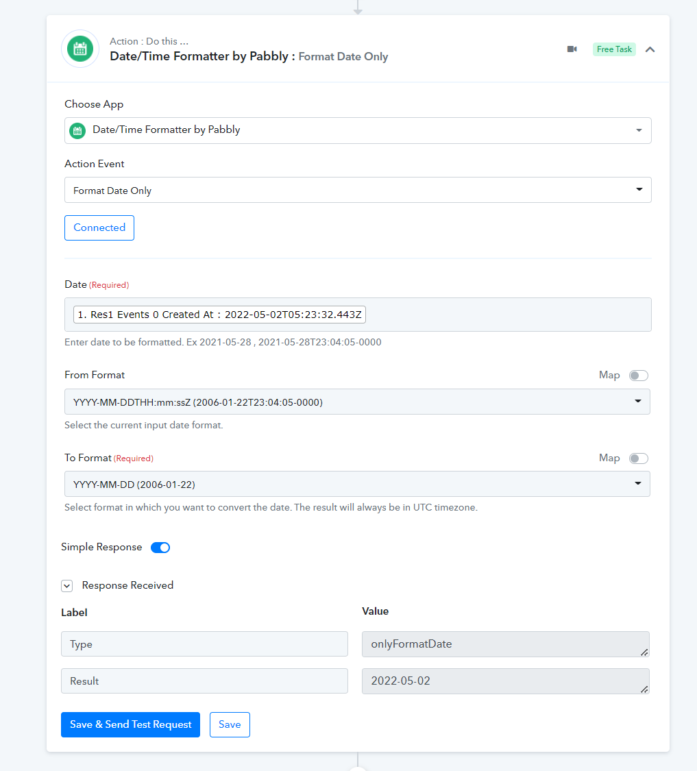

We looked into your workflow and it is working correctly. We have re-executed one of your latest tasks and it is working.
Though to convert the Date/Time from the created time to "YYYY-MM-DD" you can use "Date/Time Formatter by Pabbly: Format Date Only"(free).
Kindly try this at your end and let us know if that works for you.
