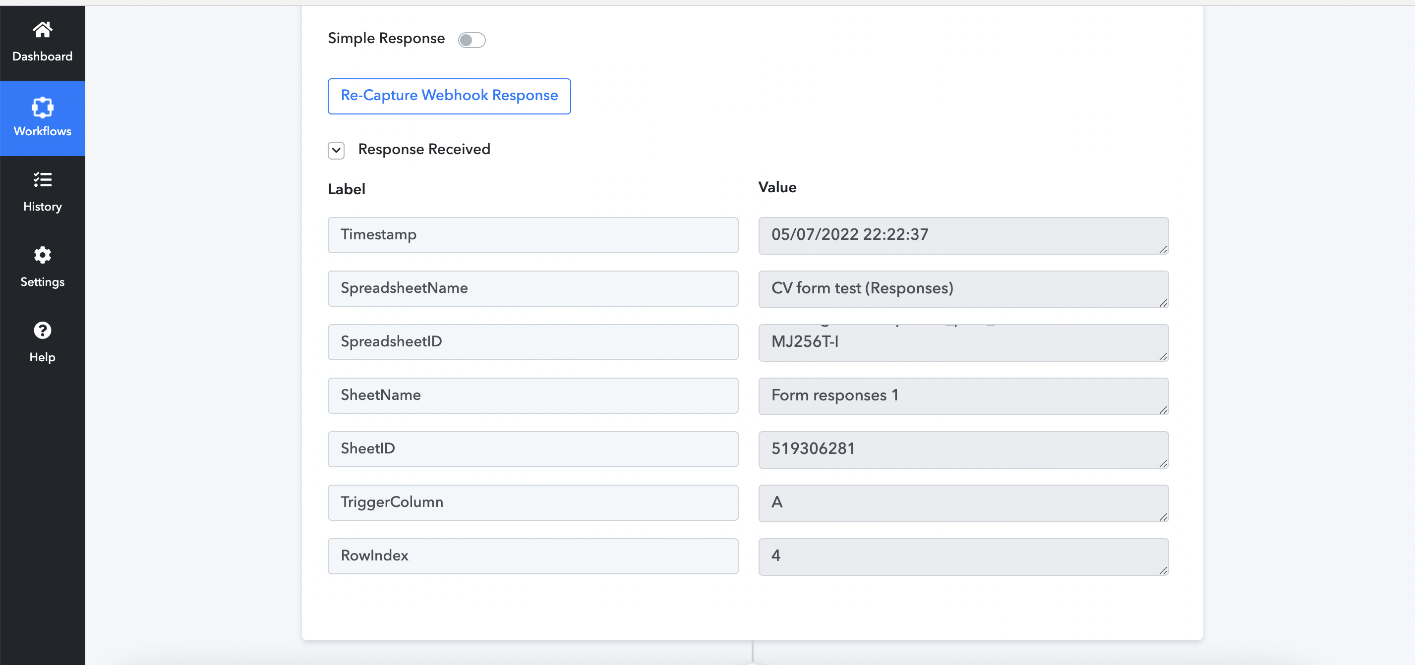

I have google sheets which is connected to google forms.
I am using a Google sheets action in Pabbly connect to get all the fields and their values which I would like to use in the next step.
Unfortunately as seen below screenshot the webhook response is not receiving all the data from google sheets. May I know what is the problem and how can fix this issue?
Fagun Shah — Reply ·
You need to set the last column with data as the trigger column in Pabbly Google Sheet addon.
Currently you have set Column A as the trigger so it will only send 1st column data.
Change the trigger column to last column with data and it should capture all the fields.
