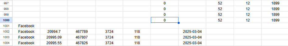

I have made a workflow in which I am fetching data from facebook ads and appending it to the google sheets, I have several clients and it is working for all other clients but in one client the data is not being added to the sheets.
The data is being correctly fetched as I have tested the workflow the part where the data needs to be appended at google sheet shows successfully updated cells but the changes are not being reflected on the google sheets.

Dear @Rishabh1,
Upon reviewing your Google Sheet, we noticed that formulas are present up to row 1000. As a result, default values have been added to certain cells, causing the workflow data to be inserted below row 1000 instead of the expected location. Please refer to the attached image for more details.
To prevent this issue, kindly ensure that no formulas are pre-filled in the sheet.
