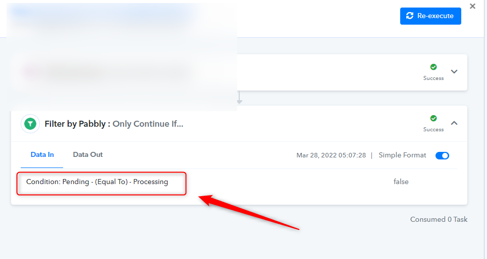

For the last 10 orders that I have received, the automation doesn't seem to work
When I checked the automation 'Task History'
The filter is always finding the condition as false
Need your intervention in this matter
Supreme
Hey @ANONARAY
We looked into your workflow (WooCommerce To Convertkit & Zoom) and the Orders which you are getting from WooCommerce have the status of "Pending " which doesn't satisfy the condition of the filter action step.

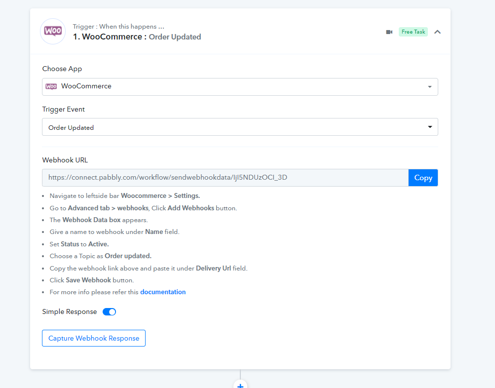

In that case, you have to use another trigger event with "WooCommerce: Order Updated" and for this, you need another workflow that will only work when the status of an Order gets updated.
Hey thanks for the reply
I tried to create a workflow with the above-discussed parameters
But it is becoming all the more confusing and complicated
I was not able to complete it, you can check the workflow

Supreme
Hey @ANONARAY
The "WooCommerce: New Order" will catch the order with all the status types as you mentioned. But for those users whose order was pending or processing might not be captured by the same trigger event.
So, in that case, you have to use the "WooCommerce: Update Order " which will later capture the order which gets updated from Processing to Completed or Pending to Completed.
(Please check out the following video tutorial for a better understanding of Update Order in WooCommerce)
