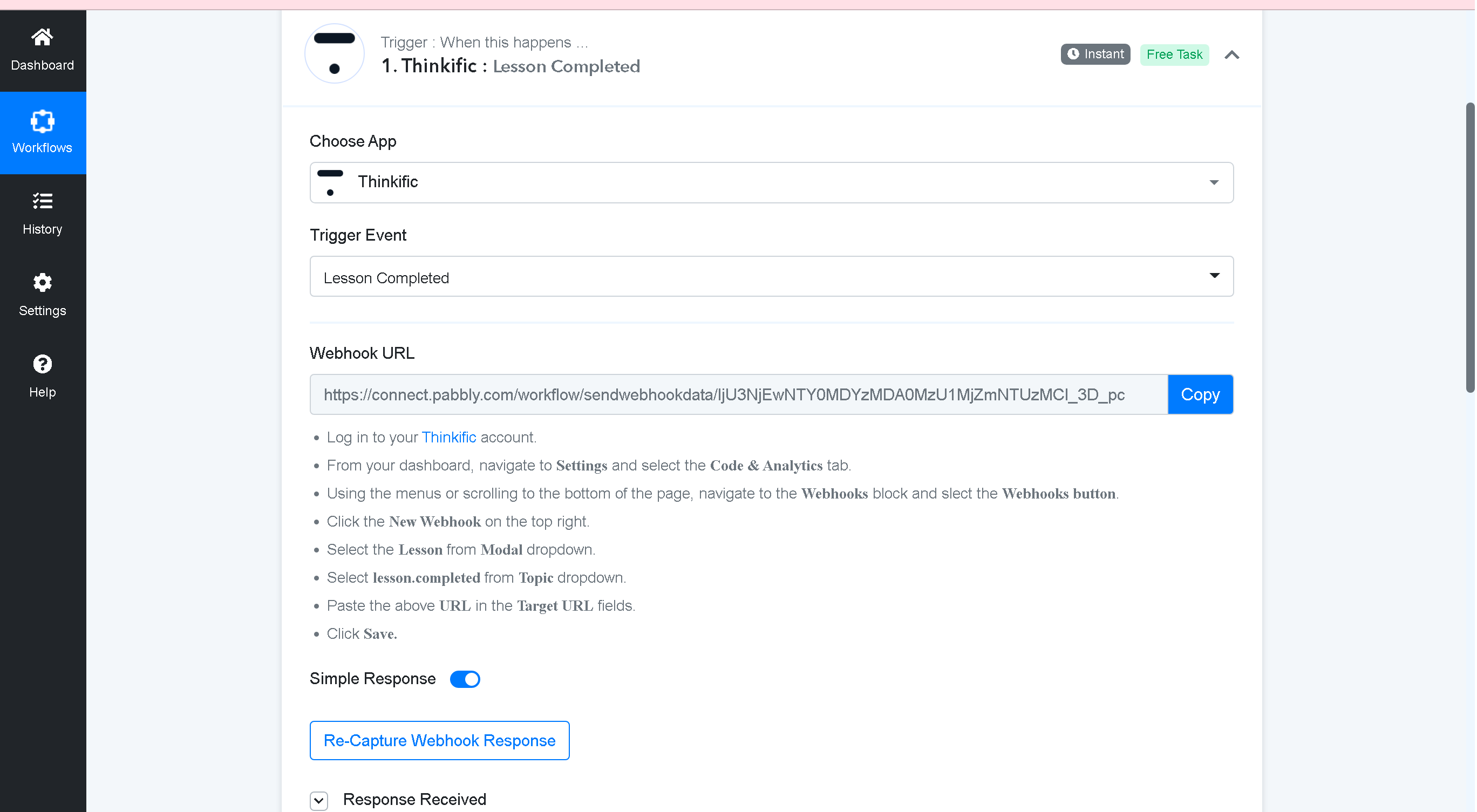

Hi there I'm having problems understanding how to set up a workflow. I currently have this workflow set up in Zapier, so just assuming that I can recreate the same workflow here as it's pretty simple.
1. When a student completes an assignment in Thinkific a draft email is sent to my Gmail.
So far I have done the following:

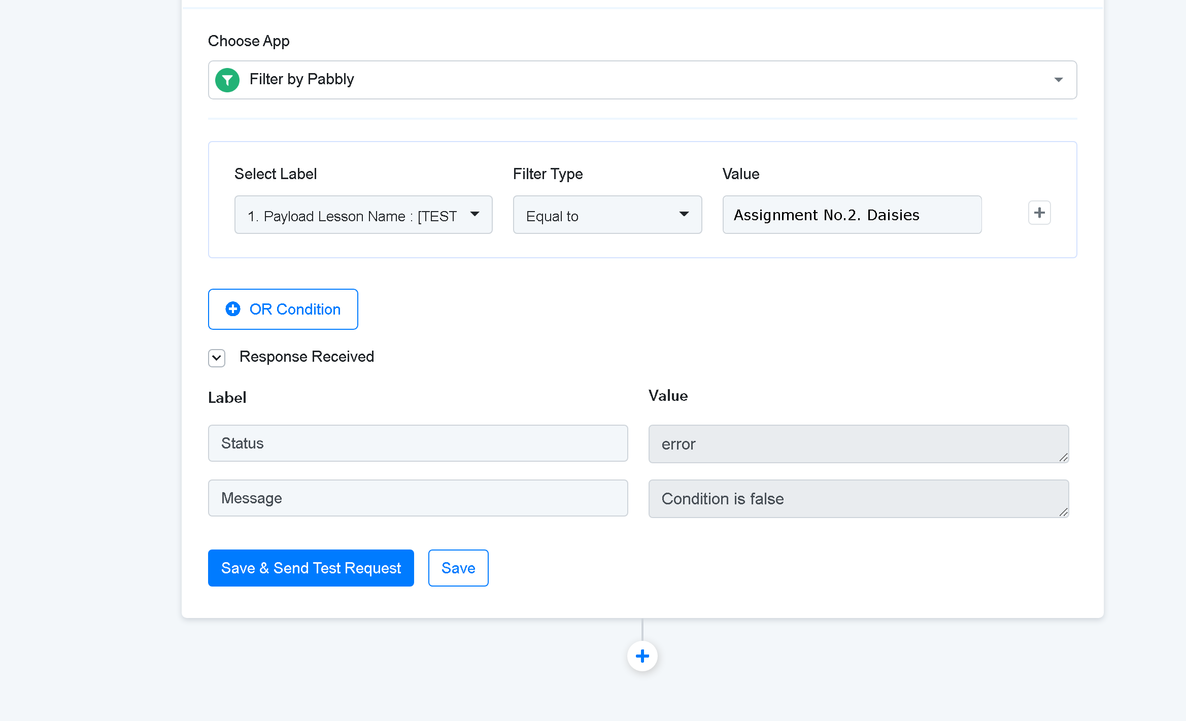

NEXT: I have added a filter. To say if the lesson name is = to. But testing just says that's an error? Can you please let me know what I am doing wrong? I thought that maybe Pabbly doesn't work on 'assignments' like Zapier and only works on 'lessons' - but I tried a lesson as well and that sends an error message too.

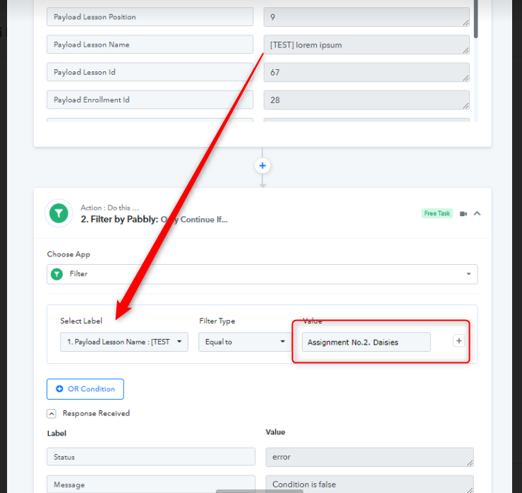

Hey @Carols
If you can see your trigger response with the lesson name and the value which you have passed in the value of the Filter action step is different.
So while setting up the workflow initially with your condition could throw a false response in the workflow.
Whereas you do not need to worry about that, if you have passed the exact name in the filter value then in the live execution of your workflow, it will run accordingly.
So, kindly give it a complete try with the workflow once and then let us know how it works.
