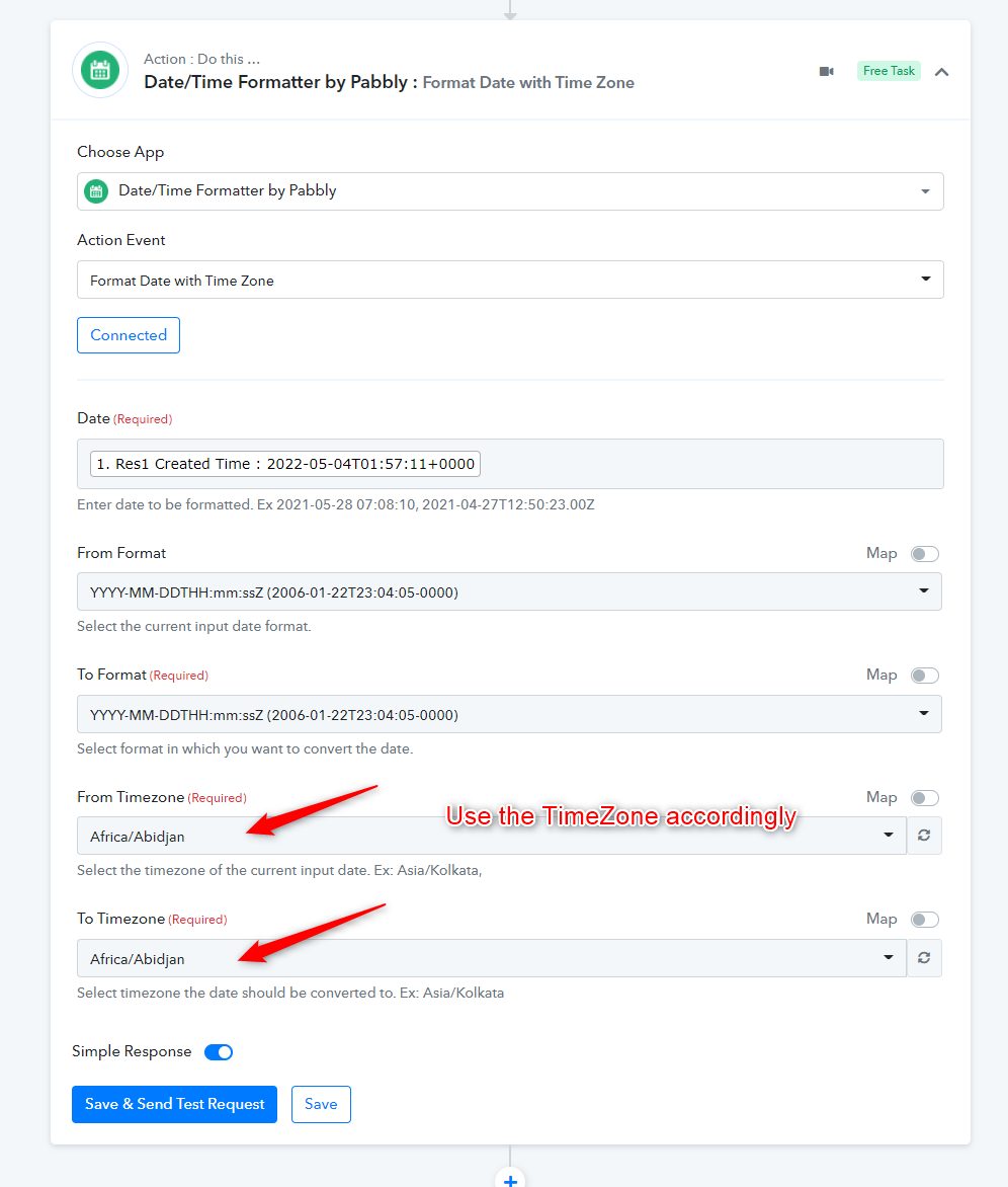

Hey @Boris Vilela
Since most of the applications process their data in UTC timezone and can use changed with the help of the "Date/Time Formatter by Pabbly: Format Date with Time Zone" action step.

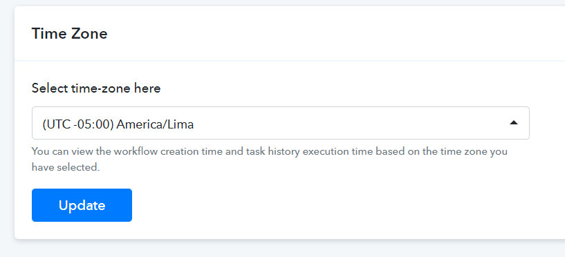

Though the Timezone which you have shown above doesn't change the timezone according to the application process, that will only associate with the internal time of your Pabbly account.
