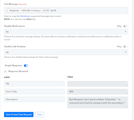

I would like to know how I can send from tradingview to telegram a reply to a message that I sent using pabbly connect
exemple first message BUY USDCAD 1.35288
second message a reply of BUY USDCAD 1.35288 saying TP hits for exemple
Thanks in advance :)

I know that but i'm looking how i can reply to a message id in telegram using pabbly connect

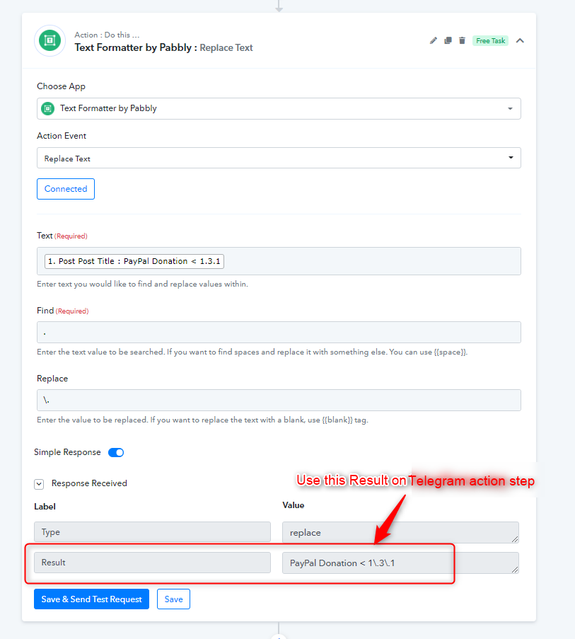

Hey @smokythepro
Due to the reserved nature of the Telegram character "." it must be escaped with the preceding "."
Here is what you can do.
In your current title. Replace all instances of the dot "." with slashdot "\."
and then use that string on your WordPress step.
You need to add a new step above the WordPress step as shown below.
