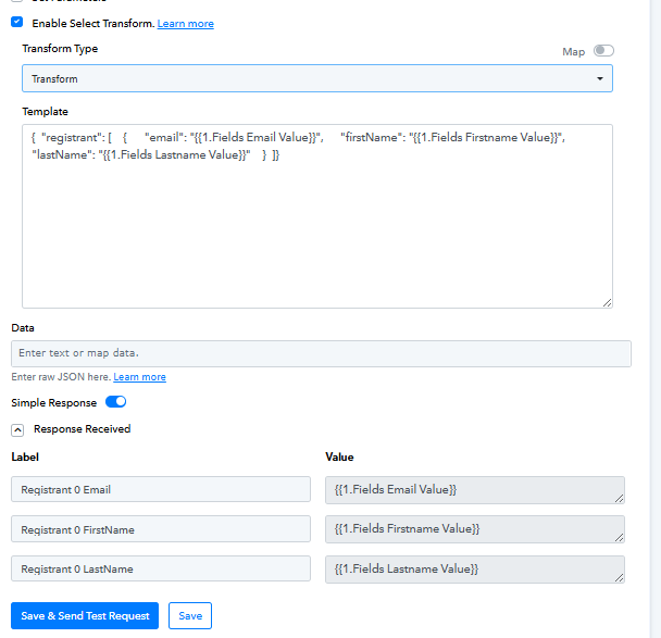

Hi Pabbly Support Team,
In Action Step 4 of my workflow (API by Pabbly), I am trying to map webhook fields inside the “Enable Select Transform” → “Transform Template” section, but the dynamic field mapping is not working.
The webhook data is being captured correctly in Step 1, however:
  • mapped fields are not appearing properly inside the transform template
  • variables are not resolving dynamically
  • the template keeps treating the mapped values as plain text
I am trying to send nested JSON data to the Zoho Webinar API using Transform mode.
Could you please help me fix this issue ASAP?
Thank you.

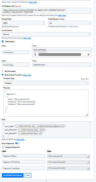

Hrishabh Tiwari — Reply ·
Hi @MATRIXFREEDOM,
I’ve reviewed your workflow again. The reason your variables are showing as plain text is that when 'Select Transform' is enabled, the Template box doesn't pull directly from your Webhook. It only pulls from the 'Data' field directly below it.
To fix this, please follow these steps:
  1. Map the Webhook Data: In the 'Data' field (below the Template), map the entire response from Step 1 or the specific fields you need.
  2. Update the Template: In your Template box, you should reference the data you just mapped. If you map the email to a key called user_email in the Data box, your template should look like this: "email": "{{this.user_email}}".
  3. Check the Docs: For a deeper understanding of how to structure these transformations, please refer to our official guides:
The 'Transform' feature is powerful for complex data reshaping, but for a standard Zoho Webinar registration, the standard JSON Payload is much simpler to manage!
Hrishabh
Hi @MATRIXFREEDOM,
I’ve taken a deep look at your workflow, and while we can simplify the JSON mapping, there is a major stability issue in Step 3 (your Token Generation step).
The Problem: You are using a one-time authorization_code. Zoho tokens expire every hour, so your workflow will break constantly. Since Zoho Webinar is not yet a native app in Pabbly Connect, building a manual API connection is complex and prone to these errors.
The Solution: Use Pabbly Action Builder Instead of struggling with manual API steps and unstable tokens, you can use our Action Builder to create a custom Zoho Webinar app for your account.
  1. AI-Powered Setup: You can simply describe the Zoho Webinar API to the AI, and it will generate the code and handle the authentication logic for you.
  2. Stability: It creates a dedicated 'Action' that you can use just like any other native Pabbly app, making it much more stable than a manual API request.
  3. Simpler Mapping: Once built, you won't need to write any JSON in your workflow; you'll get a simple form with fields for Email, First Name, and Last Name.
Check out the guide here to get started: Pabbly Action Builder - Guide for Creating Custom Action Step APIs
If you'd like to stick with your current API step for now, please uncheck 'Enable Select Transform' and use the JSON Payload method as mentioned previously.
Hrishabh
