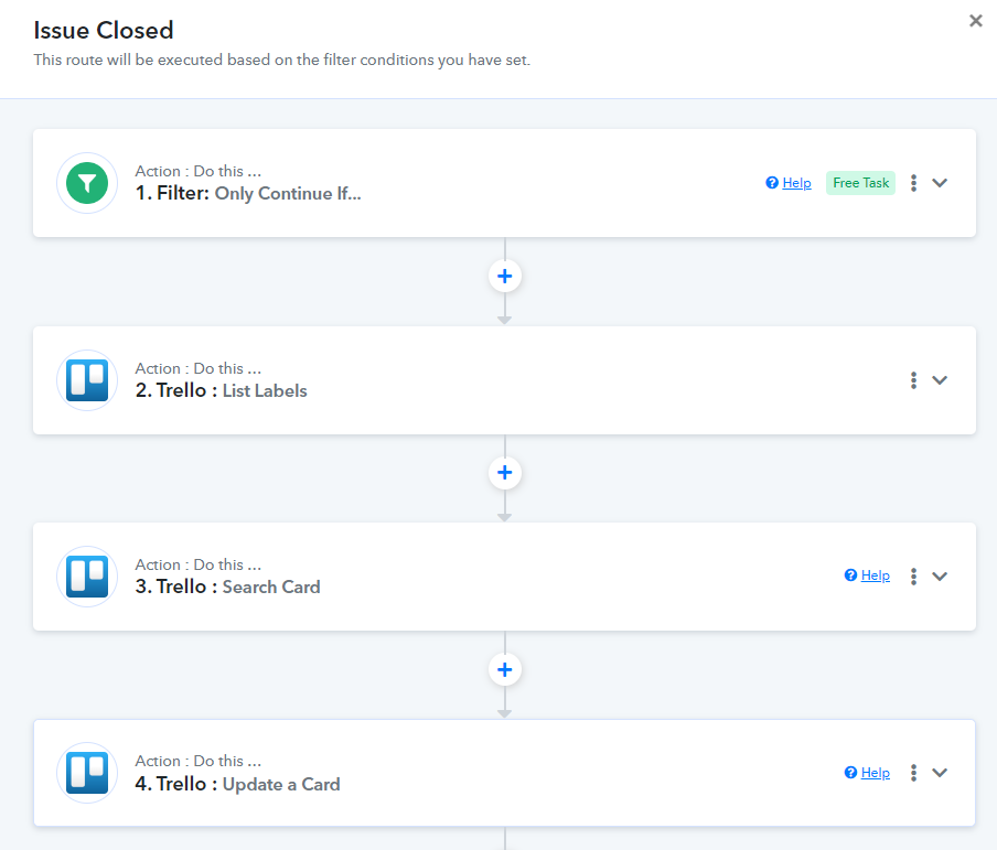

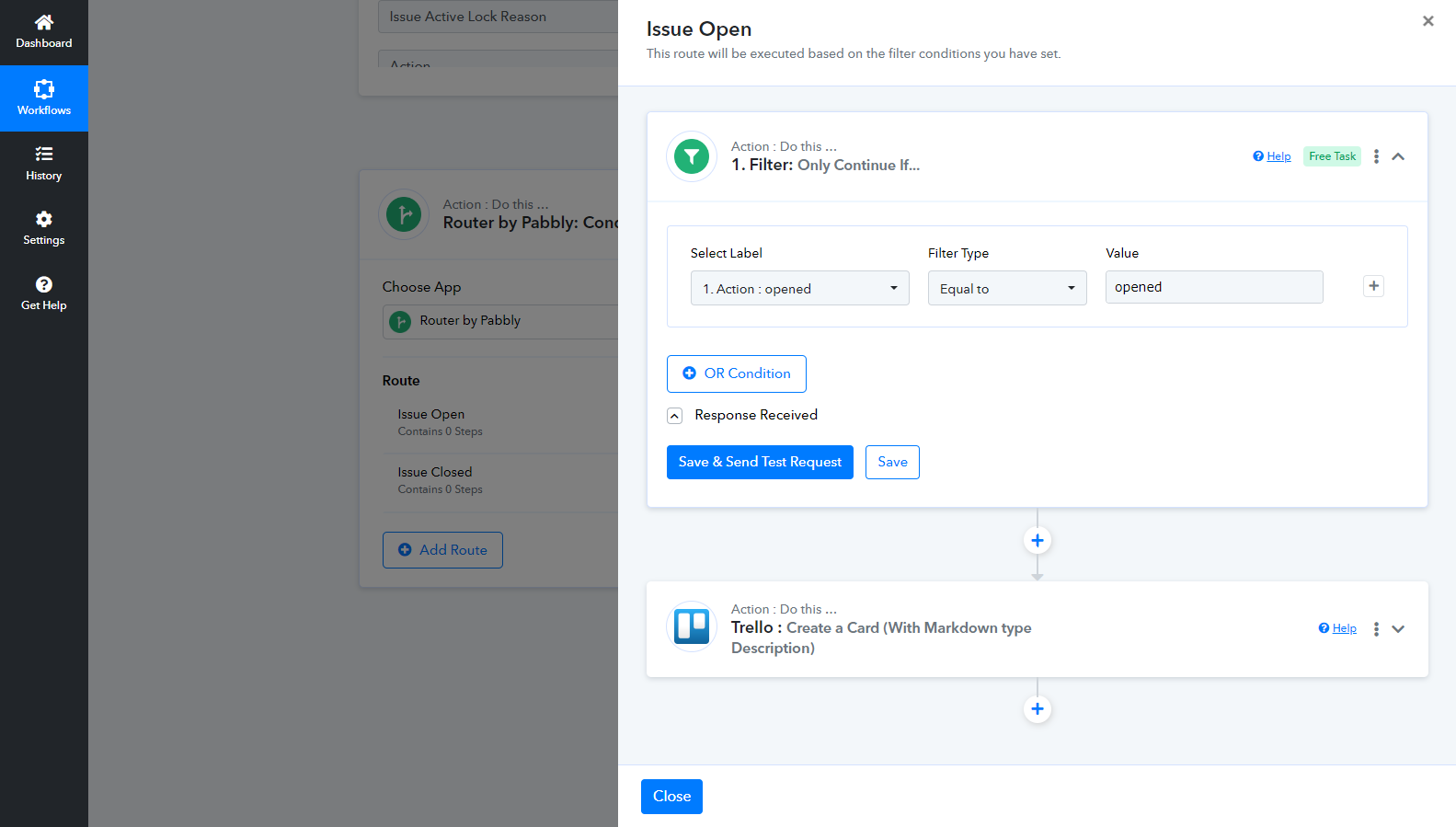

Yes, you can do so by adding a Router to your workflow. After setting up Github: Issues as your trigger, simply add a Router to your workflow for both cases - when the issue is open and when it's closed.
I have attached screenshots that describe how you can set up the Router. Please feel free to ask if you face any issues during the setup process.

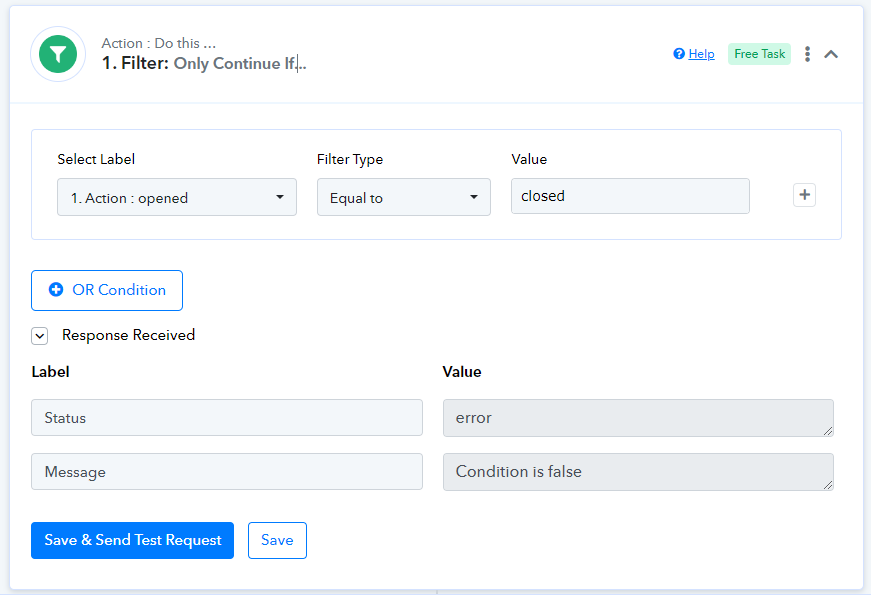

1. Issue Open
2. Issue Closed
Expanded View:
  • Issue Closed - Filter

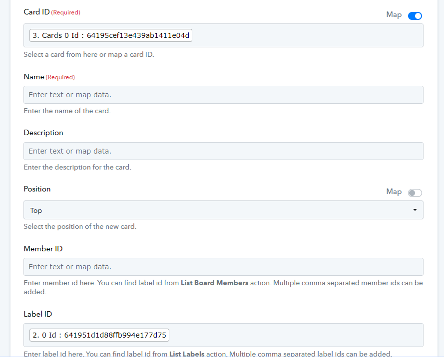

  • Update a Card - Make sure you map the Card ID and Label ID from above
