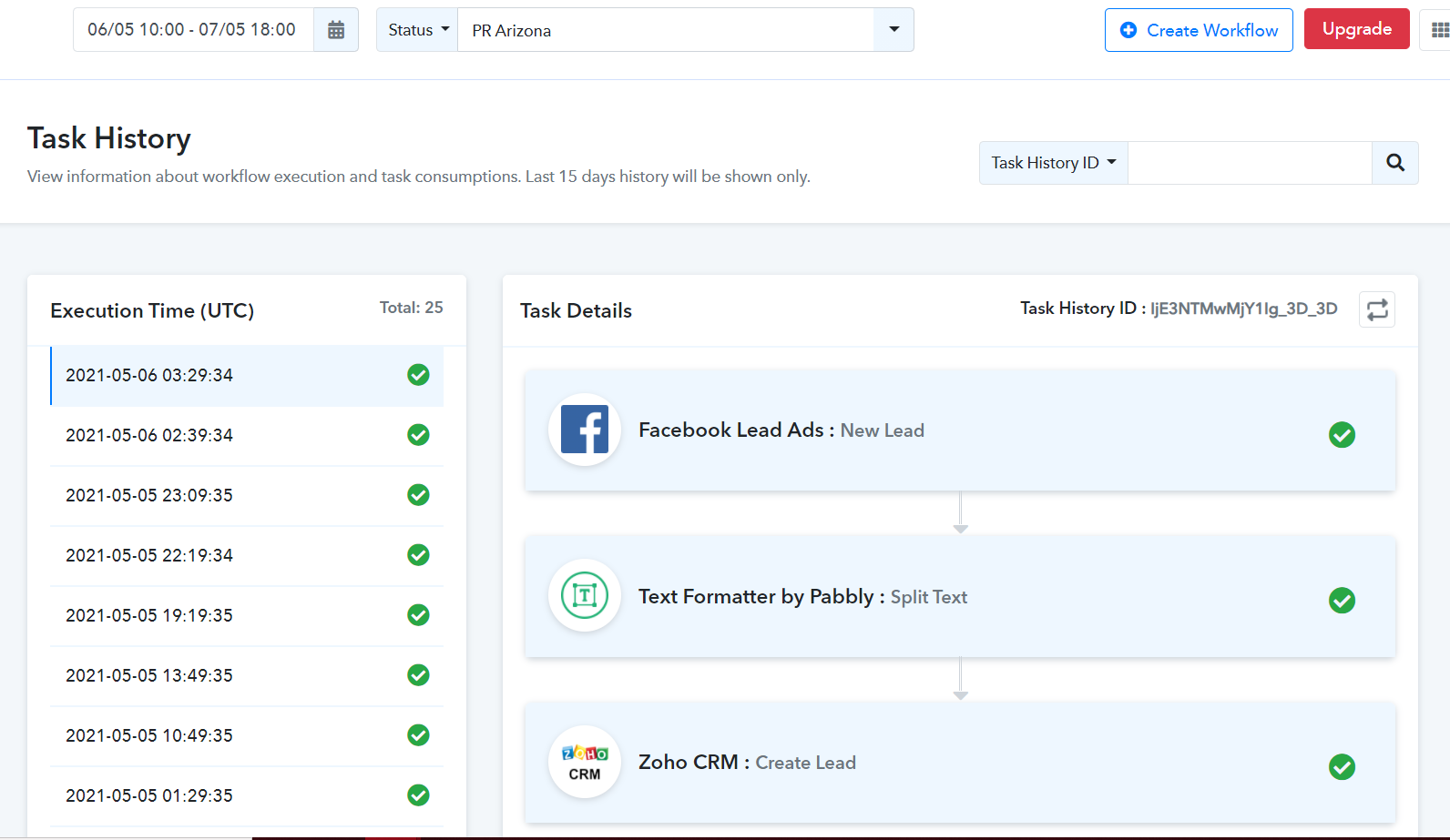

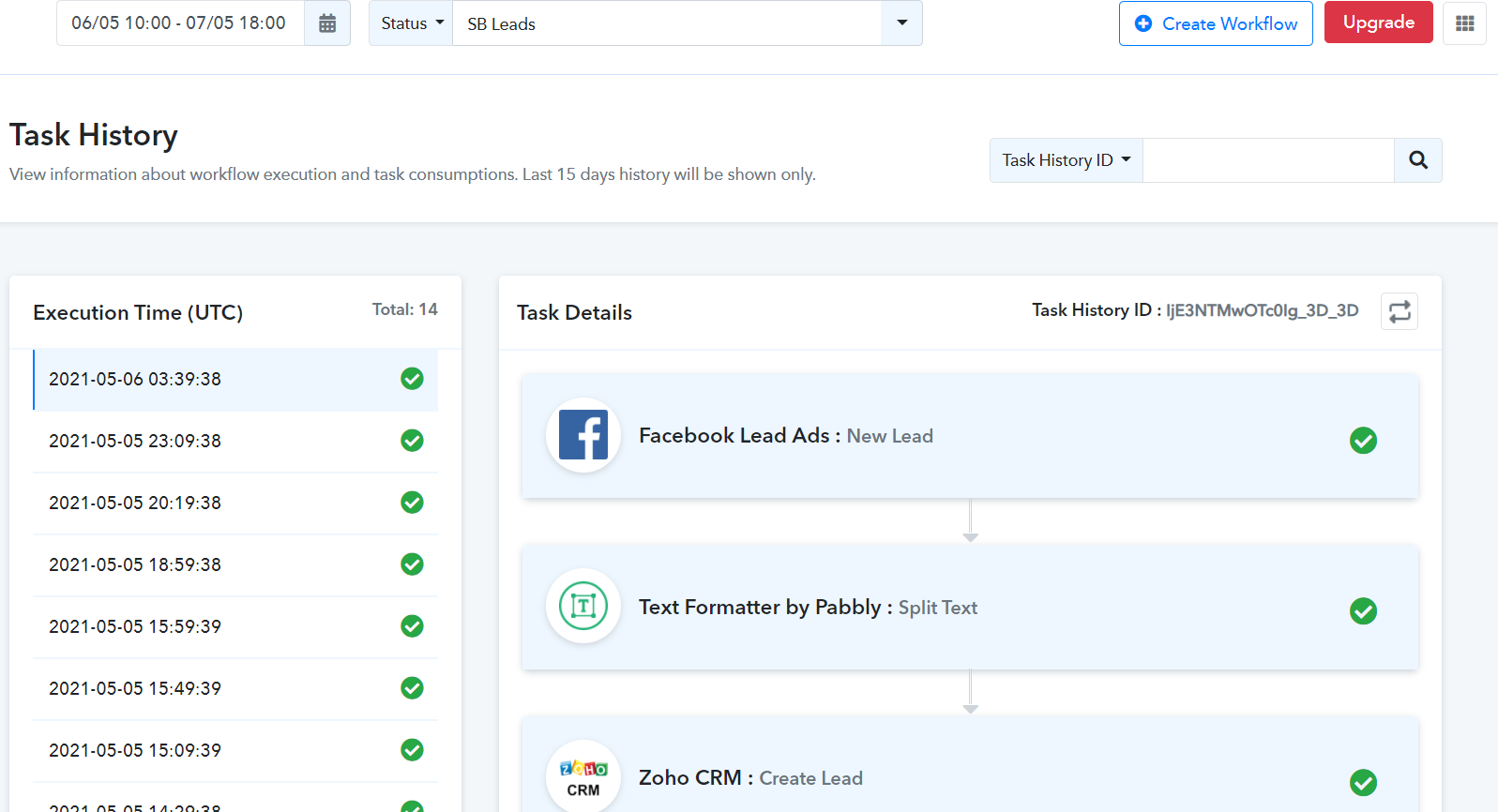

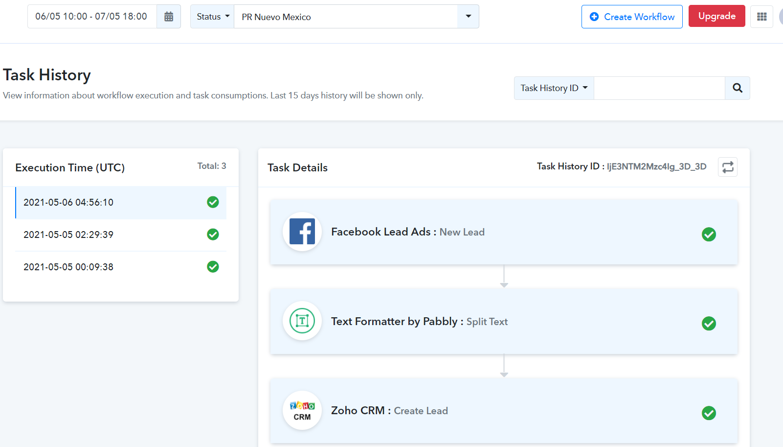

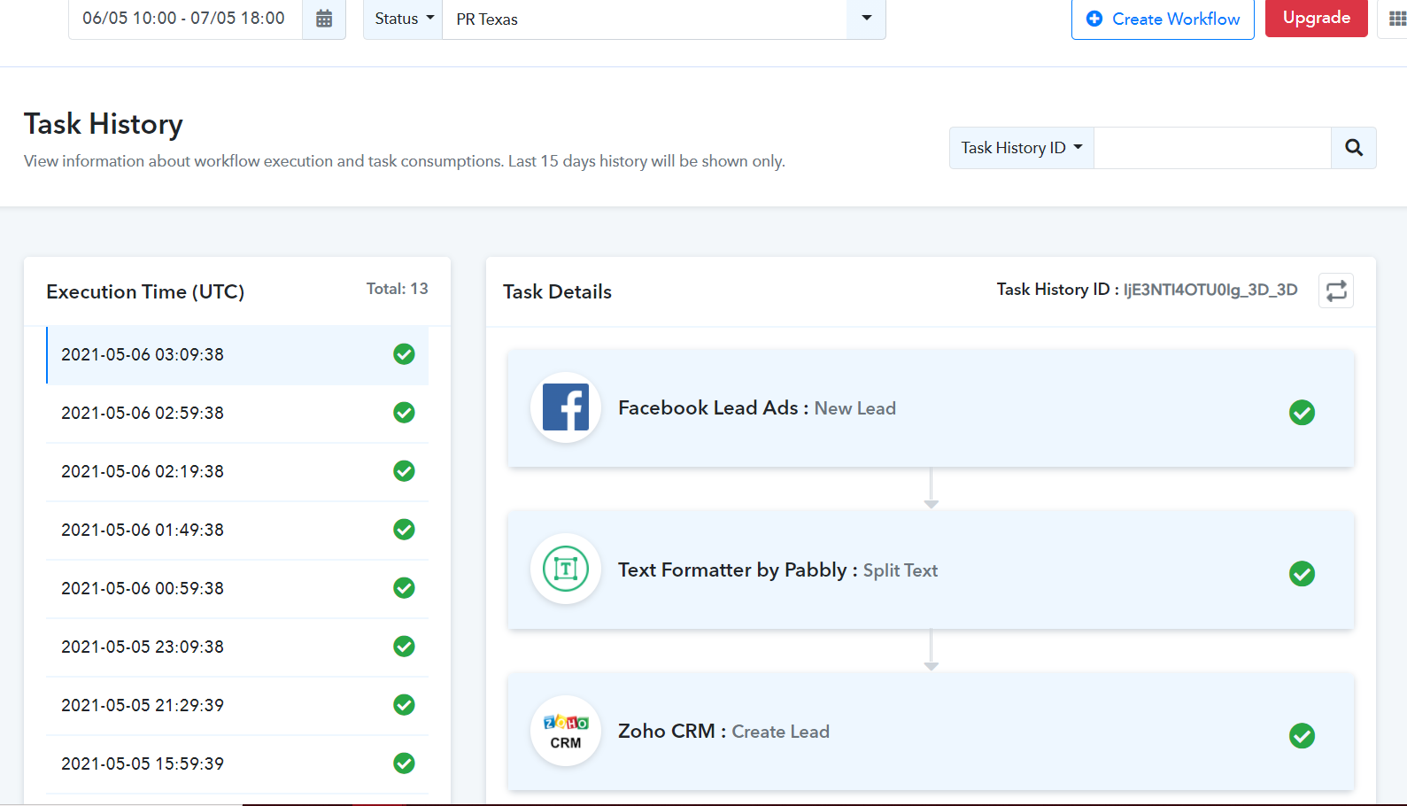

As we checked all 4 workflows and their history logs respectively, seems everything is working fine.
SB leads-
PR Nueovo Mexio-
PR Texas-
PR Arizona -
If you are still facing any other issue regarding your Pabbly Connect's workflow, please elaborate with a short video or with a screenshot.

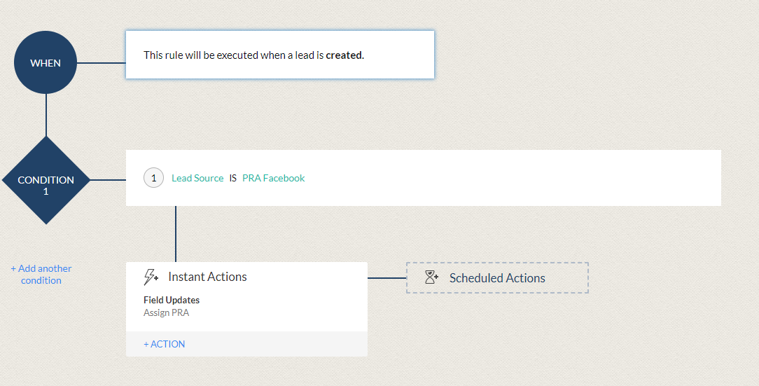

1.- I created a workflow in Zoho crm called Assign PRA leads. This workflow says "Every time a lead is created with Lead source = PRA Facebook, assign that lead to user X on the crm"
2.- PRA Facebook is the value that I gave to the Lead source field on my pabbly workflow. (This is the PR Arizona workflow)
3.- If I create a lead manually in Zoho crm with "Lead source = PRA Facebook" the Assign PRA leads workflow on Zoho works perfectly.
4.- Every time a lead is created by pabbly in Zoho crm with "Lead source = PRA Facebook" the Assign PRA leads workflow on Zoho does not work.

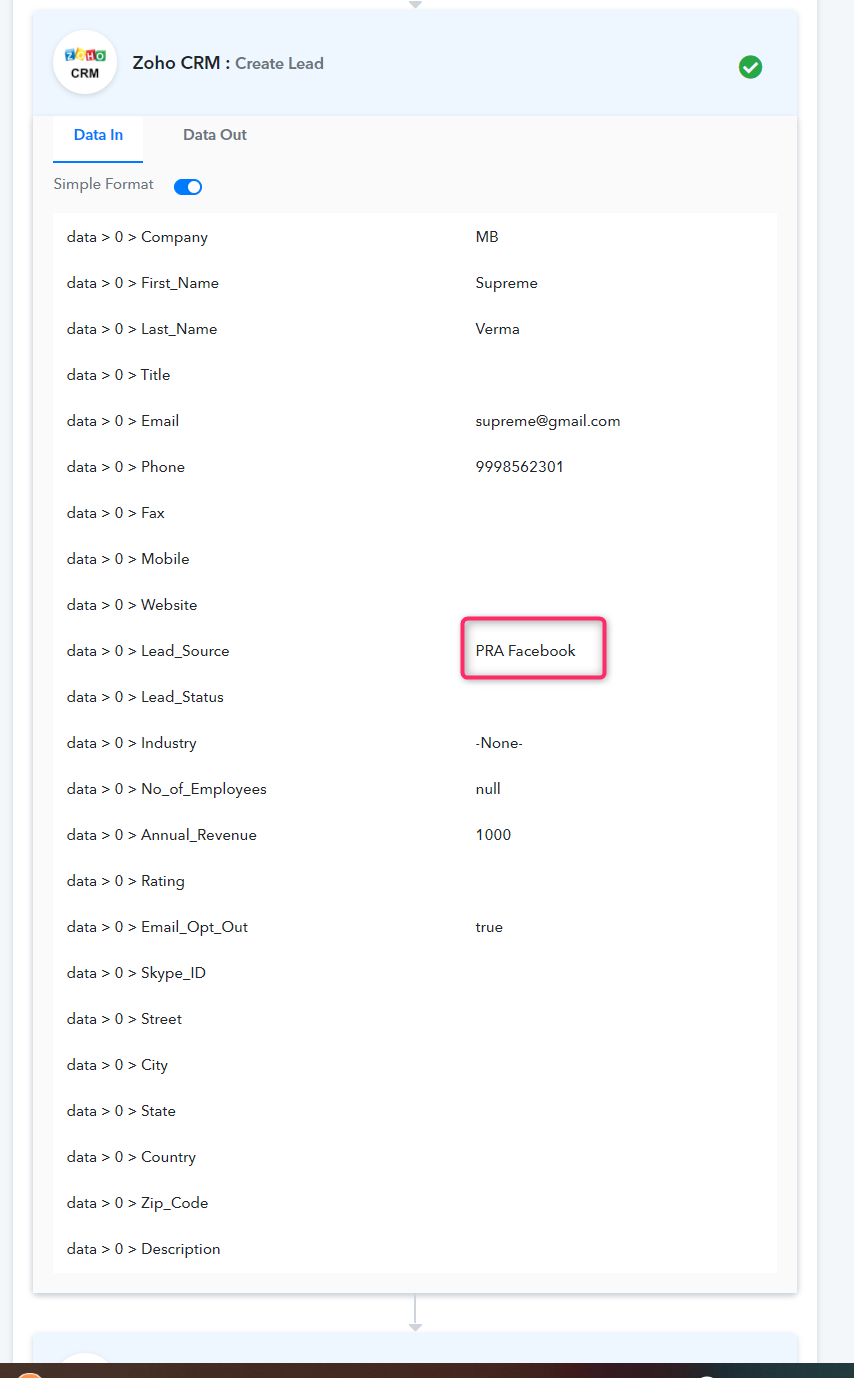

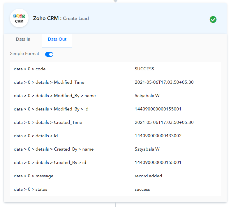

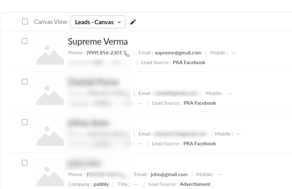

We have checked the issue and tried the workflow in a similar manner at our end.
And it is working as the Lead source is being manually typed and the lead is created in our ZOHO CRM.
**Though in Data Out the Lead Source wouldn't be visible.
In our ZOHO CRM -
So the workflow seems fine and the leads are also generating, please check the leads in your CRM.

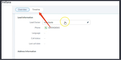

We have contacted the Zoho Team regarding your issue. They asked us to ask the customer to record the timeline as per the below screenshot and let us know how the owner was updated (Detailed short video).
Kindly send us a short video for the same so that we forward it to the Zoho CRM team.

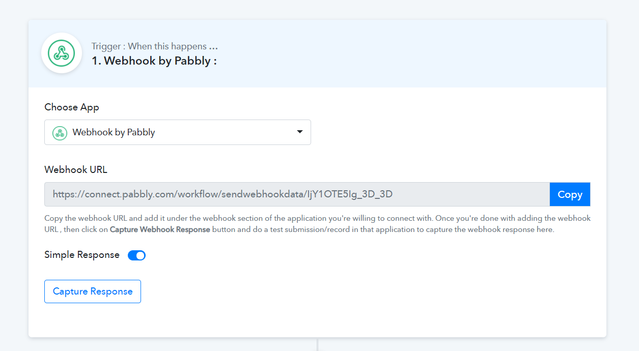

And here is the history id of the pabbly workflow so you guys can check that the "Trigger workflow" option was turned on.
IjE3ODY0MzYxIg_3D_3D
