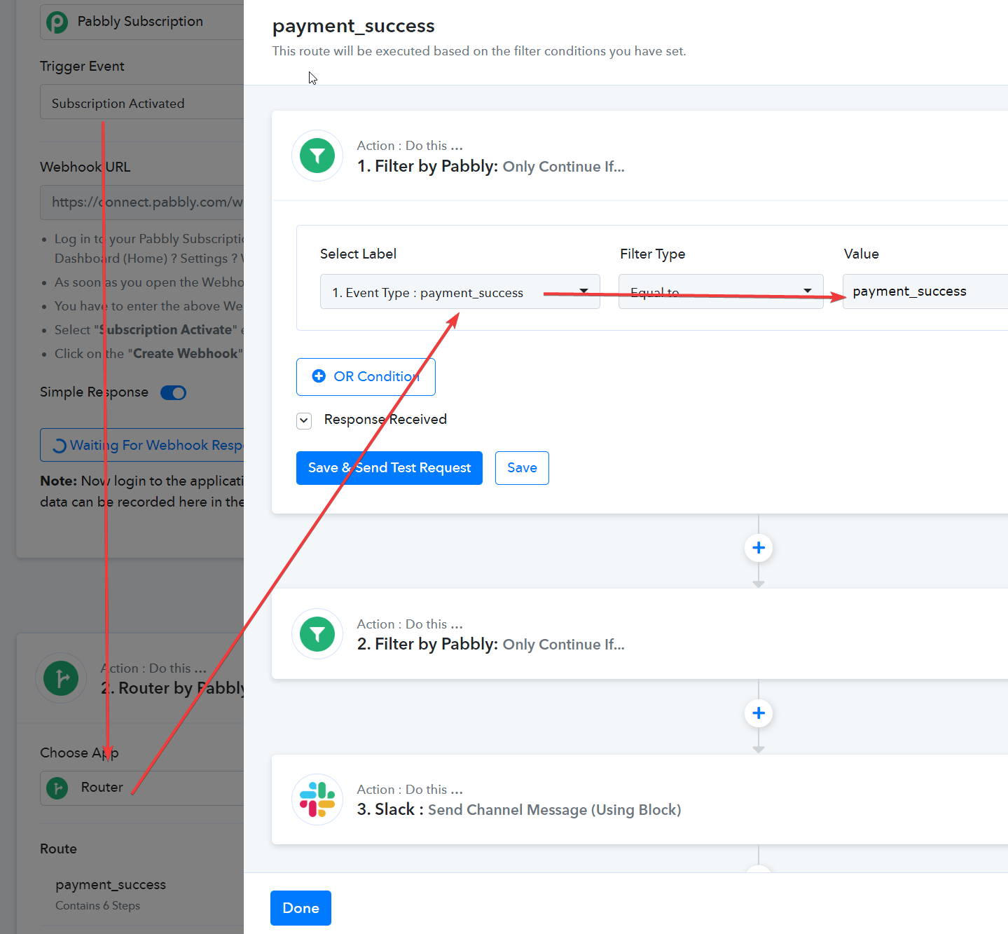

I use Pabbly Subscription to collect subscription payments.
And use Connect to setup a workflow to add new clients to CRM, Google Sheet, update slack channel, etc.
I used to use "event type: new_subscription" so it would only trigger if it's a brand new client, but then it also triggers when they tried to sign up but payment failed (due bank denials).
Now I currently use "event type: payment_success", but then it also triggers the workflow from renewing clients on month 2 and onwards....
I tried to use "data subscription renewal" < 0 to filter the new clients, but that event doesn't always show, so eventually, the workflow stops at the filter and didn't continue even when it was a new client.
Sorry, it was "data subscription renew count" less than 0.

If I used a router, do I put "subscription_activated" in the value here?
Nevermind - I've adjusted the webhook options to only allow subscription_activate to happen. This should do the job.
