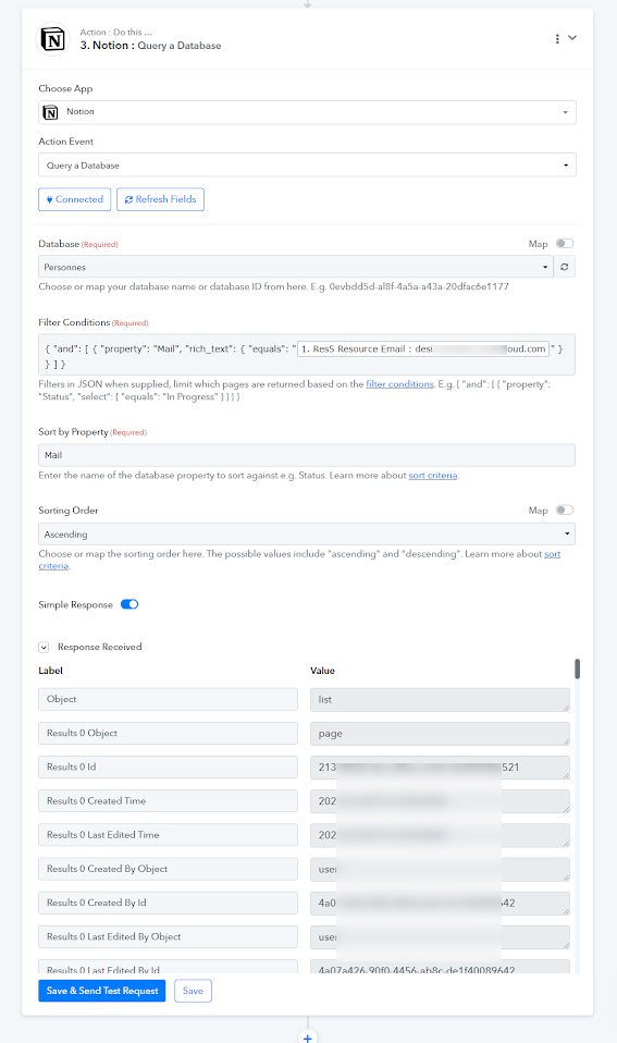

I want to use Pabbly to add Contacts to a Notion Database (and a Mailerlite group, but this part is working), or update the contact details if it already exists.
The trouble is how to correctly filter that...

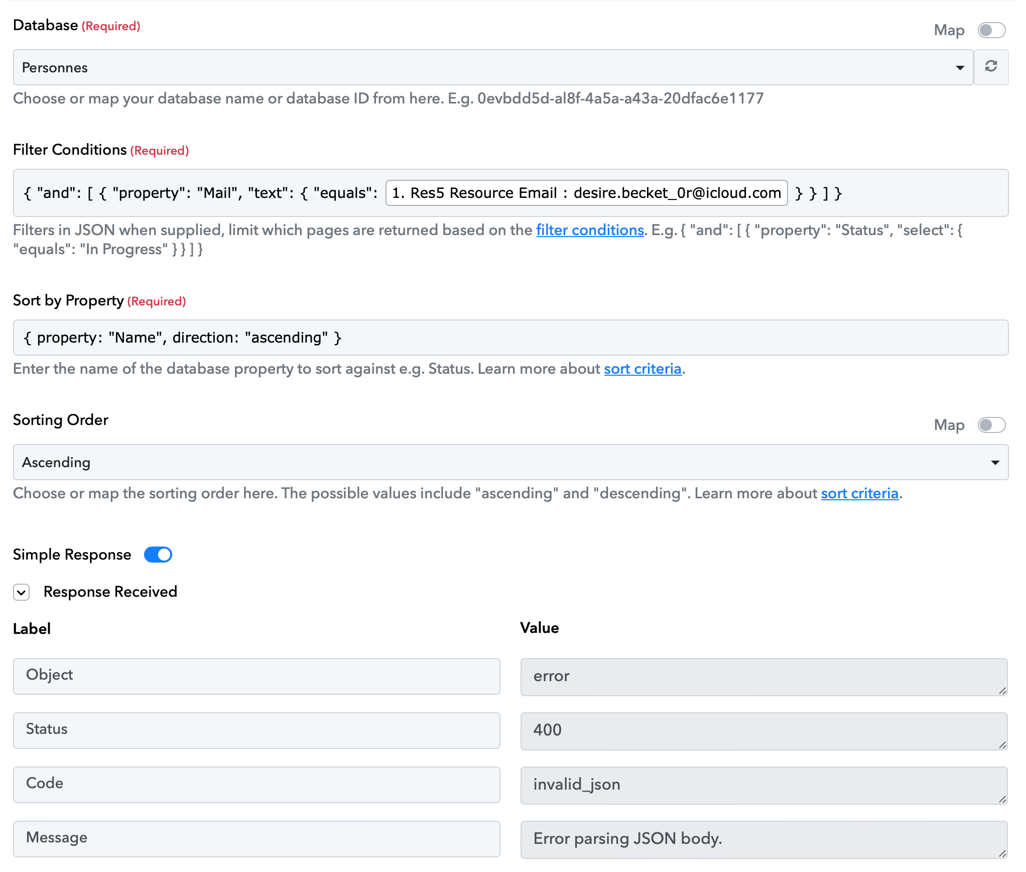

I've tried different ways but they don't work : with a Query, it seems that my filters don't work, I've got an error even if I checked the syntax...
I've found a post with a similar problem but I don't find the "search date base item" action for Notion, like I saw it that post so...
I just want to check if the mail of my person exists in the database, and update or create the database item, depending on that.
Can anyone help ?
Thank you ;)

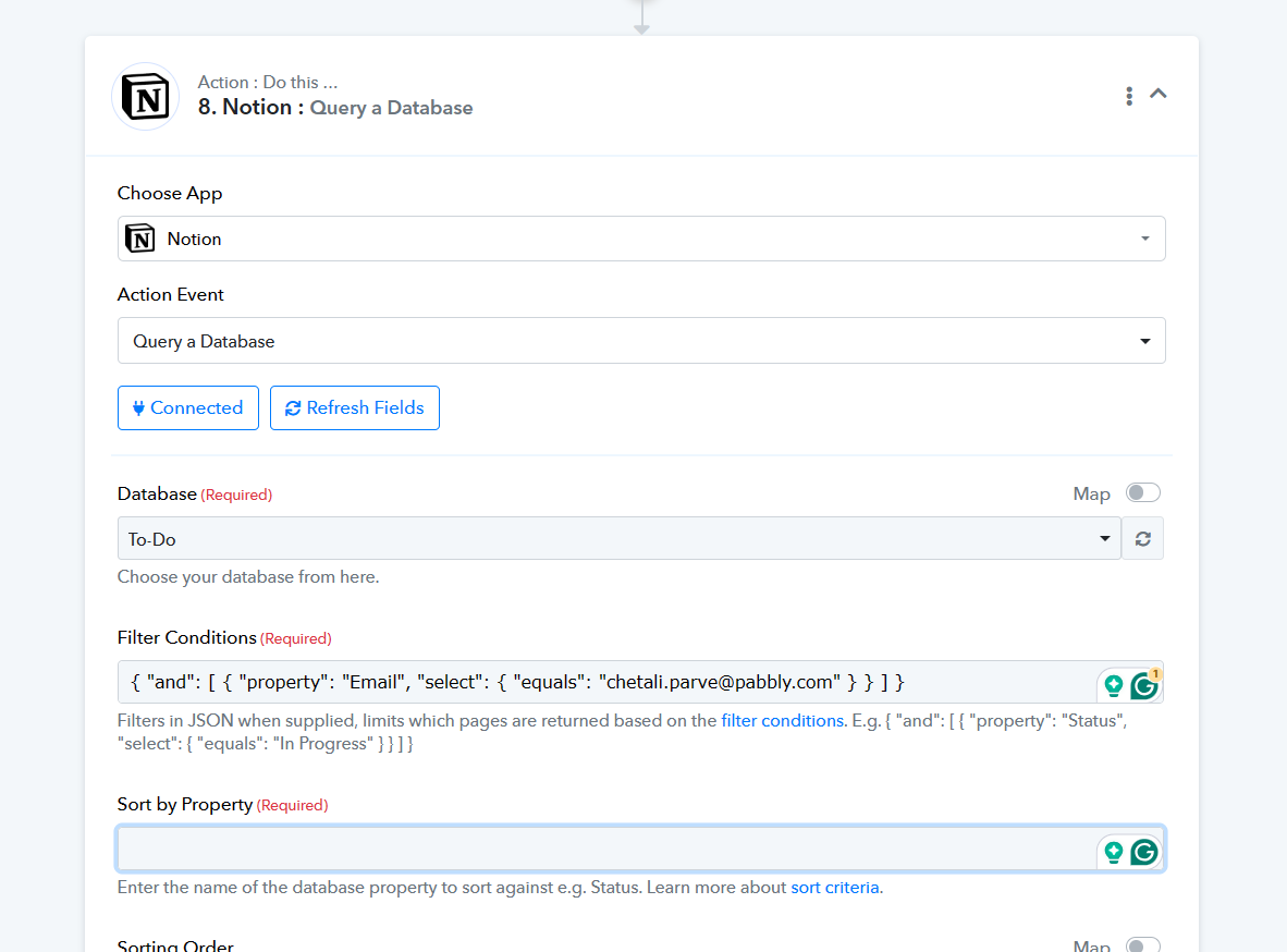

Hey @Mathilde
Could you kindly share the URL of the workflow where you attempted this so that we can investigate further?
You can also refer to the screenshot below to verify the presence of the email address in your database.

Hello @Supreme,
Thank you and yes, here it is : https://connect.pabbly.com/workflow/share/XBRZa1QDAmFfFVI4UwAFIgAUAQUHXgVlABkGFFxTVS1SHwVuUBEOZApGAiBWEQZnVx5QOlENATlaTgcDAlQBcldZUkBcXwZ8Uh9WLQNgWGtcAllxVDU#
The syntax wasn't ok, I've corrected it but it's not enough : maybe it's difficult because my mail is a variable ... I need to check if the new contact already exists, and of course, the mail will change for every contact.
I've checked with a fixed email that is present in my database, it gives the same result.
Do I need to have a select property for this automation to work ? Initially it was a mail property, I've seen they're not supported, so I changed my property to text property. Select... would be strange, a choice field with a different value for each line...
Here is the screen capture.
Thank you very much !
Please check now, we have corrected the syntax and the query is now passing correctly.
