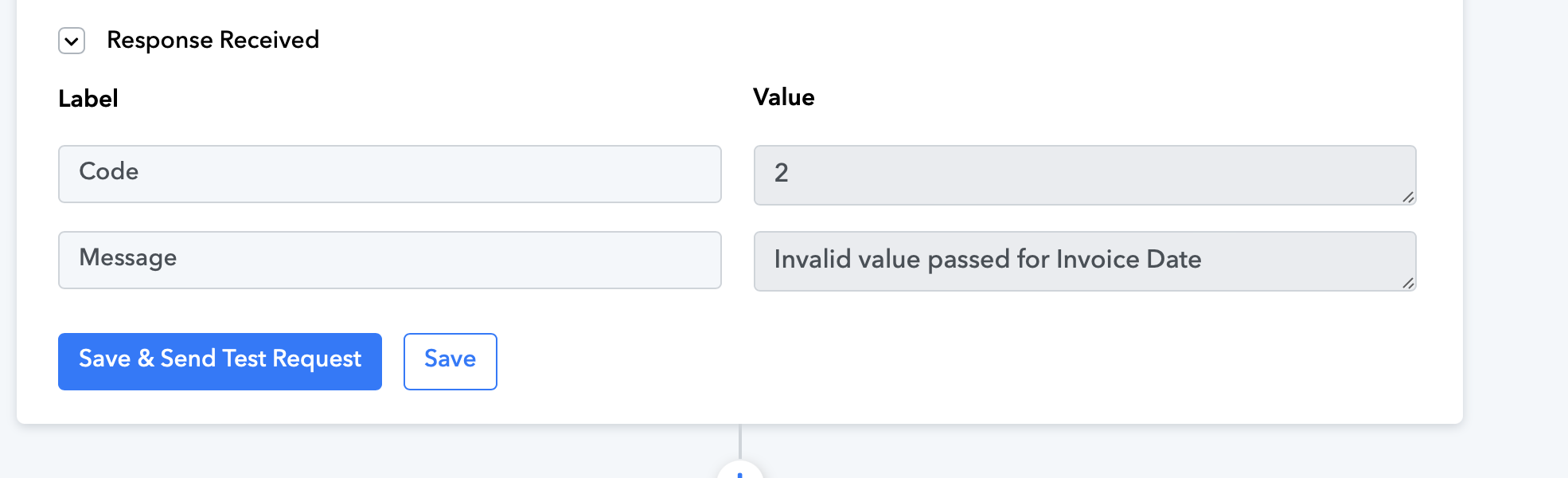

I successfully connected woocommerce and mapped every field to ZohoBooks workflow. But when I tried to run it, it gave an error - Invalid Value passed for Invoice Date.

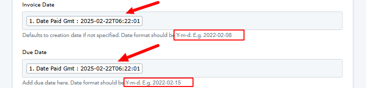

What I noticed is that woo sends date as this - 2025-02-22T06:21:14. This has time attached to it. While Zoho expects a Y-m-d. E.g. 2022-02-08 format.

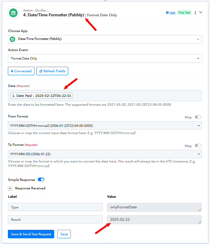

Upon checking, we noticed that in the Create Invoice action step, the Invoice Date and Due Date are entered in a different format than the required one. To ensure the correct format, please use the Date/Time Formatter action to convert the date accordingly.
Refer to the attached image for more details. Also, please ensure that the data mapped under these fields follows the format described in the help text to avoid such issues.

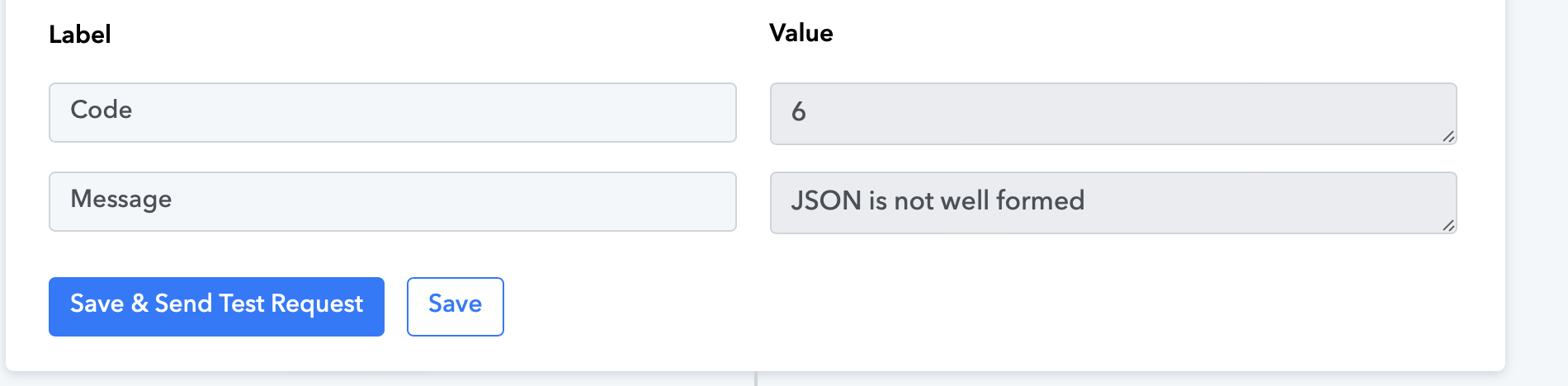

Hi Thank you.
I did as suggested. But I am getting another error now.

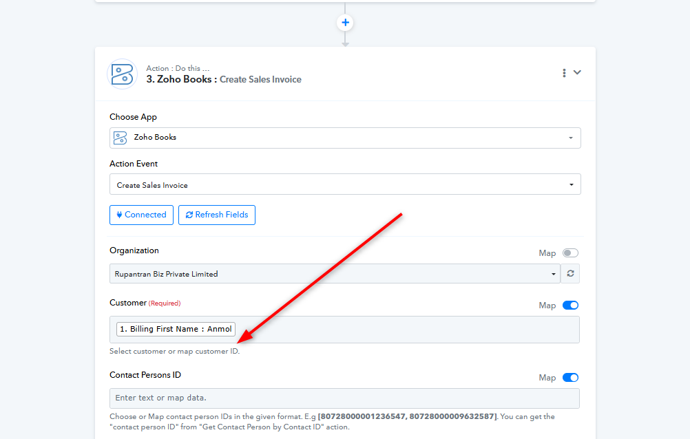

I think it's because of the contact person ID field. I checked the forum a bit but didn't understand what to add in contact person ID field as every new bill will have new customer.

You will have to enter the Customer ID instead of Customer Name in this field -
Also, the user should be created inside Zoho Books in order to create an invoice for that customer. Please refer to this video tutorial for the same.
