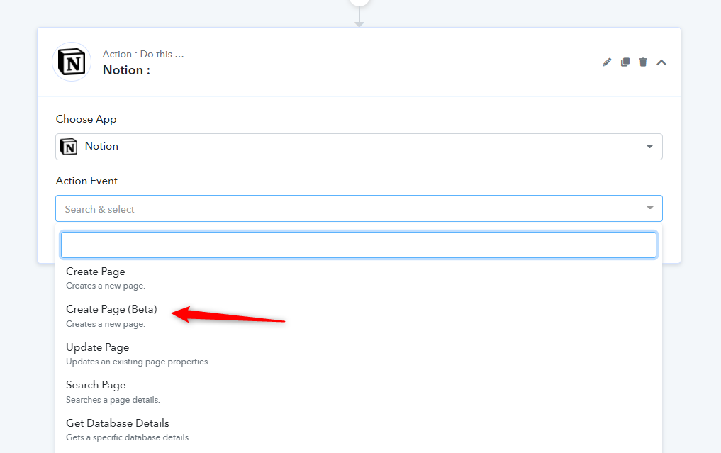

Basically I am unable to add pick up new tables to an existing Notion integration in Pabbly.
We are looking into this and will update you in a while.
We have created a separate endpoint "Create Page (Beta)". Please test it out and let us know if that works for you.
That worked. However "Update Page" is still not showing the new table.

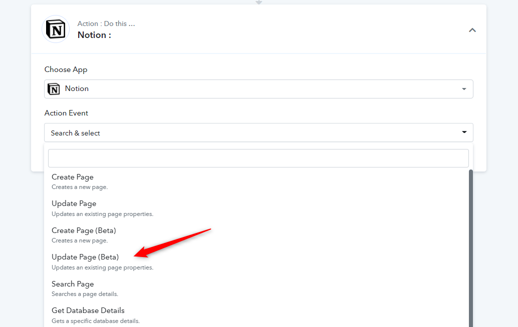

Use the above "Update Page (Beta)" for that and let us know if there is any update required.
I used the update page beta and it pulls in the correct table, but it doesn't actually do anything

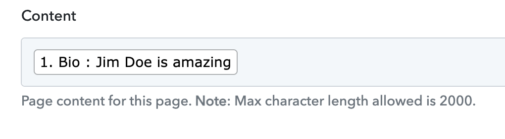

I notice that the "content" field in Notion still doesn't populate.
Can that be fixed?
OK, I figured it out. It wasn't accepting the date format even though no error message was given. So I just had to change the date format.
Can that be fixed?
Yes, there seems to be some issue. We're looking into this and will update you.
Thanks! Let me know if you have any updates!
We have gone through the Notion API and seems that they are not providing any endpoint for updating the content. So as of now, we are planning to remove the content field.

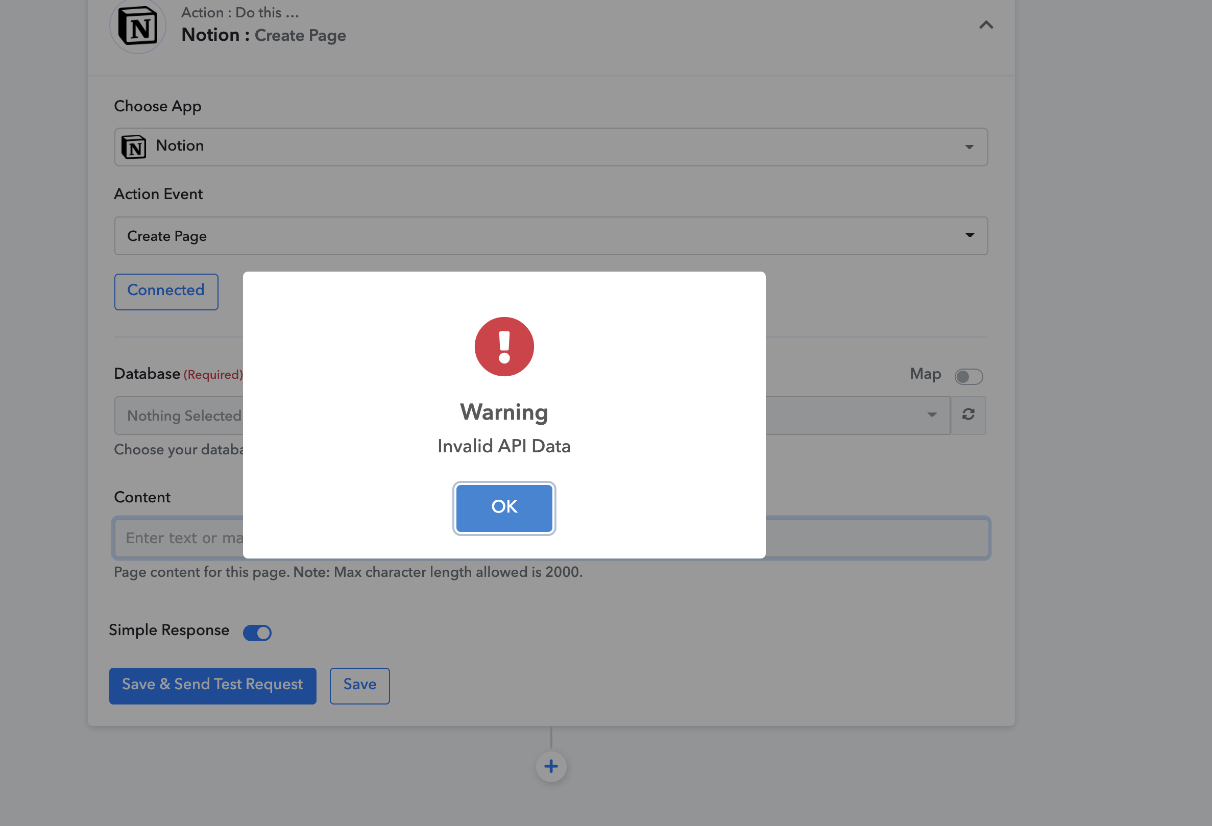

I am having similar issue with Notion except after successfully copy and pasting the token no databases show and when I click on the refresh i receive this error.
Hey @amigira
It seems like you might not have configured your Notion account correctly. Kindly pass the correct credentials of your account.
