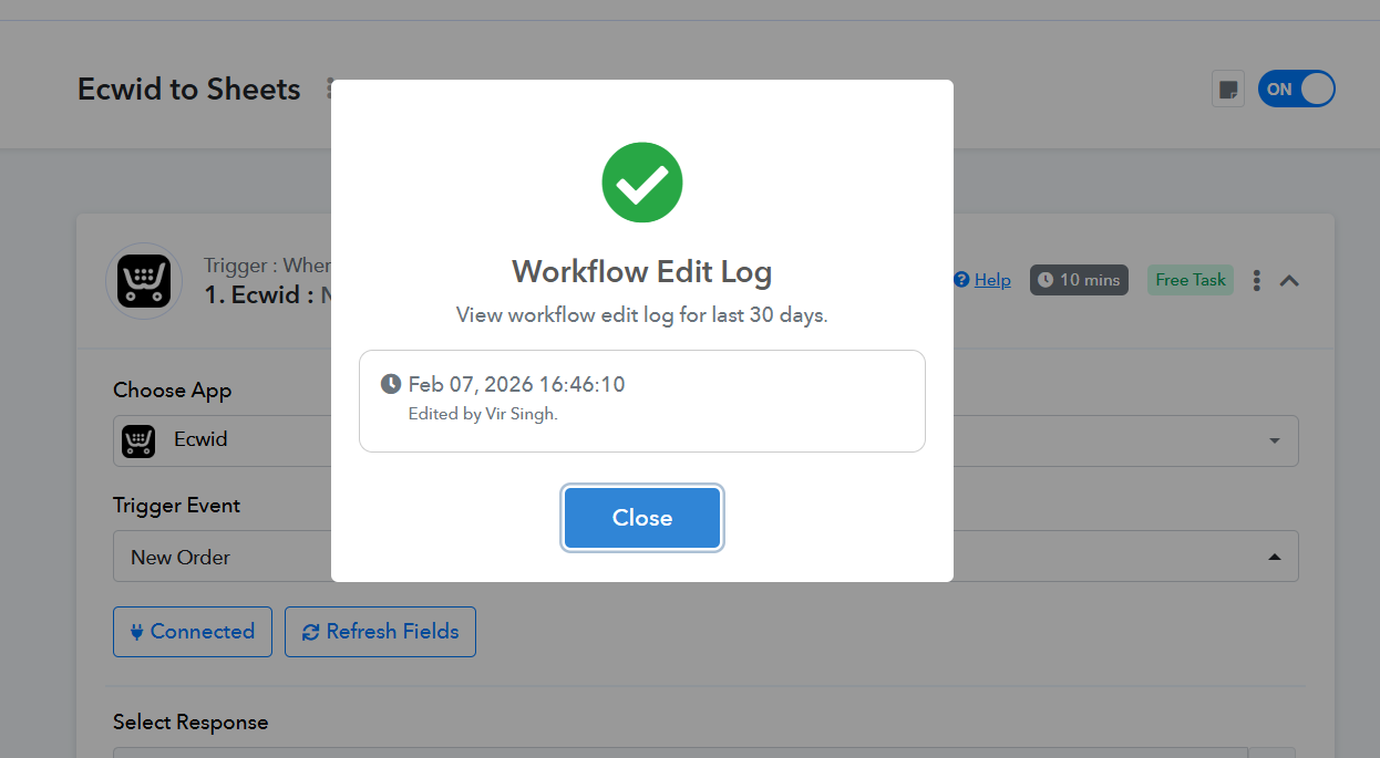

Thanks. But why did my workflow not re-execute automatically since i have set it for aut re-excecution?
It looks like you made some changes to your workflow after the task was executed, which is why we’re unable to determine the exact cause of the issue. You also appear to have re-executed the task manually. If you encounter the error again and the workflow does not re-execute automatically, do let us know.

Hi, actually because the workflow didn't re-execute automatically, I had to manually re-execute it. In case you have the timestamps for when it failed and when I manually re-executed it you can tell that it did not re-execute automatically
We did notice that the task was re-executed manually. Please monitor your workflow for some time, and if the re-execution doesn’t work, do let us know—without manually re-executing the task. This will help us diagnose the issue.
