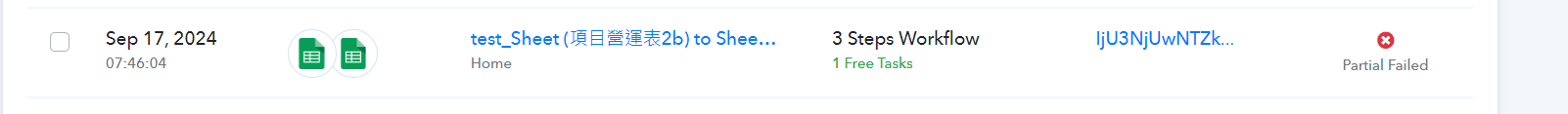

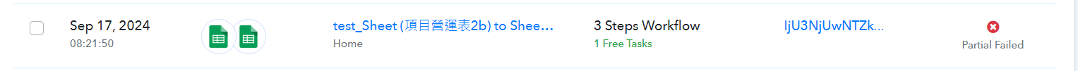

My current workflow:
new or updated row of google sheet -> create new sheet on another spreadsheet -> update cel value for new sheet with source sheet value
My workflow history shows partial failure.
The error message is "Required field Value missing.".
However, I have filled up all values. It seems to me that Pabbly hasn't updated the workflow. The test goes fine, but after that, it doesn't update the value.

I have changed the content of my thread.
Now the trigger cell is not a formula, so it's fine with the original setting.
The new issue is fail to update cell value. Please refer to my workflow ID. You may find the failed workflow history.
Hello @lelehelloworld
You are receiving a partial failure because a sheet with the same name captured from the trigger step already exists. This leads to a different response format, causing the update step to receive empty fields.
