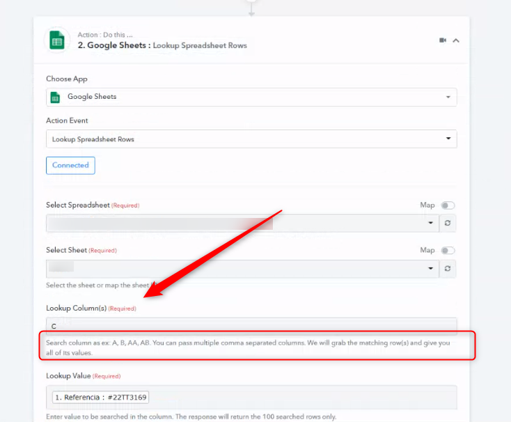

Hey @dgg
As we can see from your workflow for your concern, you need to pass the column name from your Google Sheets instead of data to retrieve the corresponding row.
Kindly try your "Lookup Spreadsheet Rows" action step again as mentioned in the help text and let us know if you face any further issues.
dgg — Reply ·
I'm afraid it doesn't work. I'm lost here.

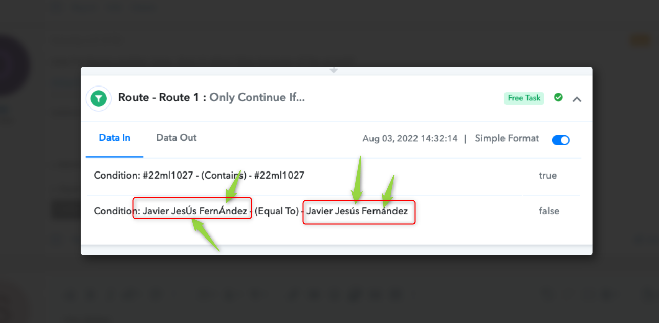

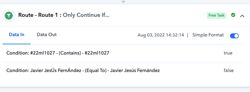

dgg — Reply ·
now I'm facing another issue. does it return false because of the accent?

Hey @dgg
The value which you are facing contains a different character in the value and because of that, the filter got a false response.
