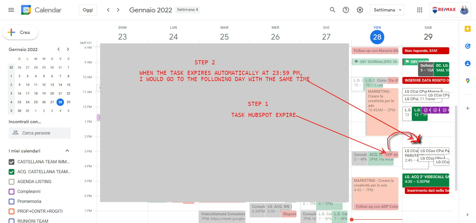

hi everyone does anyone know how to move the events created by hubspot through the tasks that have expired, that move automatically the next day at the same time and that the task in hubspot is also updated
sorry for my English
as you can see I have some tasks that have expired but if I move them unfortunately the task in the hub spot management software is not updated
I would like there to be an automation that at 11:59 pm will automatically switch to the next day and I want that if I had to move it manually they also move in the management system thanks I would be very grateful

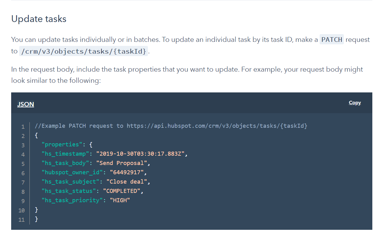

We looked into your video and it seems like you are trying to update the tasks with the help of the "Update Contact" action event which is not possible.
Moreover, if you want to update the task in your Hubspot account you can use the " API by Pabbly " action step and set the API request.
Why the action event is not available on the platform?
Because currently, API is currently in beta and is subject to change based on testing and feedback. By using these endpoints you agree to adhere to the Hubspots' Developer Terms& Developer Beta Terms. You also acknowledge and understand the risk associated with testing an unstable API.
