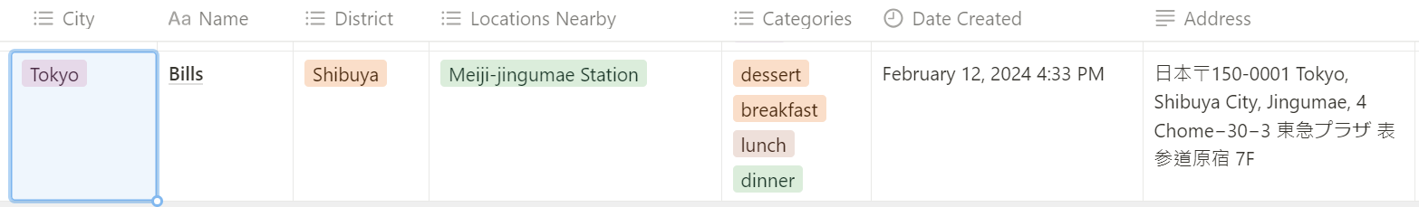

For example here is one of the entries I have in Notion. It is already synced to Google Sheets.
I have the "Categories" column with multi-selection so when I am looking for different meal I can filter the information in Notion. The options are shown in Google Sheets as plain text in a cell but not multi-select dropdown list. When I update the options in Notion, let's say adding a "western style food" tag, is it possible for it to auto update in Google Sheets as text "breakfast, dessert, dinner, lunch, western style food"?

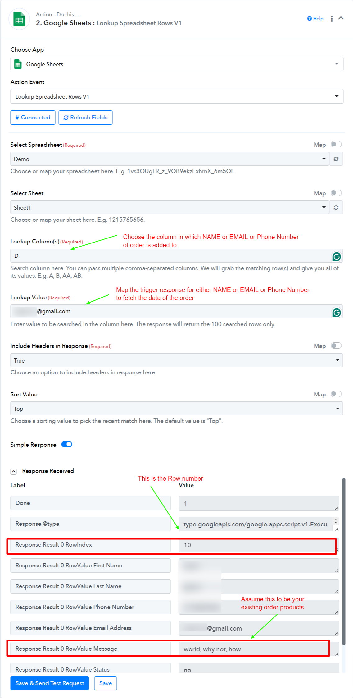

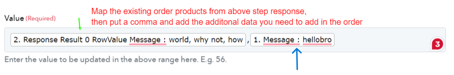

Kindly check below Google Sheet steps, if this can work for you-

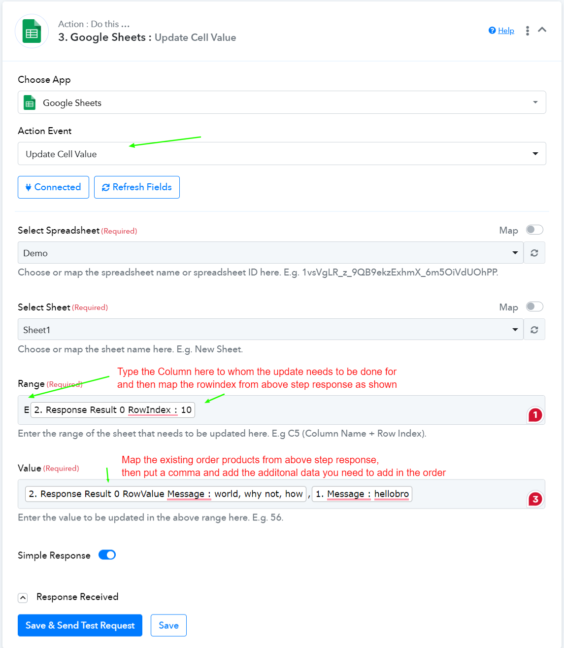

Add new step as shown below with the instructions-
This will work only for adding single updates. It will not work for the Delete row.
You can check at your end, as this is just a workaround.

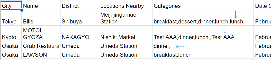

kkk666 — Reply ·

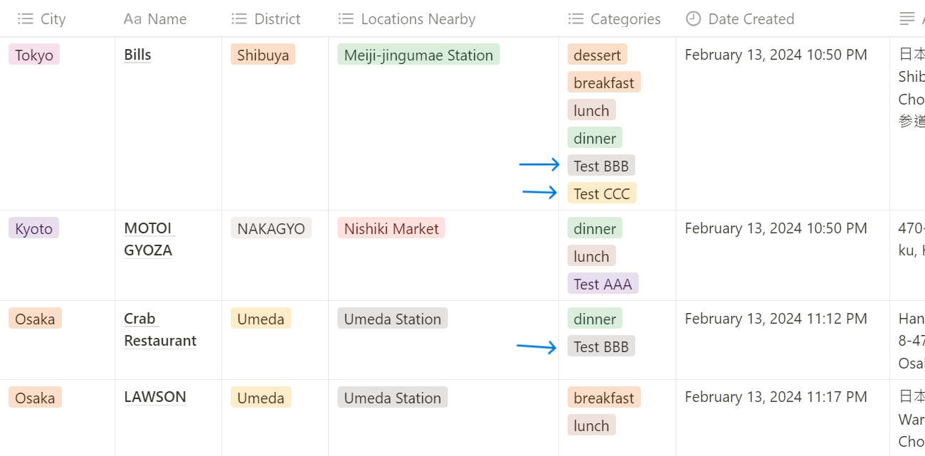

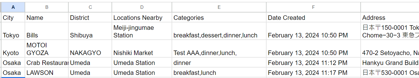

Hi @Subin. Thank you so much for your advice. I tried it out but the updated data in Google Sheets is not the options I added in Notion.
This is the original table in Google Sheets.
"Test BBB" and "Test CCC" tags are added in Notion.
The spreadsheet is updated but the data added are incorrect.
I think there is probably something wrong with the mapping of the additional data in the Update Cell Value Step.

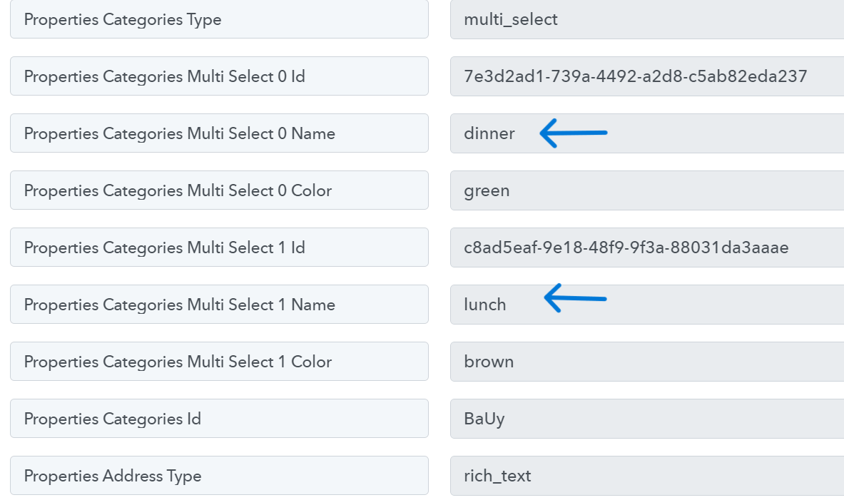

Before I set up the workflow, The tags for Kyoto Motoi Gyoza were "dinner" and "lunch". So the response I got from Step 1 were these two options.
When mapping the cell value to be updated in Step 3 (image below), I could only map the [2. Response Result] part but couldn't find the additional data part to add. So I went back to Notion to add a [Test AAA] tag and refresh the response result in Step 1. After that I could find [1. Properties categories Multi Select 2 Name : TEST AAA] in the drop list and map it in.
The way that I went back to change the response result in Step 1 when I was already doing Step 3 is probably wrong because that should be also changing the response result in Step 2, which is the [2. Response Result] part of the cell value mapped in Step 3. Can I know what is the correct way to map the additional data part please?
Also, do I need to map all of the possible options I may add in Notion in the future so that the system can recognize the options whenever I add them?
Thank you so much for your help!

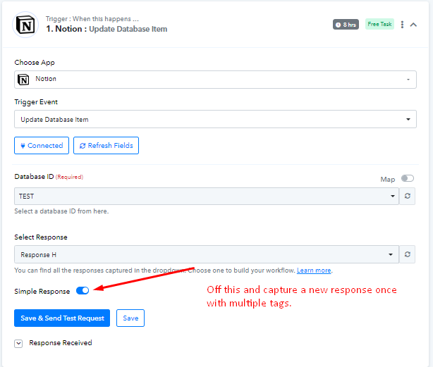

Hey @kkk666 !
Can you once capture a response with multiple tags in Notion with Simple Response OFF -
Once done, we can check further is the usecase which you have mentioned is possible or not.

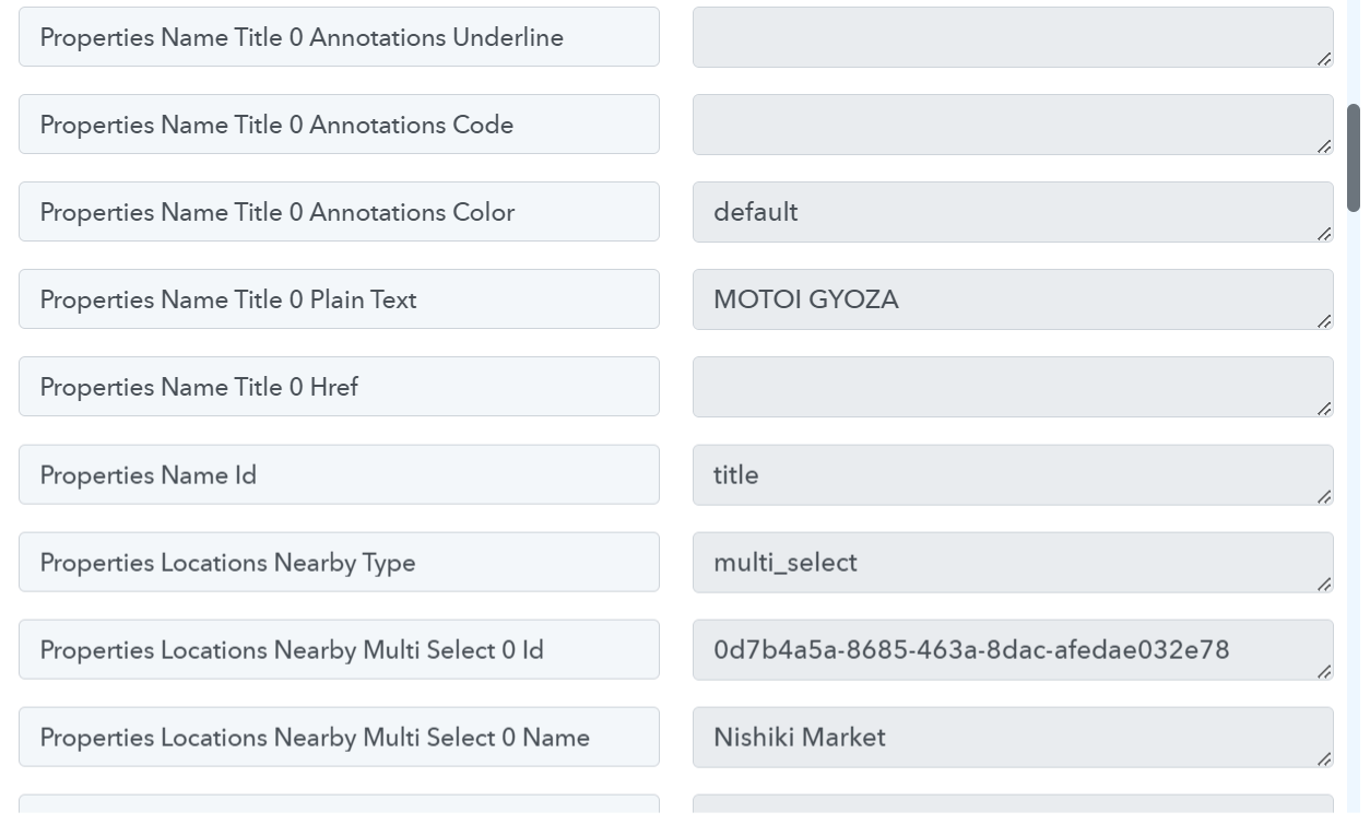

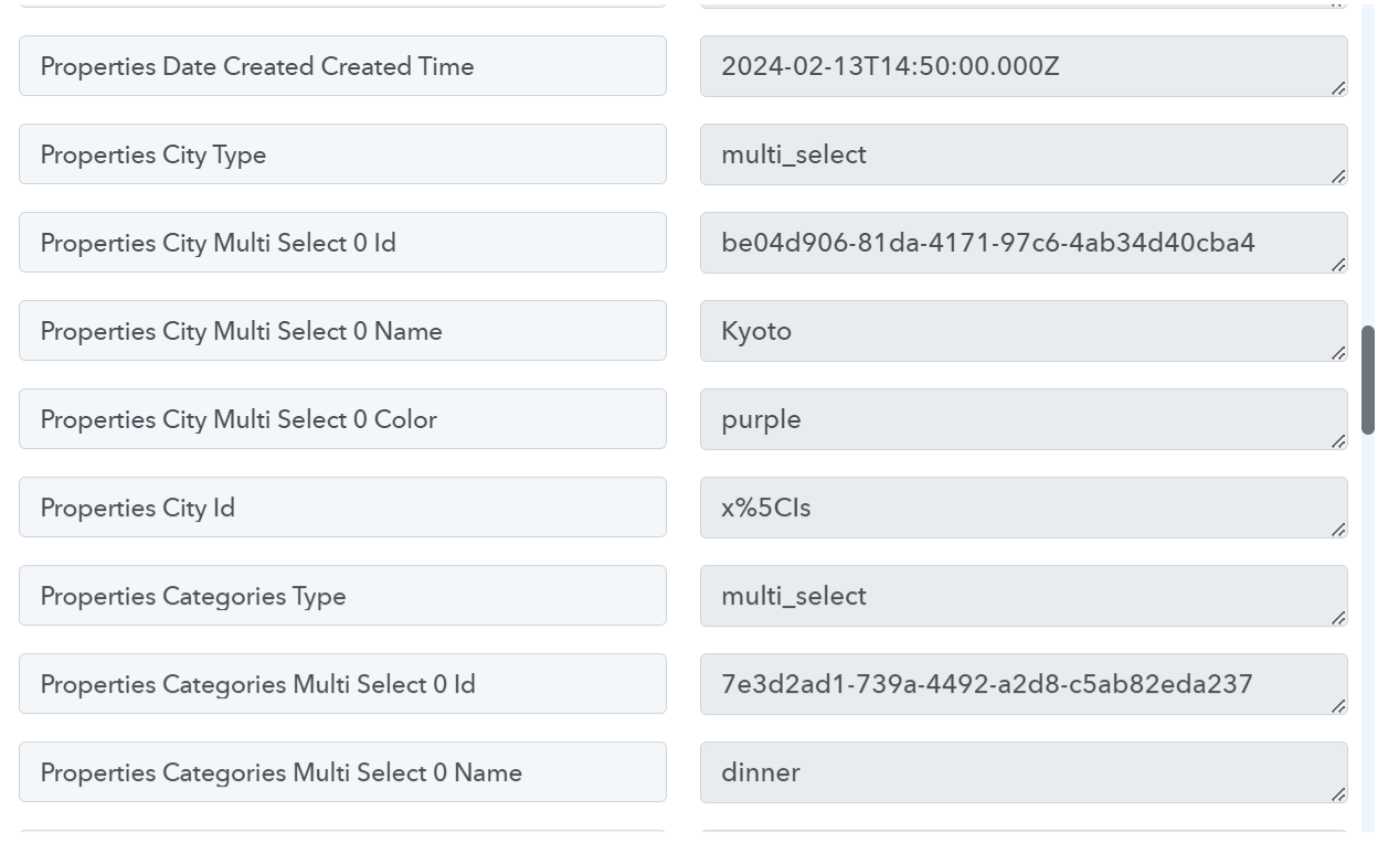

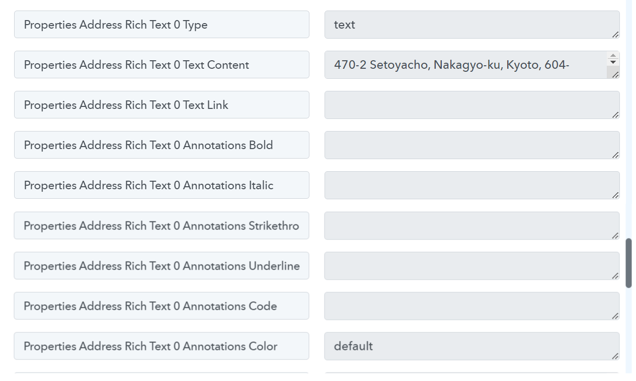

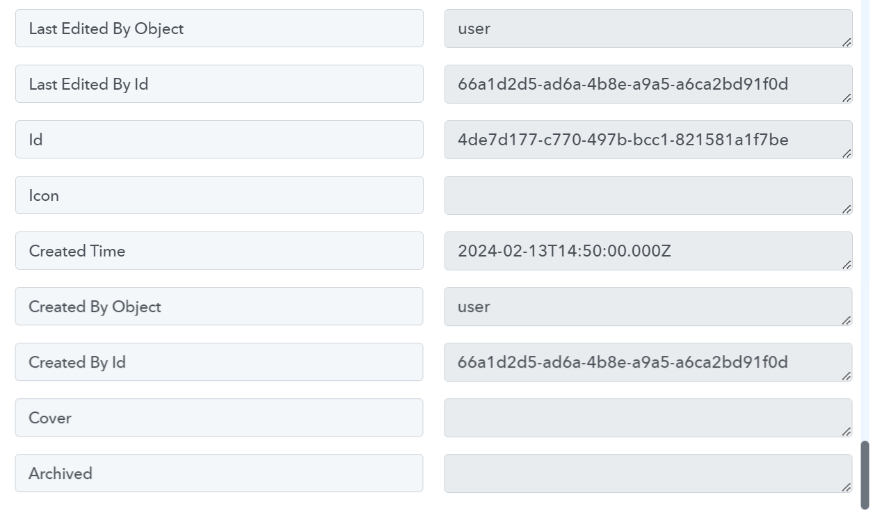

Hi @Subin . This is the advance response of the "Kyoto Motoi Gyoza" row. Hope this helps. Thanks a lot!
