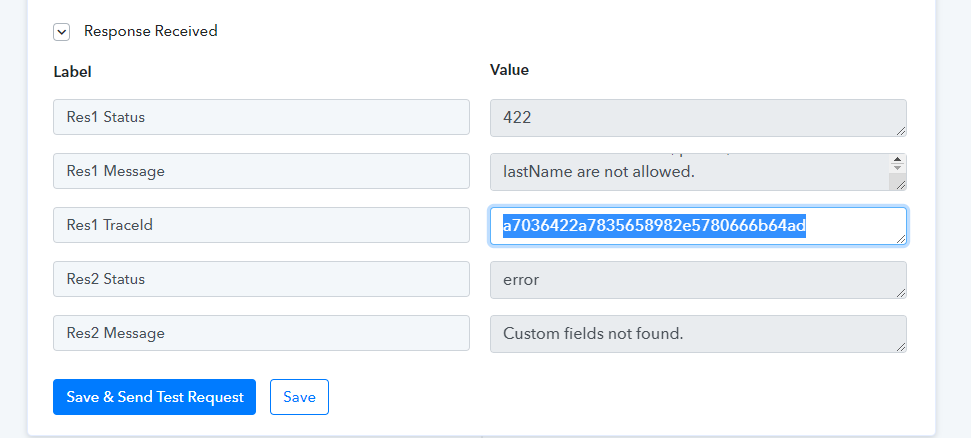

My GoHighlevel connector said "deprecated" so I updated it. After updating it and setting all the fields to what they were before, when I do a test run (I've validated all the values and they are correct), I get an error "Contacts without email, phone, firstName and lastName are not allowed."
Error code is 422
Traceid is a7036422a7835658982e5780666b64ad
Looks like this latest version of the connector is broken. Please let me know what to do to fix the issue.

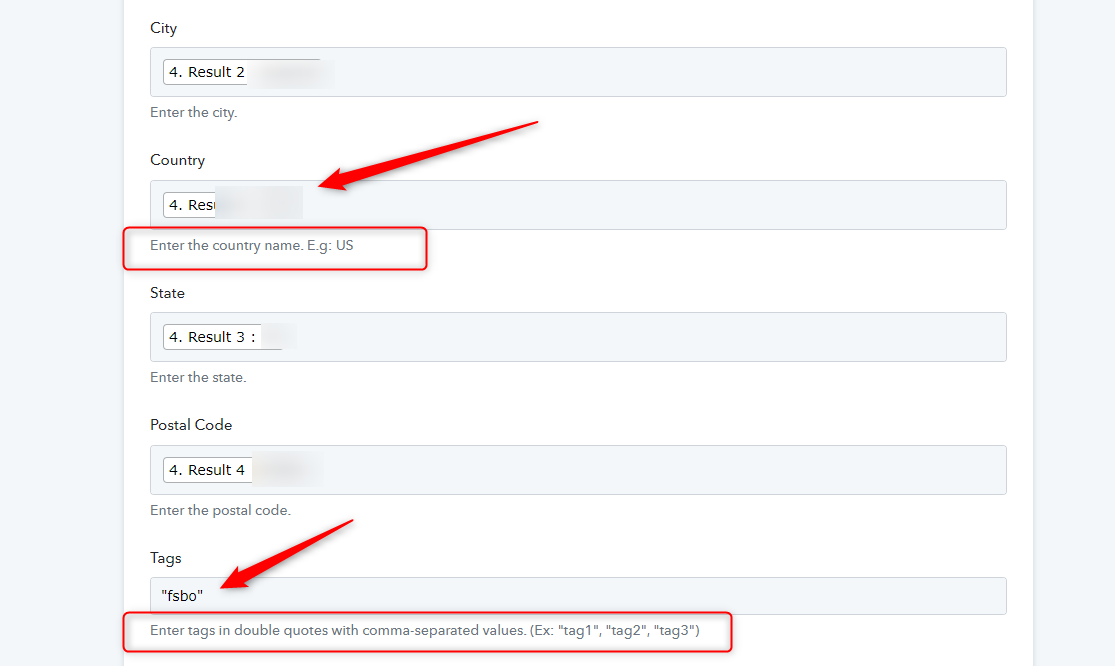

Hey @rsayad
As we can see from your GHL action step you have to pass the tag(s) in double quotes as mentioned in the help text and the country name should be like the US for the USA.
