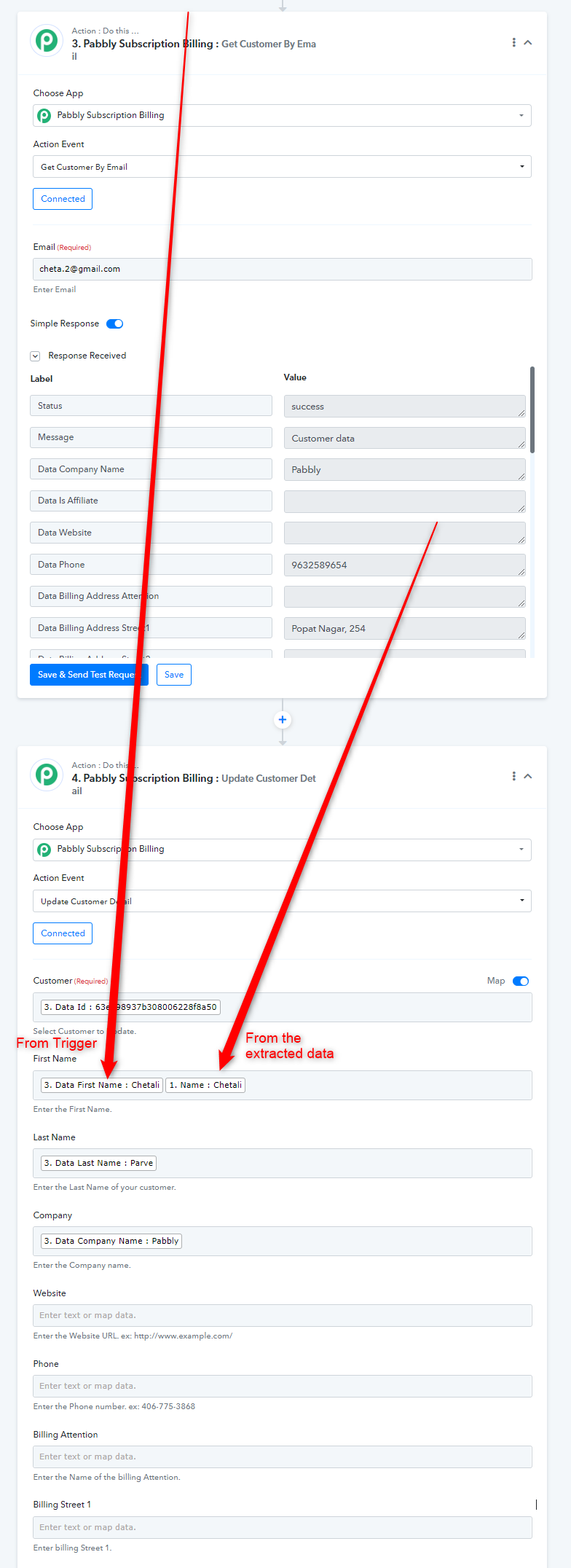

I'm using Pabbly Connect to integrate with Pabbly Subscription Billing.
I'm receiving from webhook a specific information that I need add in the customer profile, in this field:
Data Shipping Address Attention
I used the native PSB action and it works with Update Customer Detail event.
But the problem is: it's adding the webhook information in this field but it also replace the old content.
How can I first check the current informations on this field, and after that I update adding the new webhook content.

Hey @rodrigo
In terms of updating the same data from the trigger response and searching the customer's details, you can then map the data to add the incoming name and existing data.
