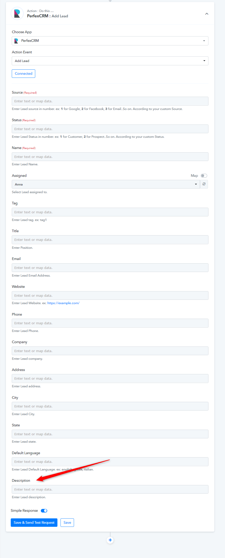

I'm not a coder but I've seen that it support the "description" field. Could eventually use that one?
Hey @digitaltown
The "description" field is already available in the action step.

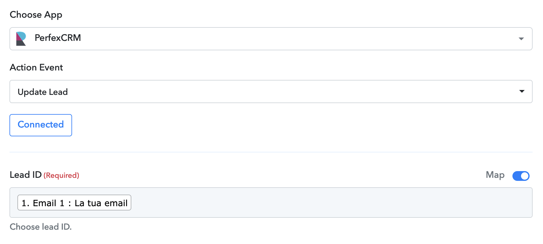

Thanks, I want to update lead, not add one so I've found this way but I need an help to know how Pabbly identify the lead to update.
I mean that a lead that fill this form does exist yet so Pabbly should search that lead (using email I think) and update it putting in the description all the form field.
Is that correct?

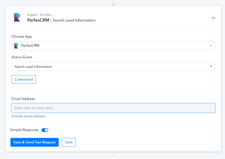

Kindly use the "PerfexCRM: Search Lead Information" action step first to get the Id of the Lead which you have to pass in the "Lead ID" fields.
