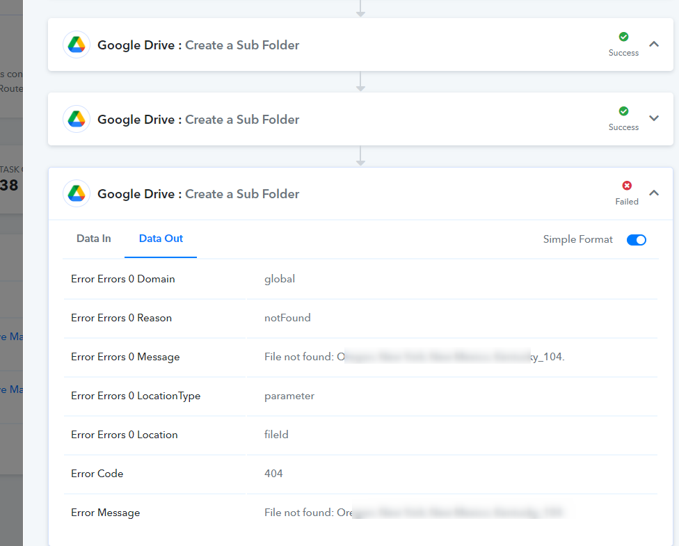

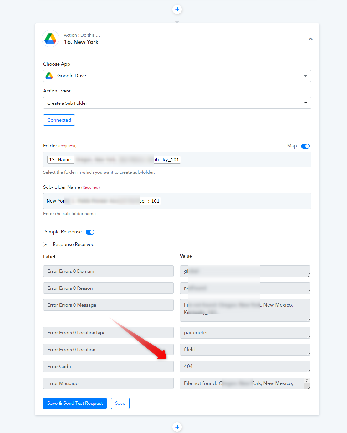

We checked over your use case and your account whereas it seems like you have already established your use case successfully. Although we found an unsuccessful step that you have used inside your workflow. For resolving that, you need to pass the folder name and folder correctly.
An error occurred when it ran in the automation -

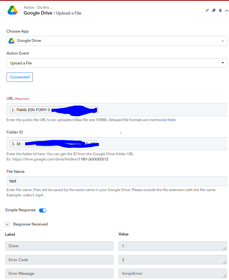

I dont think you answered my question. I was okay with this step, however, I want to upload PDF files into these folders from my airtable. So for example, my team will upload documents to Airtable including emailed documents from the client. I then need to store some of this data in GoogleDrive for record keeping purposes.
Here is a screenshot how I attempted to do this step.

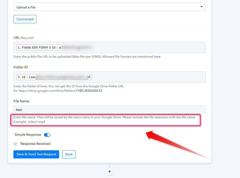

Hey @Mohammed K
To upload a file in Google Drive, you need to pass the valid and publically accessible file URL and on the folder ID field, you need to enter the folder Id. For that, you can get the ID from the Google Drive folder URL.
Eg: https://drive.google.com/drive/folders/11BY-JXXXXXX1Z
And in the "File" field you need to enter the file name whereas files will be saved by the same name in your Google Drive. Also, you need to include the file extension with the file name. Example: video1.mp4, Image.JPG

Thank you for this. I will attempt this shortly but that being said… these documents are not public accessible. Would this mean what I am trying to do is not possible?
Mohammed K — Reply ·
I got it sorted out and it worked! thanks Supreme Verma!
