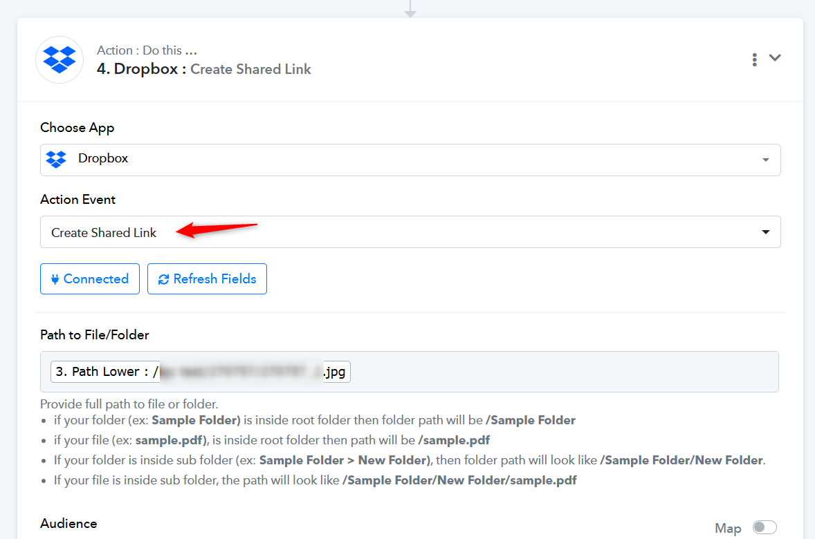

We have added a 'Create Shared Link' action event to your workflow, which will provide you with the shared link that can be used in the WooCommerce action step.

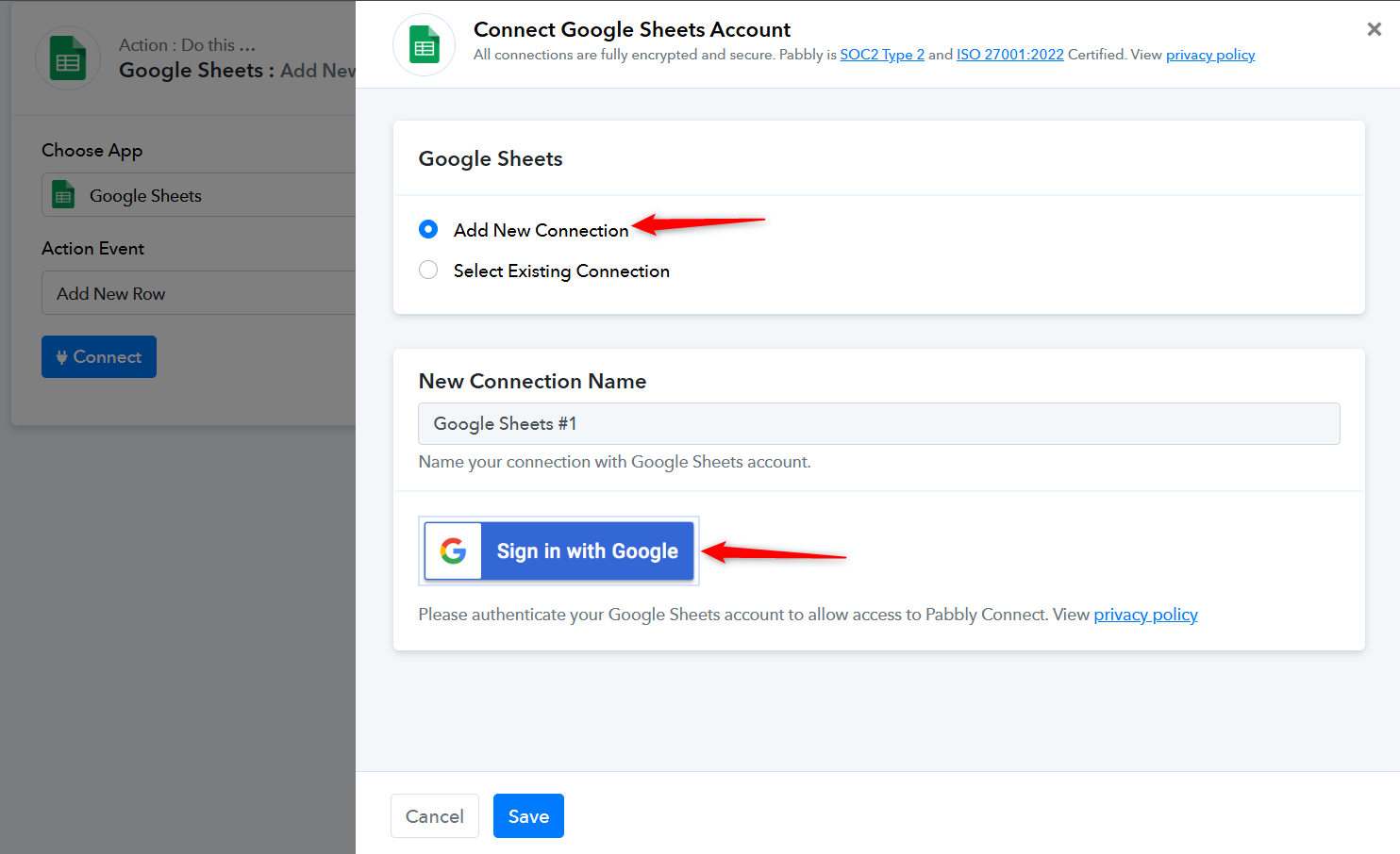

Ok, I have the connection to the Google Sheet added now.

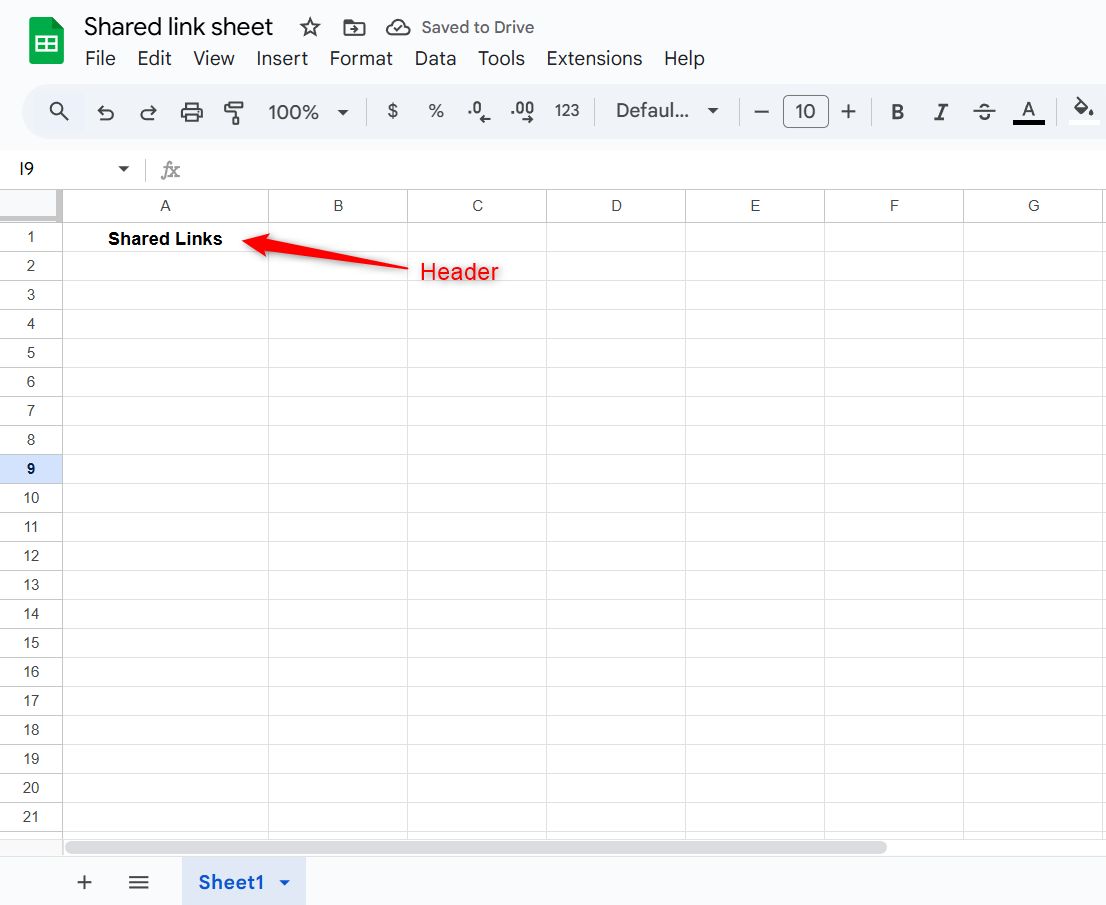

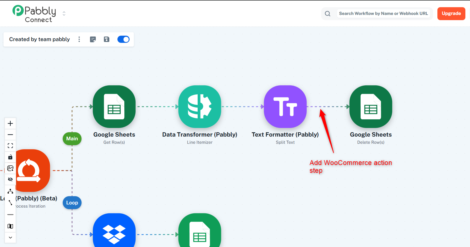

We have setup the Google Sheet and Loop related workaround to this workflow.
https://connect.pabbly.com/v2/app/workflow/mapping/IjU3NjcwNTZkMDYzNDA0MzY1MjZkNTUzNDUxMzEi_pc
You can now add the WooCommerce: Update Product action step to this workflow in the Main route and map the shared links from the Data Transformer (Pabbly) action step.
Then test your workflow by creating a new folder with multiple files in the folder named 'IGC Test'. It would take up to 24 hours for your workflow to trigger once you have created a new folder within 'IGC Test' folder.
