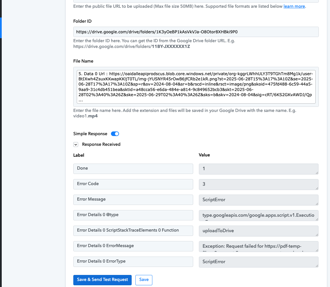

I have seen this question asked before, but the only reply did not help me, hoping someone can help.
I am trying to create a workflow that makes PDF's, stores them on my google drive and then imports them into wordpress. I can see the pdf url that gets created is valid and a real document, but when I try to upload it to my google drive, I see this

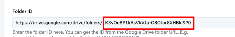

Hello @FredMills ,
Just add folder ID in folder ID section whole url. Please refer below screenshot for reference. If you are still not able to solve this on your own feel free to DM me and we can do a free zoom call. FYI I'm not from Pabbly Connect team, just a freelancer who helps other Pabbly users.
FredMills
Thank you so much for answering me. I’m afraid I tried that in the first place and got the same error. I can connect to Google via my Workspace login and my gmail one, but get the error with both. Thank you so much for trying to help me.
Ok apart from that you can check the url is public or not
Make sure the URL is accessible publicly.
Try opening it directly in your browser(Incognito mode) — it should start downloading without login.
And you are putting url in file name section. Your file name should be file_name.pdf not url
Let me know if this works. If not you can dm me we'll do free zoom call and I'll solve this for you.

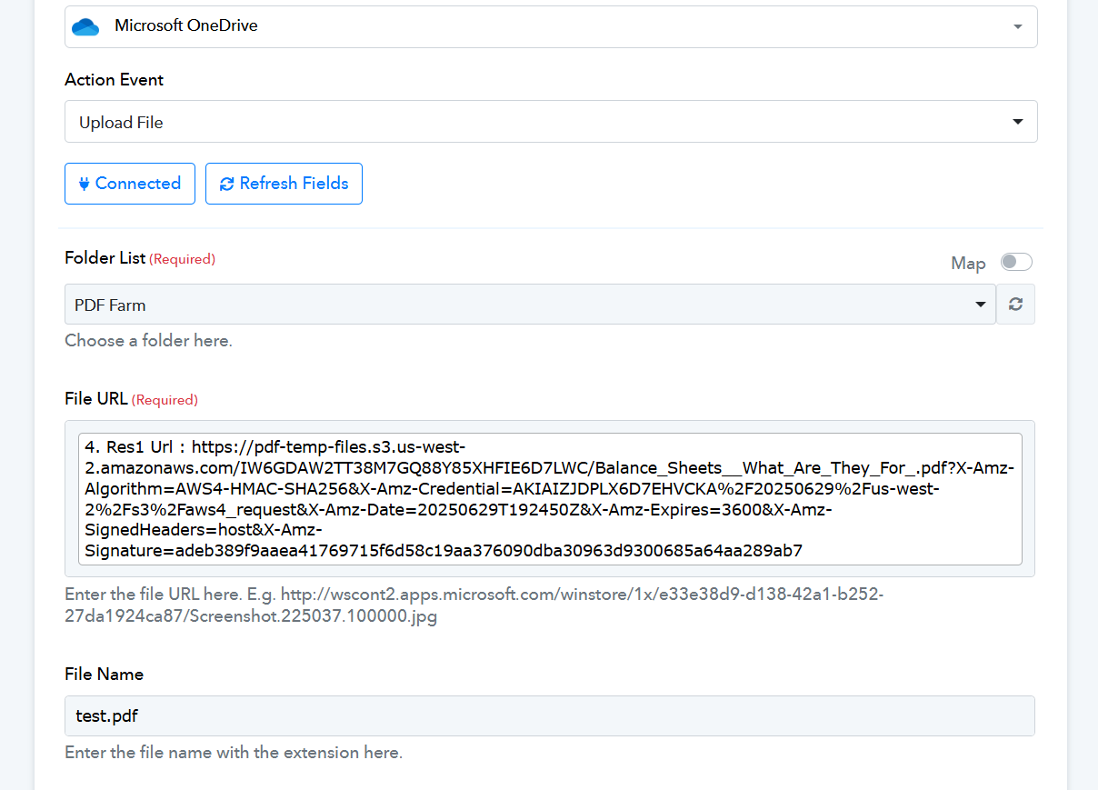

Thank you again Himesh. I’m afraid I followed all your excellent suggestions but still couldn’t connect. I couldn’t get Pabbly to upload my PDFs to Dropbox or OneDrive either, so I think there is something very wrong somewhere. Iam hoping I am not the first person to have this problem and that someone has discovered a working remedy. Thank you for trying though.
ArshilAhmad
Moderator
You were trying to upload a file with a name that contained a question mark, which seems to have caused the issue you were encountering. The file has now been successfully uploaded to OneDrive.
