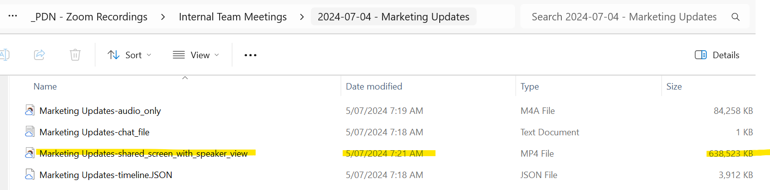

Hi team, I've got a workflow where I'm saving zoom recordings to google drive, and I understand there is a 500MB limit. I'm using the 'large file upload' action so it can upload up to 500MB but I'm finding some inconsistencies...
FIRST INCONSISTENCY:
If the file is over 500MB it fails, which I expected, but when I re-run it, sometimes it actually works successfully making me think that it can actually work if over 500MB.
I'm hoping for 100% clarity on what the expected outcome is, and if there is in fact a way to 'get around' the limit, this would be ideal, as we have many calls each week where the calls are over 500MB, and would like it to work.
See this Task History: IjU3NmQwNTZlMDYzNjA0MzM1MjZiNTUzNDUxMzY1MTY3NTQzNyI_3D_pc
Below is a task I re-ran this morning and it worked successfully, eventhough it was over 500MB:

I had a discussion with the technical team, and they informed me that the 'Google Drive: Upload Large File' action step is designed to handle files up to 500MB consistently.
While it may sometimes allow uploads of 600-800MB due to varying network conditions, this is not guaranteed. For reliable uploads, we recommend keeping your files under 500MB. Attempting to consistently upload files over this limit may result in failures.
projects@developernetwork — Reply ·
Okay thanks for the clarity here.
