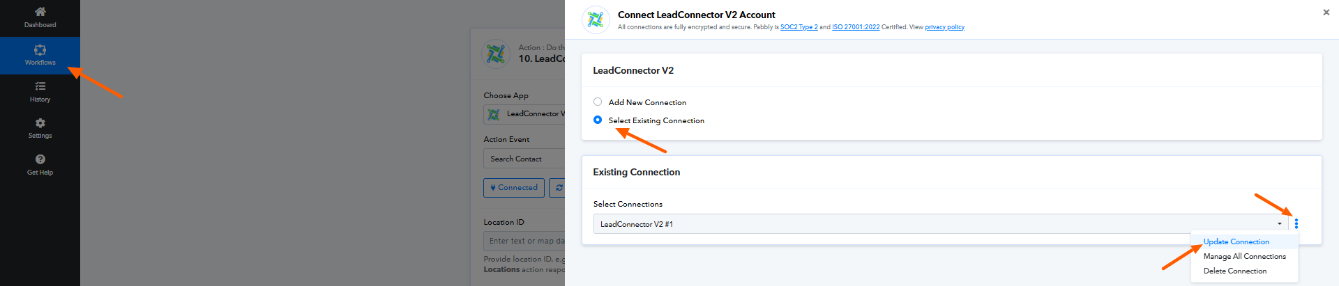

Hello @Idama,
Could you please try updating the connection directly under the Workflow section instead of the Connections section, and let us know if that helps resolve the issue
Kindly record the process while attempting this. If the issue persists, please share the recording with us so we can investigate further.
Ida Ma — Reply ·
Do I have to do it for all the workflow or just update one of them as they all use the same connection?
Hello @Idama,
Yes, your connection has been successfully updated, and you do not need to repeat this process for every workflow. To verify if the issue is resolved, please try re-executing a Task History and let us know the outcome.
