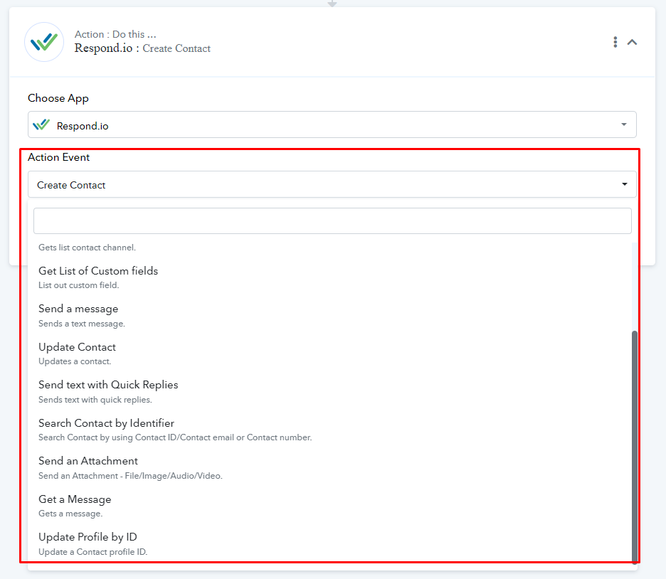

Dear PabblyConnect Support Team,
I am reaching out to express a critical need for an update in the [Actions] of Respond.io to accommodate the (Send a Template) action through PabblyConnect. This specific action is integral to my daily operations and its absence is causing significant inconvenience.
Recently, I transitioned my WhatsApp Business Account (WABA) from 360Dialog to Respond.io, primarily due to the absence of a monthly subscription fee and the frequent technical issues encountered with 360Dialog. The technical support from 360Dialog often took longer than expected to resolve these issues which greatly impacted my work efficiency.
However, post-migration, I was taken aback to find that the crucial (Send a Template) action is not supported in PabblyConnect integration with Respond.io. This discovery has put a damper on the otherwise smooth transition and has created a gap in my workflow.

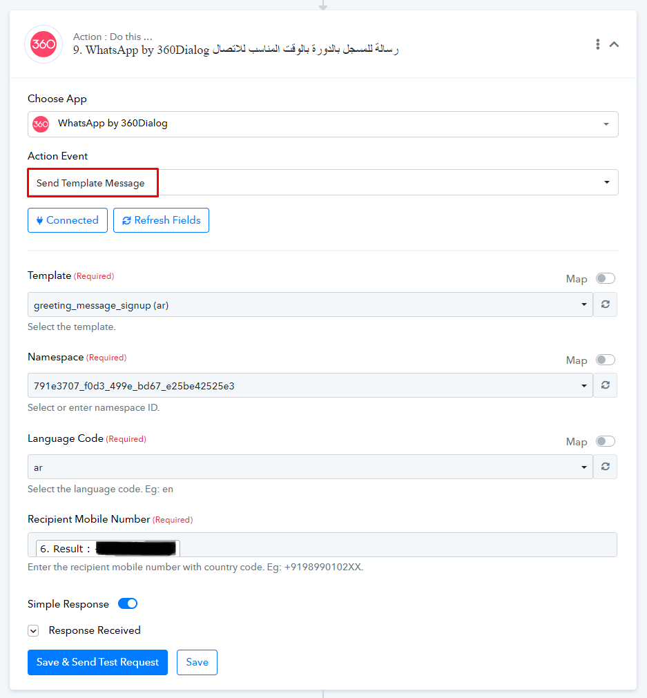

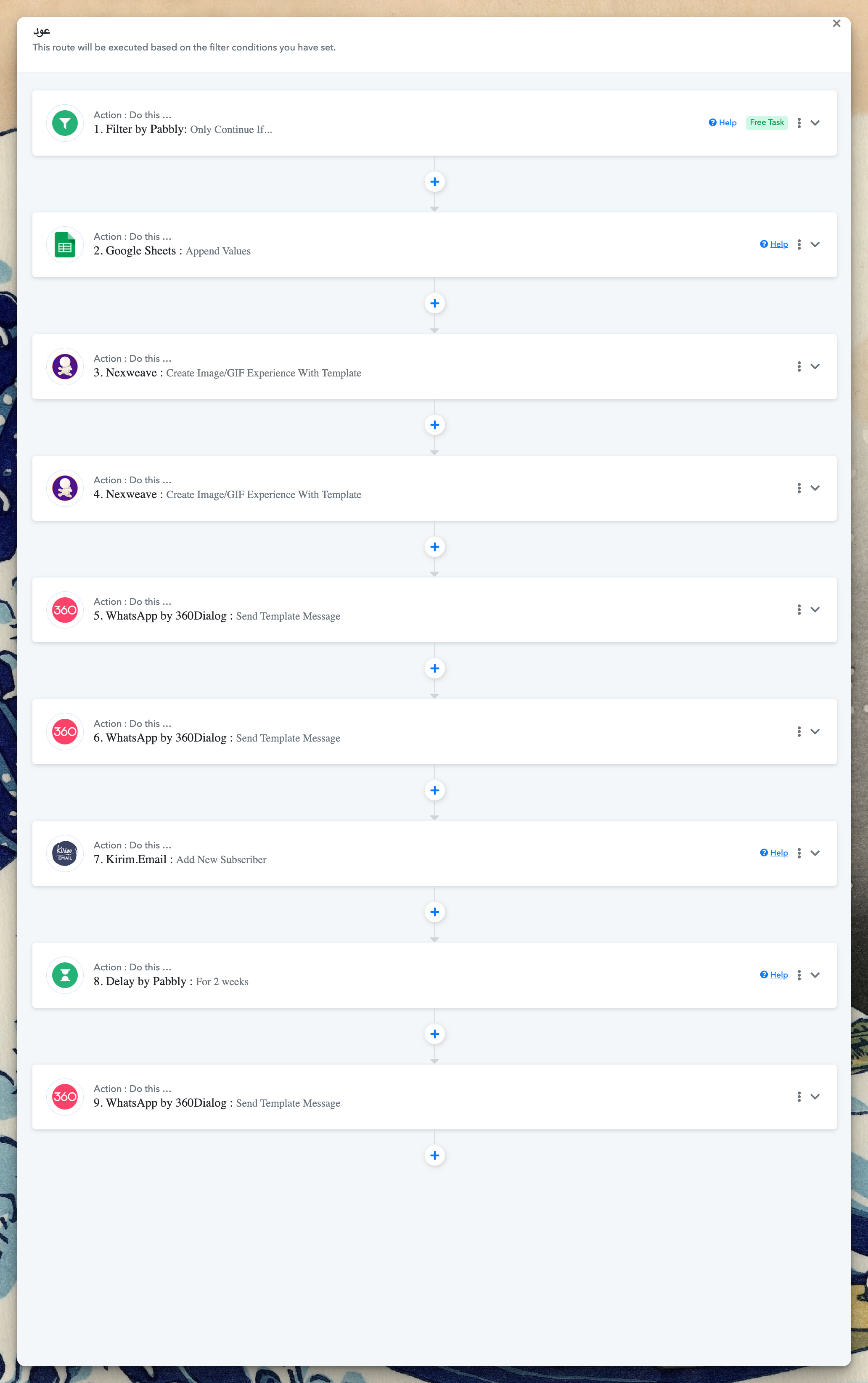

I have many workflow contain (Send template message) action like this:
Hope to replace all these 360Dialog actions with Respond.io new action (send template message).

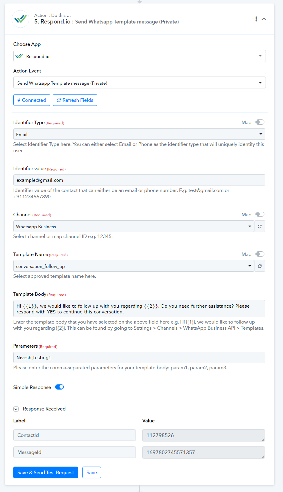

Hey @MedAlhassan,
We are pleased to inform you that we have successfully integrated the "Send WhatsApp Template Message" feature into the respond.io application. Please take a moment to test it, and if you encounter any issues, kindly notify us.

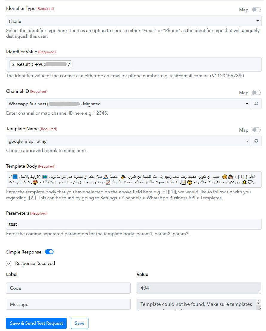

Hi @Nivesh.
Unfortunately, I am experiencing some difficulties with template sending. Here are a few points that might be impacting the process:
  1. Some WhatsApp templates do not have Parameters, yet this field is mandatory within PabblyConnect.
  2. Most templates include a Footer, Buttons or Header. Could these elements be causing issues with sending as they are not written inside the Template Body?
  3. When using emojis, does PabblyConnect handle them the same way? In other words, if I copy the full template content with all its emojis, does Pabbly understand these emojis or is there another language it uses? Since all templates utilize emojis to encourage customer interaction with the message.
All error messages displayed were: "Template could not be found, Make sure templates are synced on platform". However, the template name does appear within the options in PabblyConnect. I believe the issue might be with the Template Body.

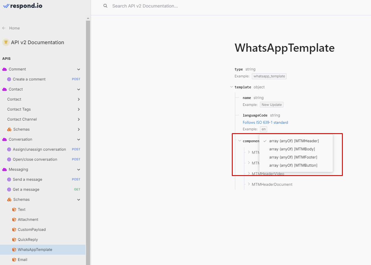

Mohammed Alhassan — Reply ·
Hi @Nivesh,

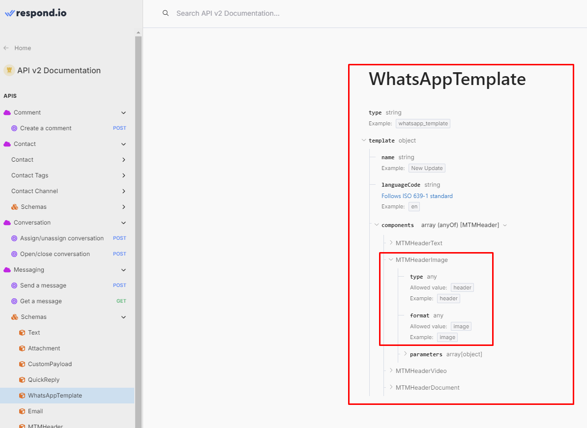

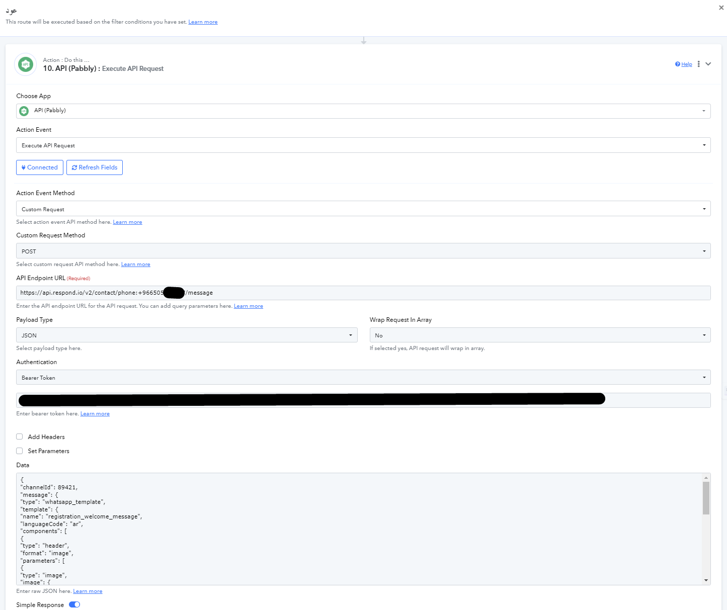

I know I have to make an appointment in advance, but if you are available now, I can meet you now (Google Meet) and explain the problem.
Briefly, I think that the action of respond.io to send the WhatsApp template needs some modifications and important additions. This includes adding a language box and modifying some fields, such as the template with an image in the header, the template with a text in the header, the template with a video, and the template with a document.
Note that I have successfully sent a WhatsApp template through (Pabby API), meaning that the API of the responde.io platform has no problem. The template contains an image header, in addition to the fact that the text is in Arabic and also contains a variable.
You can review the full (Pabbly API) workflow here: https://connect.pabbly.com/workflow/mapping/IjU3NjcwNTZhMDYzMjA0MzE1MjZiIg_3D_3D_pc
  1. The template can contain a header (image, video, file, or text). The template can also contain a button at the end of the message, and this call to action can include a quick reply button, phone number, or URL.
  2. Emojis are supported and worked 100%
  3. Arabic is supported and worked 100%
Reference:
1- https://developers.respond.io/docs/api/a748f5bfb1bb5-send-a-message
2- https://developers.respond.io/docs/api/3b5577141550b-whats-app-template
