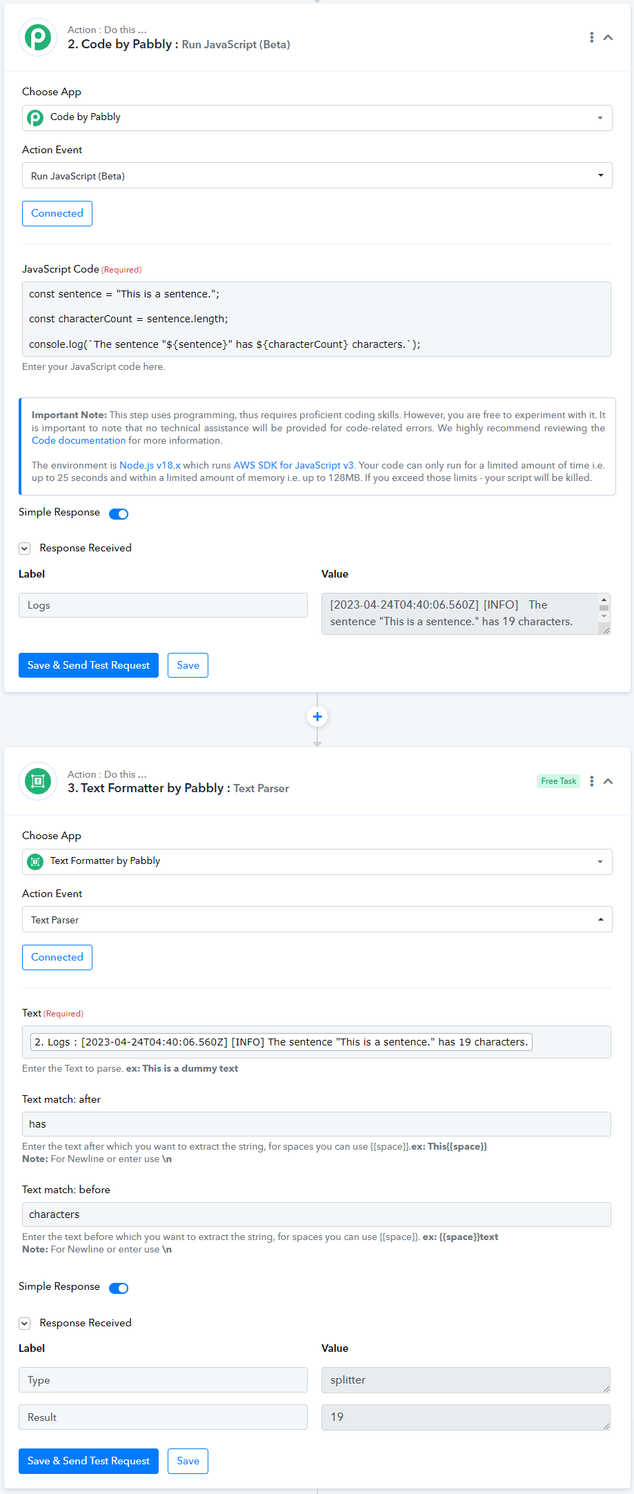

Hey @DGBN,
The scenario you are describing is possible. You just need to use Code by Pabbly: Run JavaScript (Beta) to find the number of characters in a workflow. Following that, use Text Formatter by Pabbly: Text Parser to extract the number, and then use this number in your Router.
const sentence = "This is a sentence.";
const characterCount = sentence.length;
console.log(`The sentence "${sentence}" has ${characterCount} characters.`);
Petram PVC — Reply ·
I solved a similar problem i was having myself by using a number formatter module set to performing a spreadsheet operation. Then use a formula like this:
if(LEN("value to count")>250,"true","false")
When setting up the router you can select the number formatter module and check if it is true or false.
