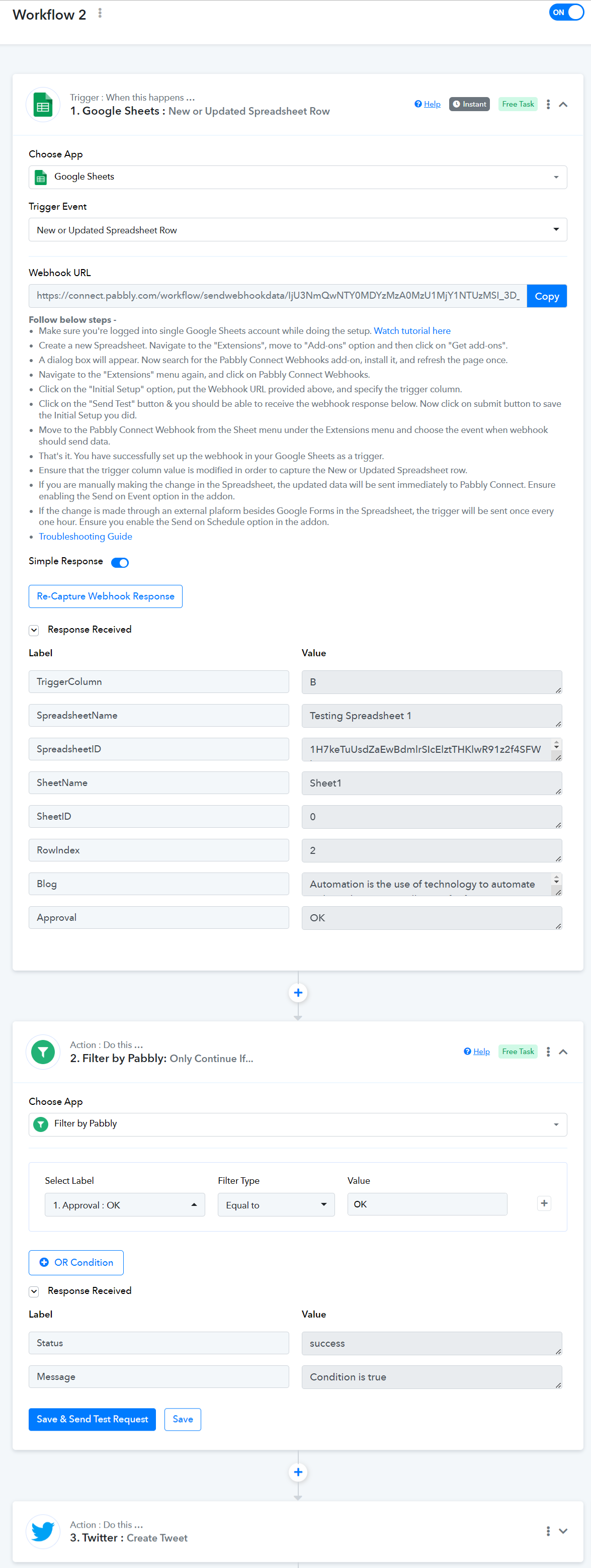

The use case you are describing is not possible through Telegram. However, if you could use Google Sheets to approve the tweets to be posted, then it is possible.

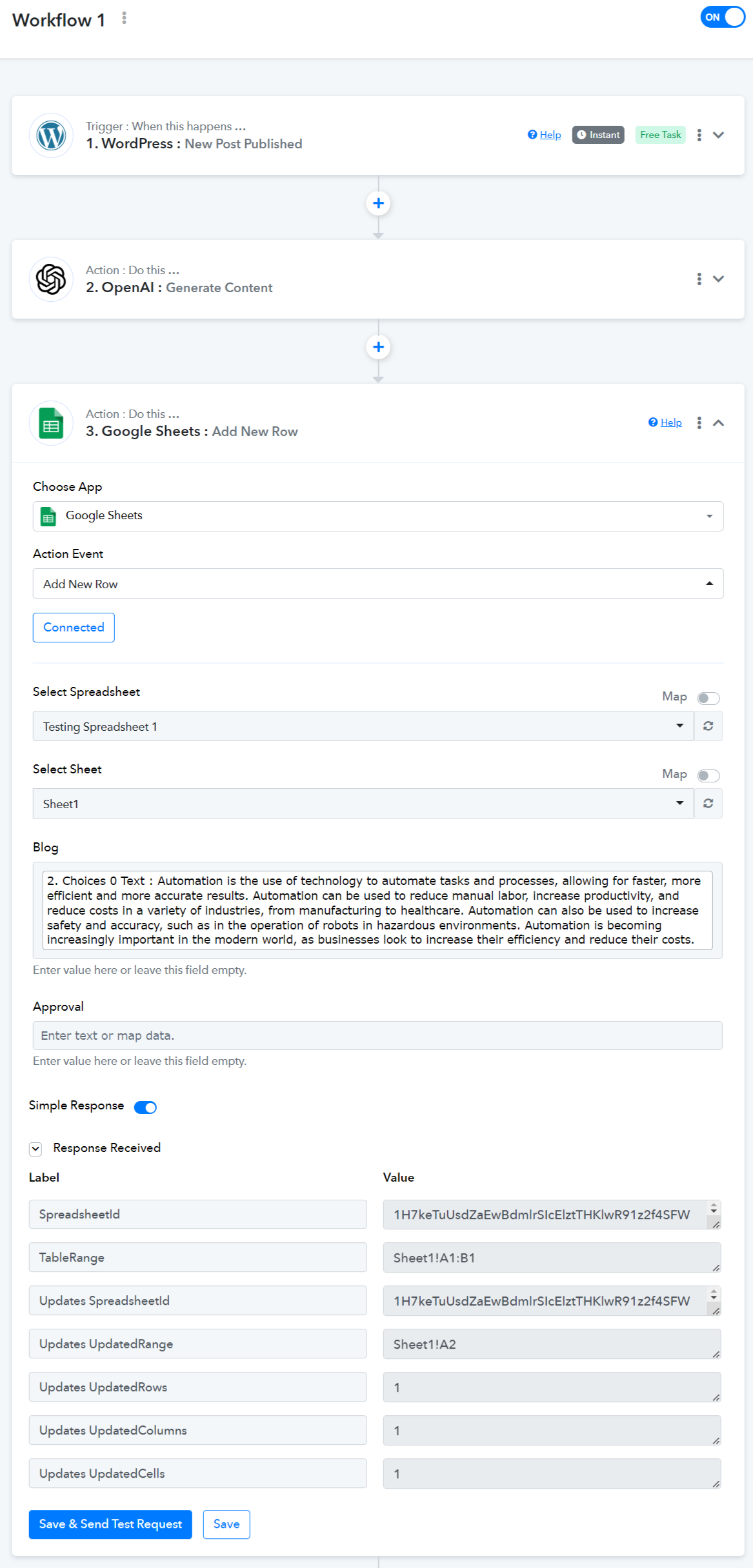

Workflow 1
  1. Capture the blog post using a trigger application.
  2. Generate a summary of the post using OpenAI.

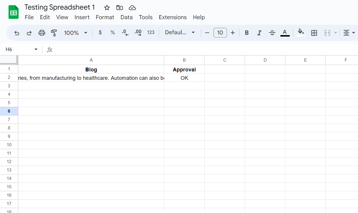

  3. Save the summary in Google Sheets for review.
Workflow 2
  1. Set up Google Sheets as the trigger application to capture the summary that you added to your Google Sheets.
  2. Add a filter to your workflow to ensure that the tweet is made only after approval.
  3. Set up Twitter as the action application to post a tweet.

The way I did it in the end was to have two workflows as you suggest.
1. Capture blogpost from RSS, summarise with OpenAI, save to google sheet, send to Telegram bot.
2. Reply to message "Yes" to post it, read from Google Sheets, post to Socials.
