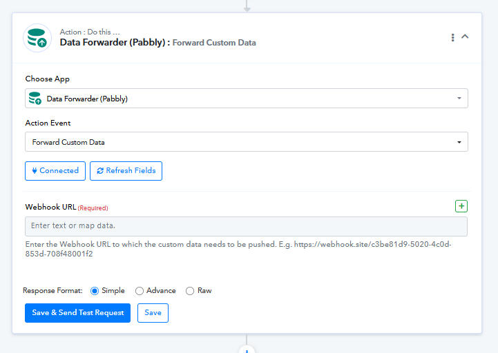

Hi @Parth,
To send only limited data in your webhook, you can use the Data Forwarder (Pabbly) action.
Select the action event “Forward Custom Data”, and then manually create only those parameters (keys) that you want to send. Map the required 4 fields there, and only those will be forwarded in the webhook payload (in JSON format).
This way, even if you receive 15 data points, only the selected ones will be sent further.

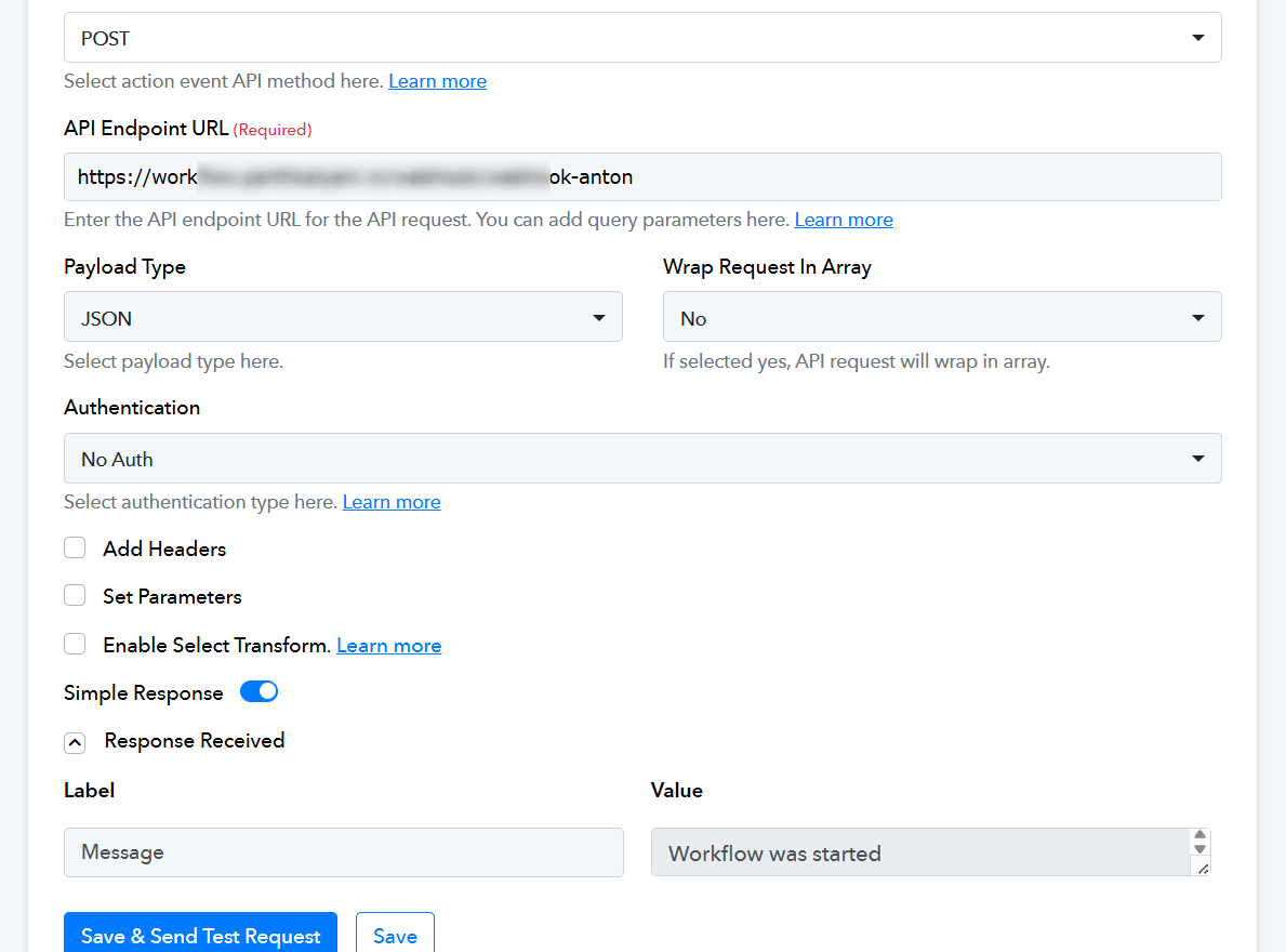

Hey @Parth,
It appears that you have successfully configured the API (Pabbly) action in your workflow, and it seems to be functioning correctly. Can you please confirm if the issue has been resolved or if you need any further assistance
there is another workflow where i was using data forwarder but based on today's discussion i changed it to API. Can you check if it is set properly. workflow name https://connect.pabbly.com/workflow/mapping/IjU3NjcwNTZjMDYzMTA0M2M1MjZhNTUzNTUxMzYi_pc and
Anton Auto Whatsapp AI Client Contact Image to Text converter
If you want to trigger the webhook without sending any data, then yes, step 2 of your workflow, “API (Pabbly),” has been set up correctly.

Hi @Parth,
The current setup looks correct.
Using the API module in Pabbly Connect is the right approach when sending limited data to an external webhook. Instead of forwarding all 15 fields, you can define a custom JSON body and include only the required 4 data points.
This ensures:
- Clean payload structure
- No unnecessary data sent
- Better compatibility with third-party systems
Your updated workflow configuration appears properly aligned with this method.
Hi @Parth,
Yes, your updated setup looks correct ?
Using the API (Pabbly) module is the right way when sending limited data to a third-party webhook. Instead of forwarding all 15 fields, you just need to create a custom JSON body and include only the 4 required data points.
This helps in keeping the payload clean and avoids unnecessary data being sent.
If your webhook is still facing issues, you may want to double-check:
- Field mapping
- JSON format
- Required parameters from the receiver side
