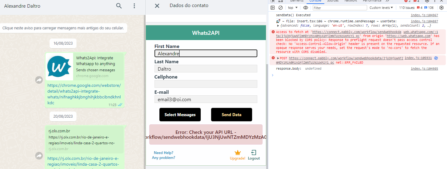

I have a chrome extension, that runs inside Whatsapp Web. And it works perfectly with the webhooks from Make . com , for example.
It used to work OK with Pabbly too, but since this weekend, it now gives the CORS error.

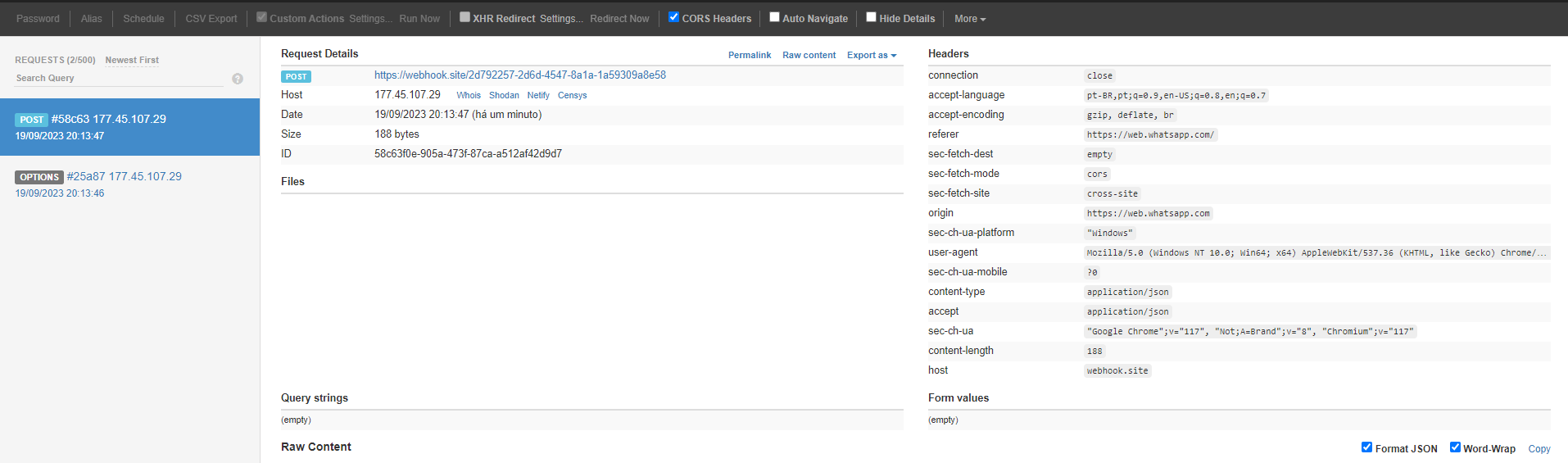

Trying in webhook.site, it only shows this error if CORs is deactivated. If it is Activated, it works normally as the print below:
Is is possible to change the CORs config to the Pabbly webhooks?
Hey @Alex Daltro
We've implemented some modifications on our side, and the CORS (Cross-Origin Resource Sharing) configuration remains unchanged. Please give it a try and inform us if this resolves the issue for you.
