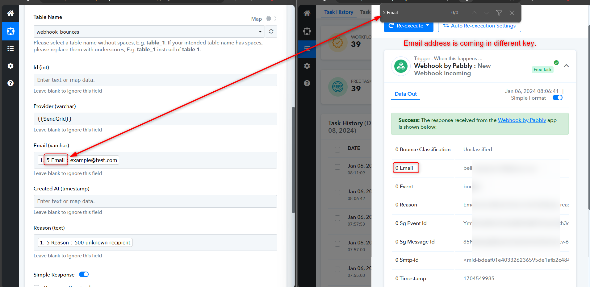

I've setup a workflow using a Pabbly webhook within SendGrid to insert data into a MySQL table.

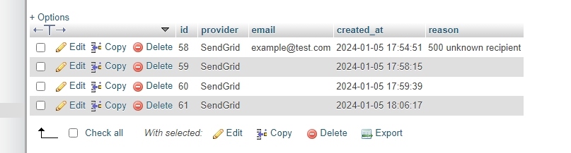

As part of the setup there is a "test integration" button within SendGrid that populates the webhook data within Pabbly, and also a test button within Pabbly to populate the data within the appropriate MySQL table. All testing worked properly and resulted in a new row in my MySQL table with an email value of "[email hidden]". I clicked save and waited for the next row to populate with "real" data. However, the next rows populated with all of the data from my custom variables, BUT none of the data from SendGrid. Please see attached screenshot.
I'm not sure how I could test this any further. It just doesn't seem to be working properly. Any thoughts on how to resolve this?

Upon examining your task history ID, it's evident that the data label you've linked in the MYSQL action step doesn't align with the information received from the trigger response. Consequently, only partial data is being sent through SendGrid.
To resolve this, I highly recommend capturing the webhook response once more and verifying the data keys from the triggering applications. There might have been changes in the data structure, causing this discrepancy. By doing so, we can ensure that the correct data is mapped, allowing for the complete transmission of information through SendGrid.

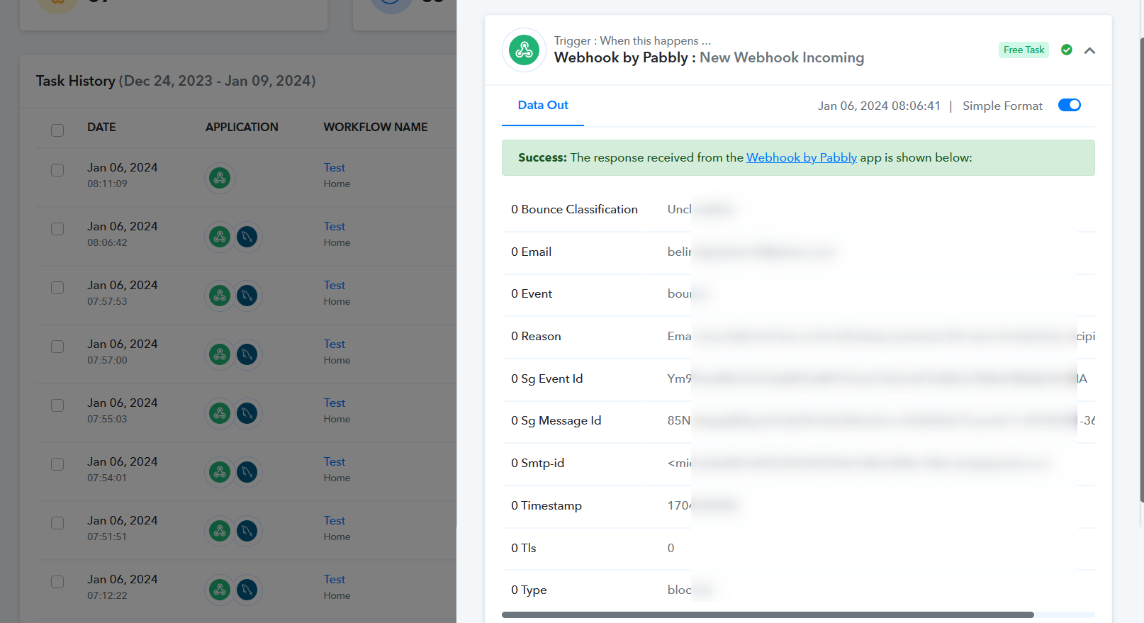

If you scroll down further, you'll find that 5 Email does, in fact, exist. 0 Email is just the first value visible in your screenshot. As you scroll down further you'll see that SendGrid includes a value for 0 Email, 1 Email, 2 Email, etc.
Please review the webhook response thoroughly. It appears that the "5 Email" key, containing the email address, is missing from the entire response. However, it's possible that your triggering application sent the email data using a different key.
Entire webhook response -
So, kindly recapture the webhook response and then try the automation again.
