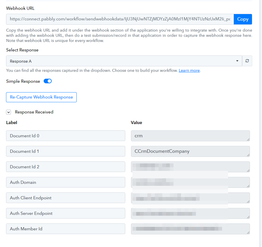

I have a problem with this too. I am executing the webhook from Bitrix24 and it does not return the variables, it returns these values:
The webhook response, in which the trigger is directly coming from the application as the trigger is a webhook-type trigger.
The webhook only captures the response data which was sent by the application itself and it is something that we cannot manipulate. If your data is not arriving accordingly then its a good chance that it is not being sent to Pabbly Connect's webhook URL In cases like these, you will have to contact the triggering application support team to see why your data is coming in such a manner.
To double-check, you can also confirm it through a webbooks testing site by the name of webhook.site.
You can copy the webhook URL provided by Webhook.site inside the application and do the test event inside the application's integration page to see if the webhook is being captured or not inside Webhook.site. This will double-confirm the issue.
