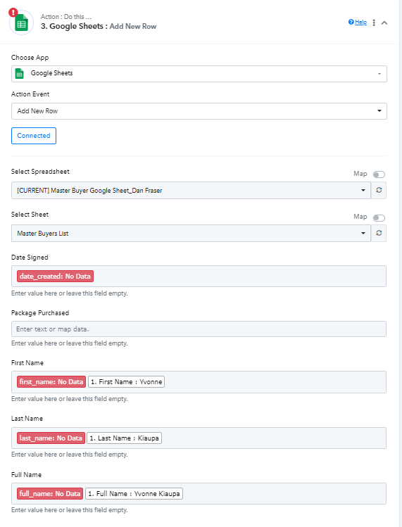

This problem has not been corrected. I tried multiple times to trigger the workflow. The problem is not with the application because the webhook is capturing the data in Pabbly. Each time I test the data is coming through but the workflow won't trigger.

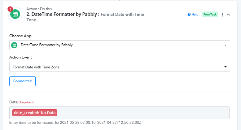

The error is on the date field YES. but the field I'm mapping it to shows data from the webhook but the data in in history is blank for the date. All of the fields in the Google sheet in data in show blank and will need to be remapped over and over. Once it goes back to recapture data on the webhook then the mapping is lost again.

1. The webhook data from GHL for the mapping some of the contacts will have a field of :date signed, some :date created, this is coming from the GHL signature box field when they sign their contract. So for some contacts the date formatter step will not execute a date.
2.Once the webhook executes the trigger step resets to 'recapture webhook' and the mapping is lost on Step 3 for the Google sheet.

The "created date" in the date field is not being captured in the response from the webhook, resulting in a blank value in the DateTime Formatter by Pabbly: Format Date with Time action step.
Similarly, in the third step, the Google Sheets: Add New Row action step, the keys for the mapped values such as first name, last name, etc., are different after capturing the response. This issue is causing a mismatch in the mapped fields.

Please avoid clicking the recapture button, as it automatically captures data from the Go High-Level application. Also, ensure that the keys you are receiving from the trigger application are the same mapped in the workflow's action steps.
Please make the necessary changes from your end and check if you are still facing the same issue.
