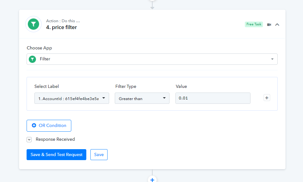

What is the problem?
Example of a successful automation (Origin A): Task ID - IjkxNDIxNTUwIg_3D_3D executed at Feb 04, 2022 17:00:35
Example of a failed automation being filtered incorrectly because no data is being passed on that parameter (Origin B): Task ID - IjkxNDcwODI0Ig_3D_3D executed at Feb 04, 2022 19:40:50
Flow url: https://connect.pabbly.com/workflow/mapping/IjE1MzUzMyI_3D

Hey @lma
If the point of origin of your Webhook data is different, then kindly use another workflow and if your workflow is identical then you can simply clone it and set the webhook trigger according to the source that would be easy to use.
Regarding the failed execution of the task is because you are comparing the alphanumeric account Id with a decimal number. Kindly compare the values which are numerical only.
