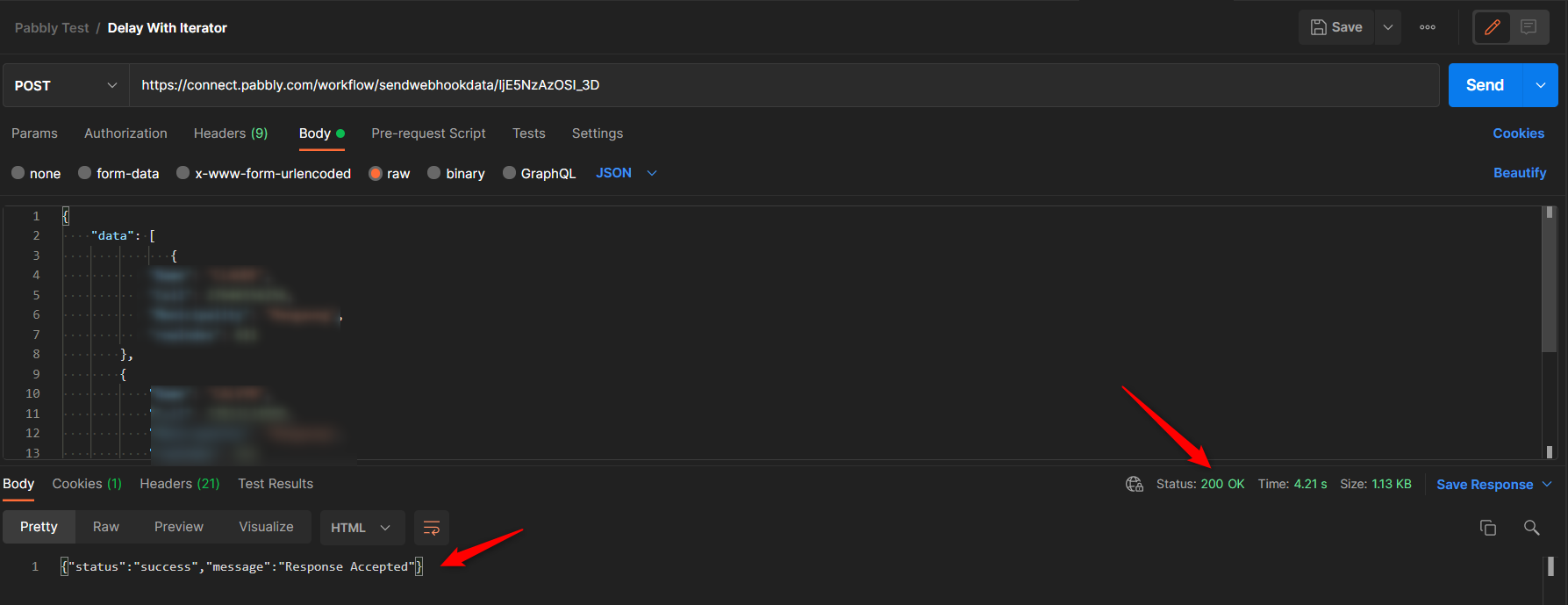

When you fire the webhook operation it takes the post data which has been sent to the webhook, once receiving the data on the webhook it returns the 200 status and in response, it returns the JSON containing the status and message from the webhook.
Eg - Taking the reference of Postman
