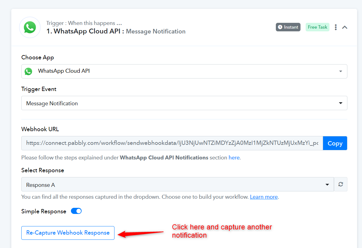

Hi @thecloudelite,
Based on your Task History, we can see that the key received during automation has changed from what was captured during your workflow setup. During your workflow setup, it was captured as 'Assigned', and in automation, it's coming up as 'Incoming'. Since the keys have changed, it's not being recognized by the Google Sheets action step, and it's not getting through to your spreadsheet.
https://drive.google.com/file/d/1FrDstVz6nSWltDcy_gNqxB5hoRGT04NT/view?usp=sharing
We suggest that you click on 'Re-Capture Webhook Response' and try capturing a new message in your workflow setup. Once you have captured the new response, map that response in your Google Sheets action step and see if that fixes your issue in automation.
