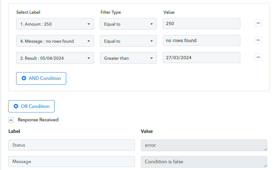

Please review the below workflow we are sending conditionally Whatsapp after fetching the data from SQL, it was working previously however it has stopped working.
IjU3NjUwNTZiMDYzMzA0MzY1MjZjNTUzYzUxMzYi_pc
It's looking problem in filter please see the below image condition would be true however I getting error "condition is false".

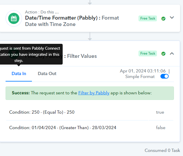

Hi there,
Please review the below workflow we are sending conditionally Whatsapp after fetching the data from SQL, it was working previously now it has stopped working without giving error.
IjU3NjUwNTZiMDYzMzA0MzQ1MjZlNTUzNzUxMzEi_pc

Look the image why am I getting error message "condition is false" , Is 05/04/2034 is not greater then 27/03/2024 ?
Hey @analytics
You'll need to modify the filter condition by either converting the date and time into Timestamp format or splitting the date into months, days, and years using the Date Time Formatter action step.
