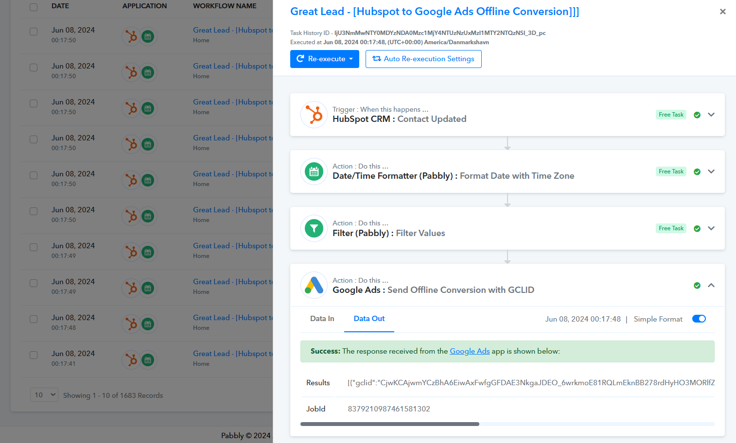

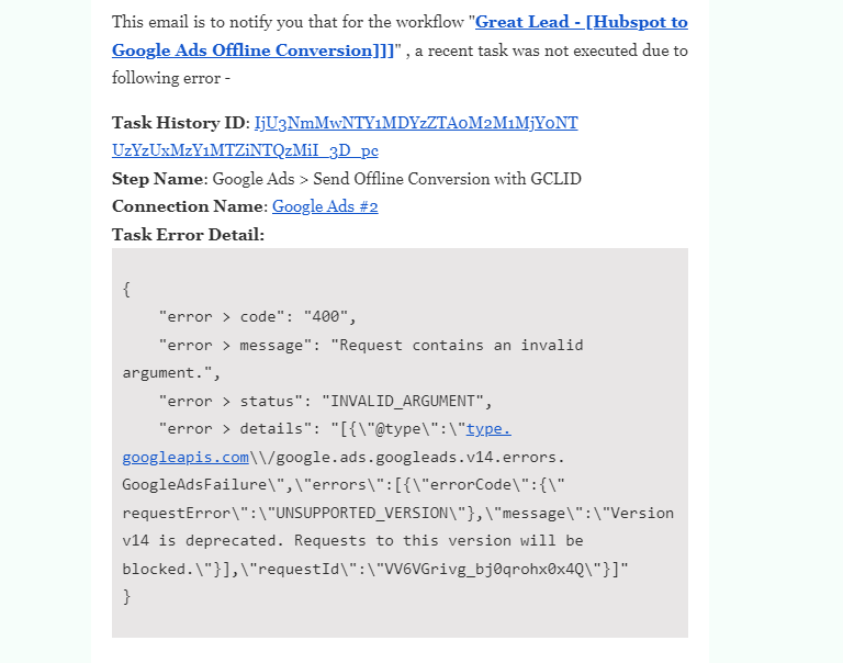

I have a workflow setup to send offline conversion from Hubspot to Google Ads, its all going good but I suually get this email. Can you help me understand whats the exact issue?
Hey @shadabdurrani
Based on the task history ID of your workflow, it appears that the Google Ads action step has been processed successfully.

@Supreme could you please confirm if it's due to a depreciated API or just a bummer?

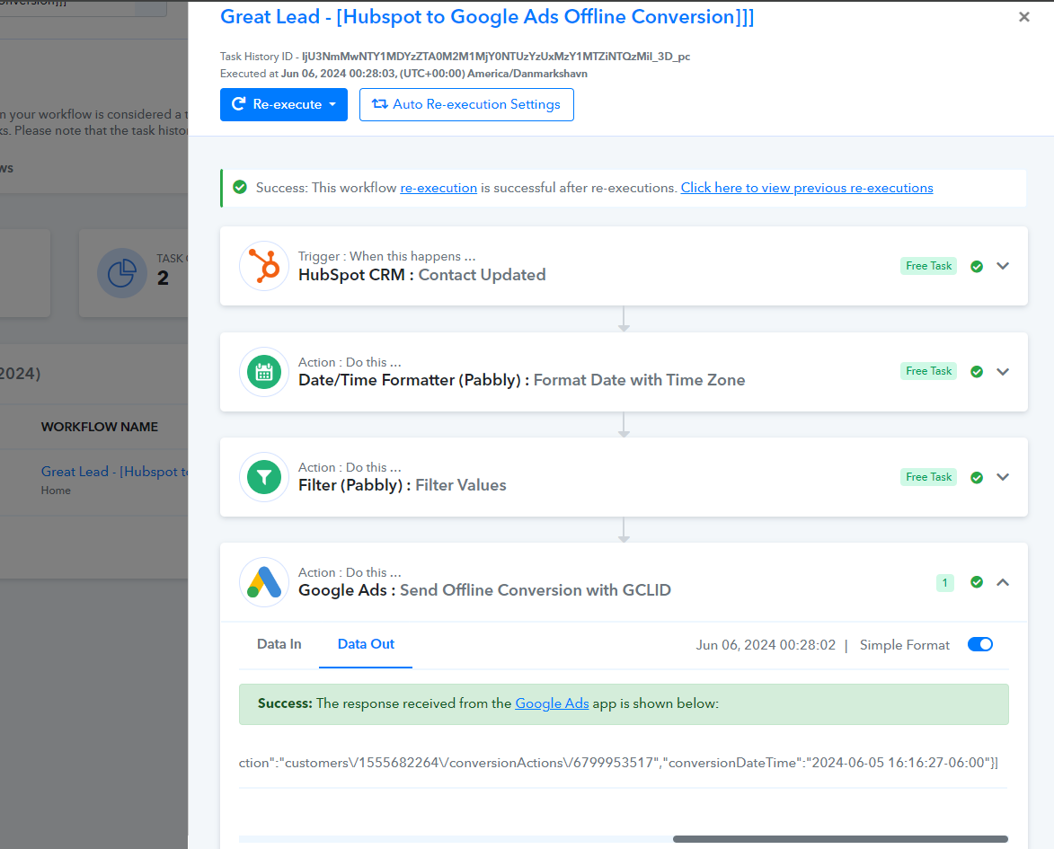

It seems that in that instance, the API did not respond, and as a result, Google Ads reported an error. However, if you re-execute the action step, it should work correctly.
