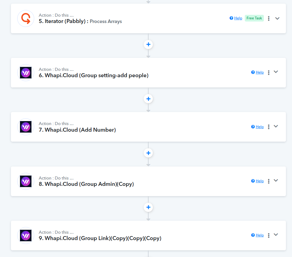

Why the "Iterator(Pabbly)" just loop process the first row data?

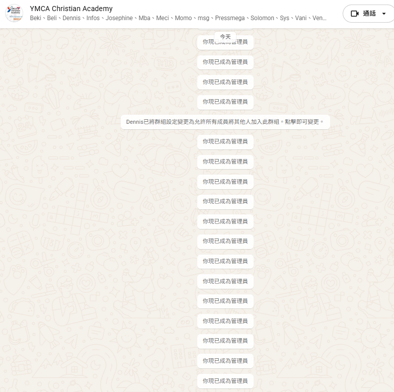

waited too long time, what's happened?
it just keep loop process the first action.

After reviewing the logs for your workflow, we have identified that the execution is exceeding the maximum 15-minute window allowed for a single run. When a workflow takes longer than this to process all items in an iterator, the task history may fail to display subsequent steps, making it appear as though it is stuck.
To resolve this and ensure all rows are processed correctly, could you please add a "Delay" step within your workflow (ideally inside or immediately following the iteration logic) This will help pace the execution and prevent the workflow from hitting the timeout limit.
Please try adding a short delay and let us know if the Task History begins to reflect the full execution!

how can it set 10 seconds delay?
Hey @gpro,
Unfortunately, adding delay in seconds is currently not possible.

but 1 minute is too long time per each action.
Hey @gpro,
We completely understand your concern here.
However, currently adding a delay of 1 minute is the only available option within the workflow. Since the execution is hitting the maximum processing time limit, adding the delay is necessary to help the iterator process all items properly without the workflow timing out.
For now, we recommend trying the 1-minute delay and monitoring how the workflow behaves afterward.
