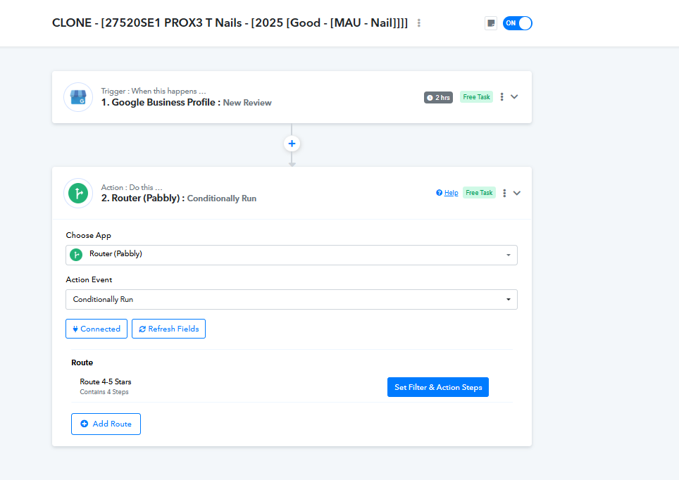

Why when cloning an old project the fields are changed?
Status: Closed · Asked by stevenphan on · 0 views
stevenphan — Question ·
Why when cloning an old project, the fields are changed, even though before, I just needed to clone and did not need to reselect the fields.

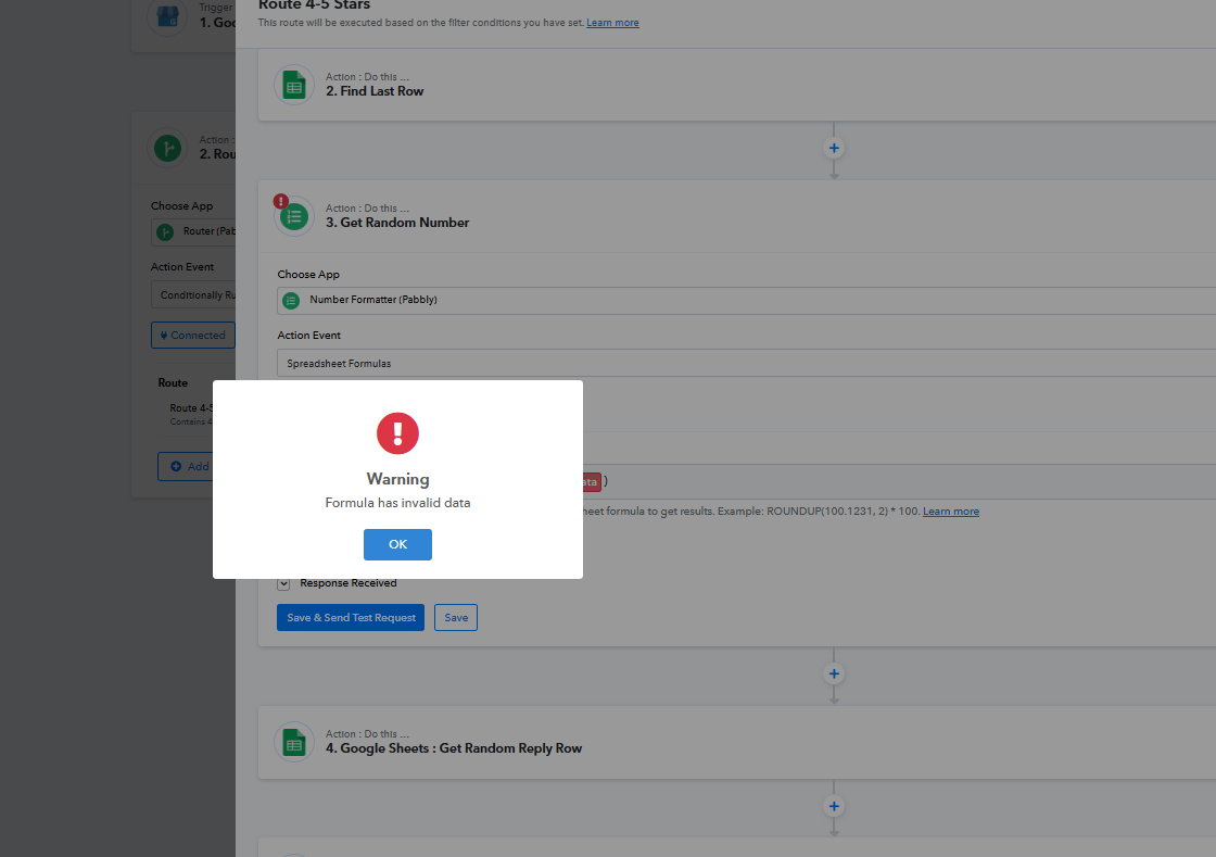

Hello @stevenphan,
Based on the warning message, it appears that the entered formula is invalid, which is likely causing the steps to show an error. We recommend reviewing the formula and ensuring it is correctly formatted.
Let us know if you need further assistance.
Fagun Shah — Reply ·
Hello @stevenphan,

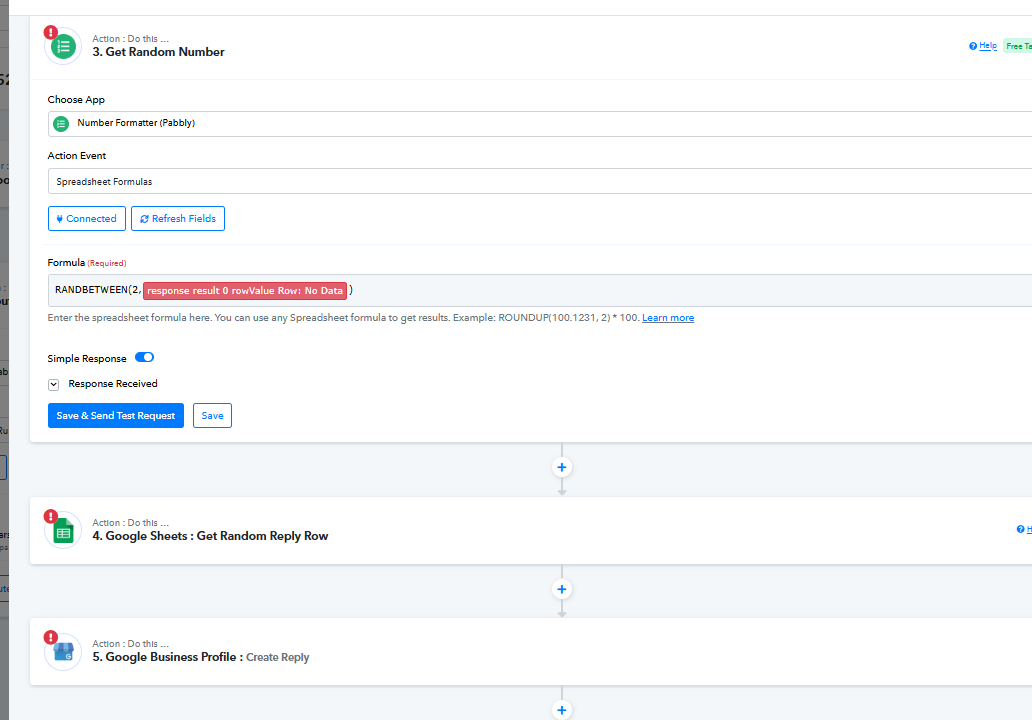

Check the error message again and see the screenshot again, it says that Formula has Invalid Data because there red colored mapping in the field.
Fagun Shah
- Automation Freelancer
Hello @Fagun Shah,
Apologies for any inaccuracies.
@stevenphan, please ensure that the mapping under the Number Formatter step is correct. However, if the issue persists even after cloning the workflow, kindly let us know so we can assist you further.

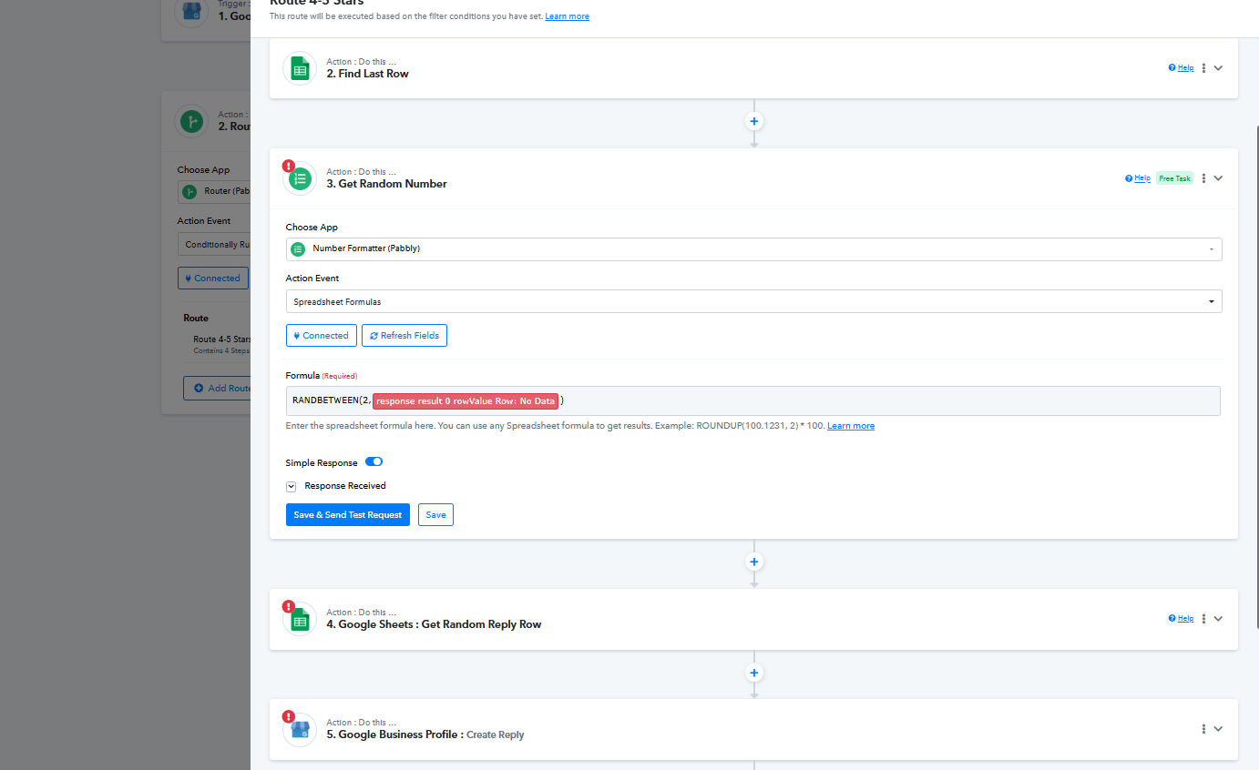

You can check, most of the field mappings are correct, but after copying it will give errors.
After Clone
After Clone
So you need to re-map those missing mappings,. otherwise it won't work.
So all workflows when copying have to remap the fields. But before when copying it was still normal without having to remap. Is there any change in the new update? If it has to be remapped after copying, it will obviously take a lot of time.
Hello @stevenphan,
This issue has already been escalated to our technical team. However, as a temporary workaround, you can simply copy and paste the action and then delete the previous one. We will keep you updated as soon as the issue is resolved.
Hello @stevenphan,
Our team has made some updates regarding the issue of workflows not getting properly cloned. Please try saving any paid action step in your workflow—this should prevent the mapping from getting disturbed when cloning a workflow.

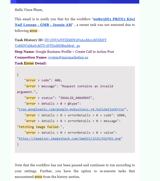

The problem has been solved, thank you very much. But I would like to ask, is there any way to fix this problem, although it still works, it always fails the first time the process is run. Is there any way to fix it from the beginning? Is it because of GMB API?
Hello @stevenphan,
Thanks for the update.
Regarding the GMB issue, it appears to be related to the file size. However, you don’t need to worry, as it has been successfully re-executed.
Let us know if you need any further assistance.
stevenphan — Reply ·
Hello @stevenphan,

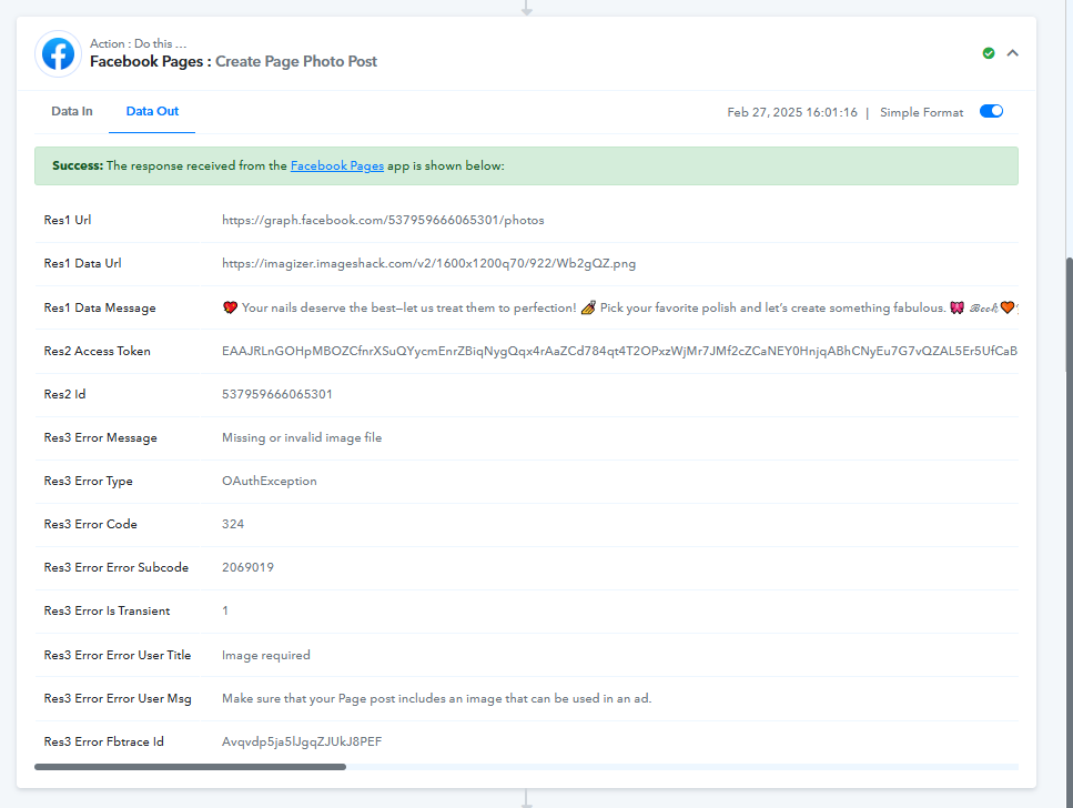

Also my process is failing at this step, however, there is no notification. Please try again at this step.
I have used a platform to publish the photo and fully meet the requirements of the end of the image. But still have problems, if there is any way to save the photo effectively, please help me.

Hello @stevenphan,
You can use File Uploader (Pabbly) to upload the file and then use the URL generated by this action to create the post.
Thanks you every much
