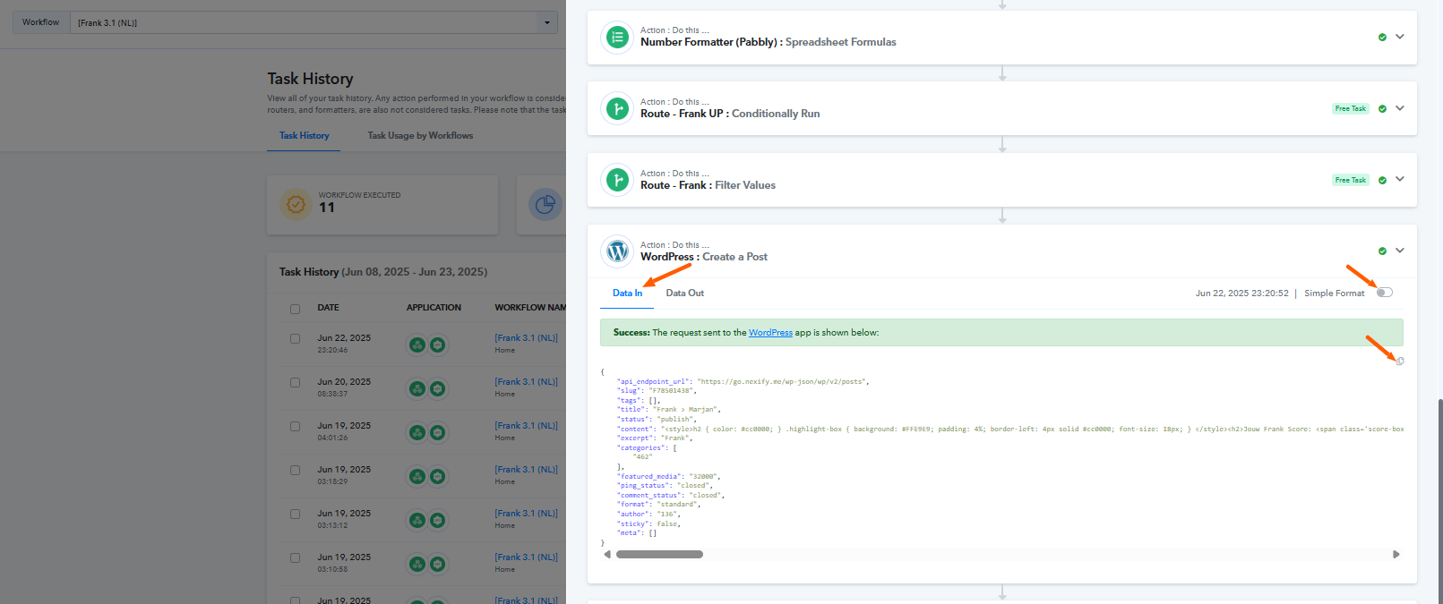

We now understand your concern more clearly. To clarify, Pabbly Connect uses the WordPress REST API to create posts. You can view the exact cURL request payload by checking the Task History section of your workflow. For your convenience, we’ve also attached an image to help you locate and interpret this data.
You may try running the same API request through a different platform (like Postman or a custom script) to verify the behavior. If the issue persists there as well, it’s likely that the concern lies with Polylang or the way it handles REST-based post creation, rather than with Pabbly itself.
We recommend checking if any custom code or plugin hooks can be used to apply pll_set_post_language() during REST-based post creation.
