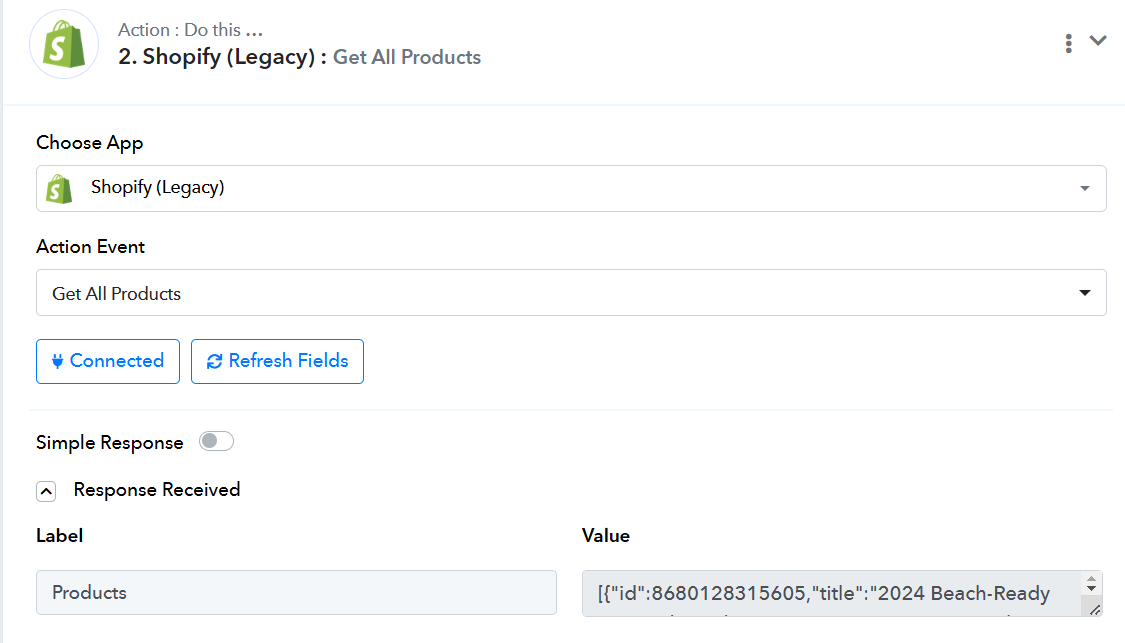

You can use Scheduler by pabbly connect in which you can schedule "Every week", and after that in next step you can use Shopify's get all product Action "With simple response turn off" that will give you array to process the data in iterator and after that use filter with your condition. Pabbly needs to update their actions and Apps according to Api doc that's why you can see changes in app.

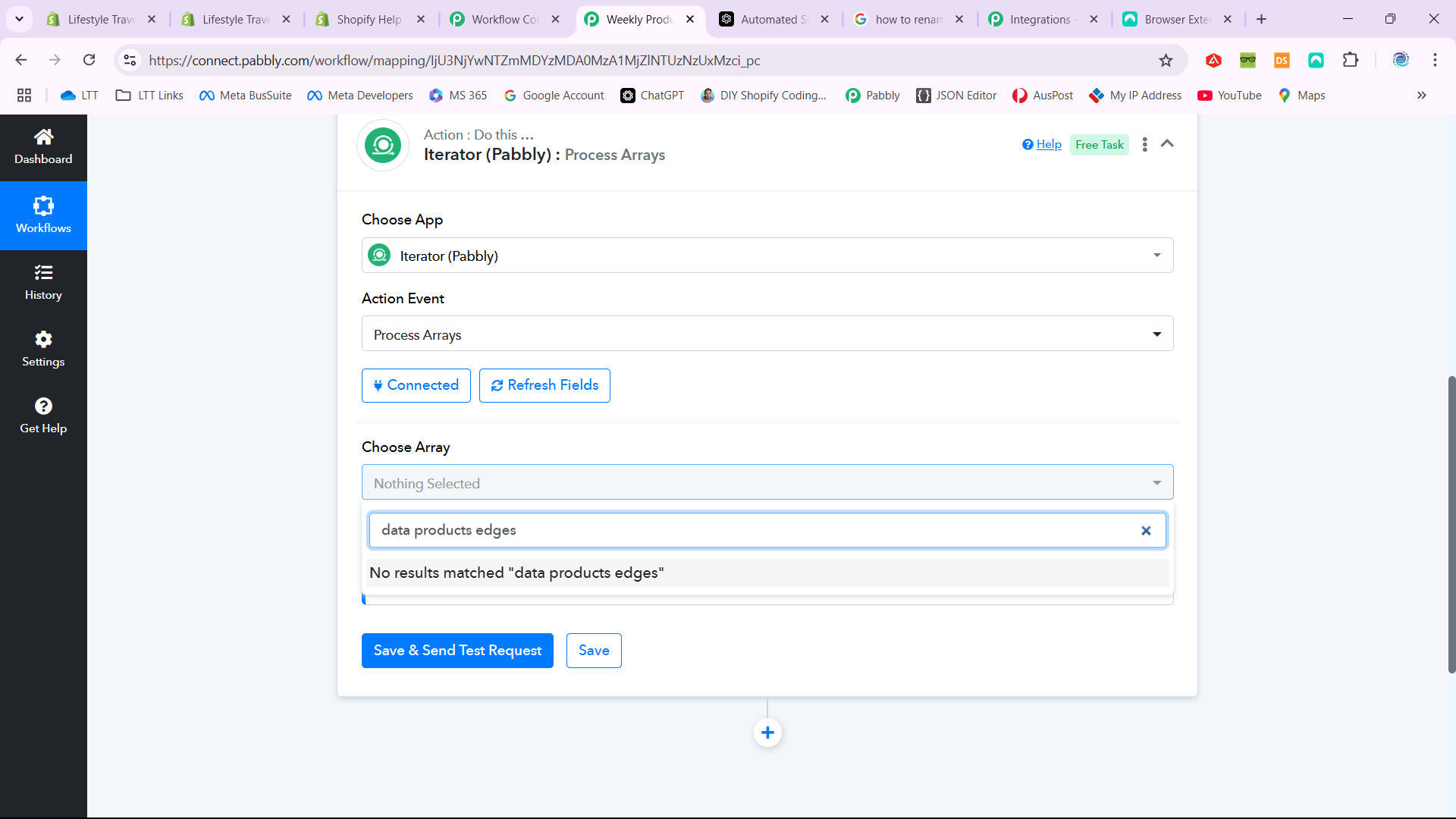

This is the type of issue I always get and causes me a ton of issues as no one on hand to help. I have started the workflow again, the first one is Schedule set for every 7 days at a specific time, the next one is Shopify V2 with get all products. This returns everything in one huge list of all possible variables for each product. It is divided line by line, But now I have added an iterator as per AI which is asking me to choose Data Products Edges. I have chosen Iterator with the only choice process arrays. I have connected, but there are no options to choose in the Choose Arrays drop down. I add Data Products Edges and hit save and sent test report - but the info I added does not stay and it returns an error
Warning
Please fill the Choose Array field.
Easier said than done when it is not giving me any options to choose. Pabbly needs a notification process when integrations are not working. This is so frustrating as it really slow me down and also makes me wonder if I am doing something wrong

Because you are not getting an array that's why you are getting this response.

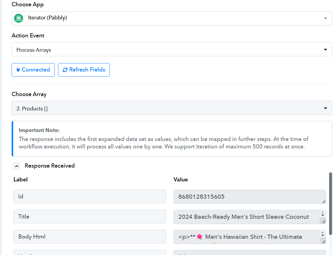

Now that i switched off the Simple Response it has returned all the information in one line and after the Iterator part works. This provides a whole list of data - so my next stage would be to set up processes to check for tags and sales and then update or add as required.? I wont need all the product returned results

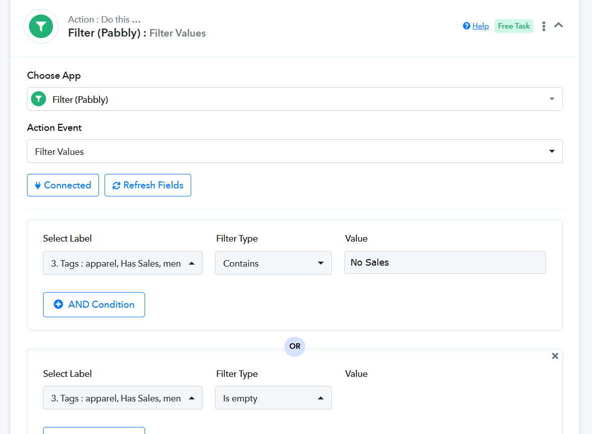

After the Iterator step, you can add a Filter step, which will ensure that the next step is executed only for those products that have a 'No Sale' tag or no tag at all.

Your next step would be filter.
