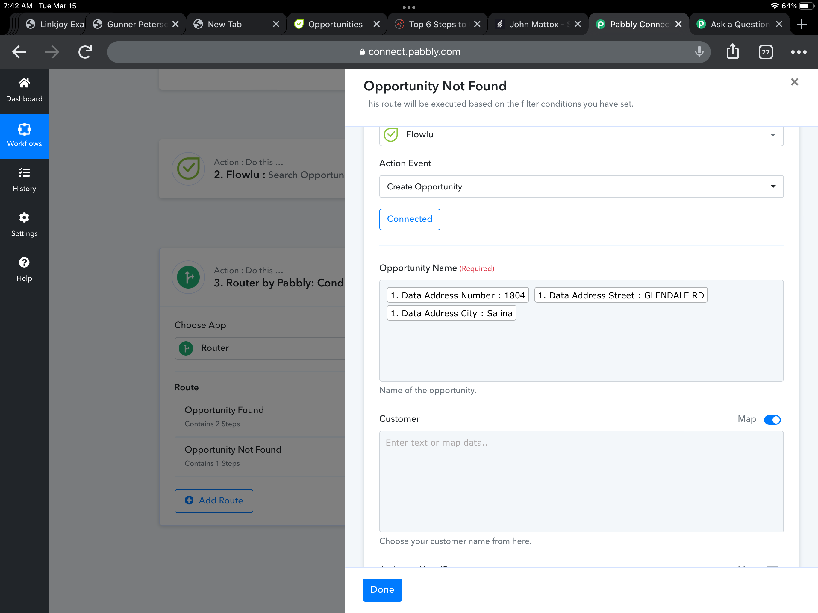

I have a workflow:
- trigger is webhook - working
- search for existing opportunity in flowlu - working
- conditionally either
- - not found make opportunity (no error just does not work)
- - if found update opportunity stage - not working. (Getting error: validation - please fill in all required fields - name cannot be empty)(it is not entirely clear what name this is referring to, the opportunity name has mapped data from the incoming webhook, see picture)
please help! I was having similar success and issues dealing directly with the api. Am hoping Pabbly makes this easier
John Mattox — Reply ·
The update path says success but it fails to update opportunity in any way. It should update the stage and add data to fields. It does neither

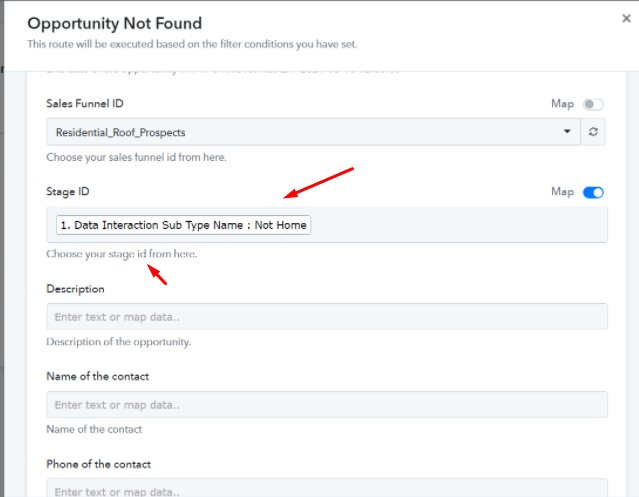

Hey @John Mattox !
As checking upon your workflow, we can see that in the "Stage ID" field, you have mapped a random value instead of mapping the "Stage ID"-
Kindly map in the "Stage ID".

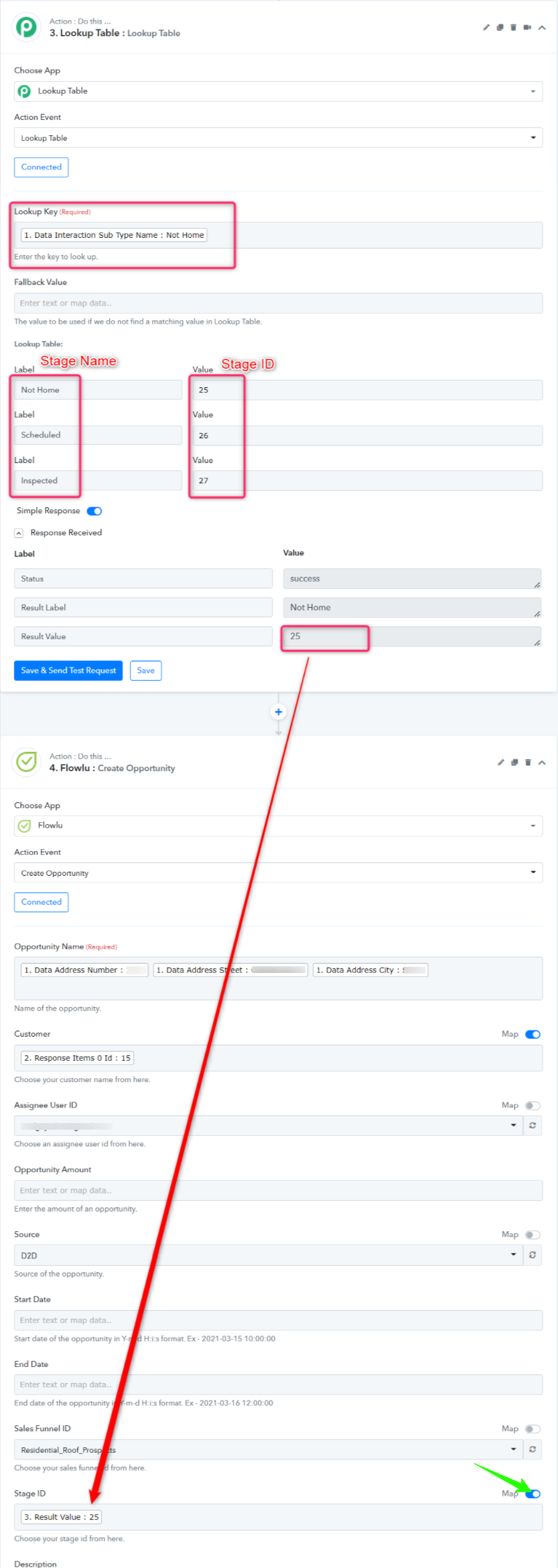

Also, just for a workaround on this concern, you can use a "Lookup Table" feature of Pabbly Connect to enter that value of the "Stage ID" which is required on a particular value.
You can check on this below image as what has been done for reference-
Kindly check on this workaround and let us know if it works for you now.
