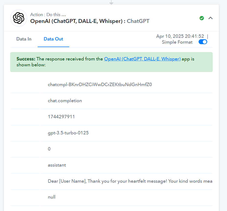

Based on your Task History, we can see that the workflow is functioning correctly and the replies are being posted on your Facebook page.
As for the reply generated by ChatGPT, Pabbly Connect has no control over it. You may need to modify the prompt in the ChatGPT action step to generate different content.

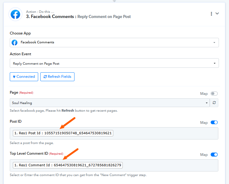

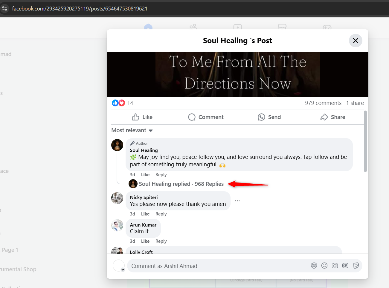

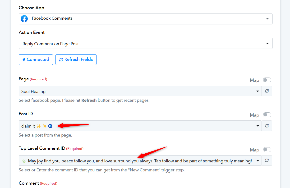

It appears that in the 'Reply Comment on Page Post' action step, the Post ID and Comment ID from the trigger step haven't been mapped. As a result, the reply is being posted on the same comment repeatedly.
Please ensure that you map the Post ID and Comment ID correctly from the trigger step.

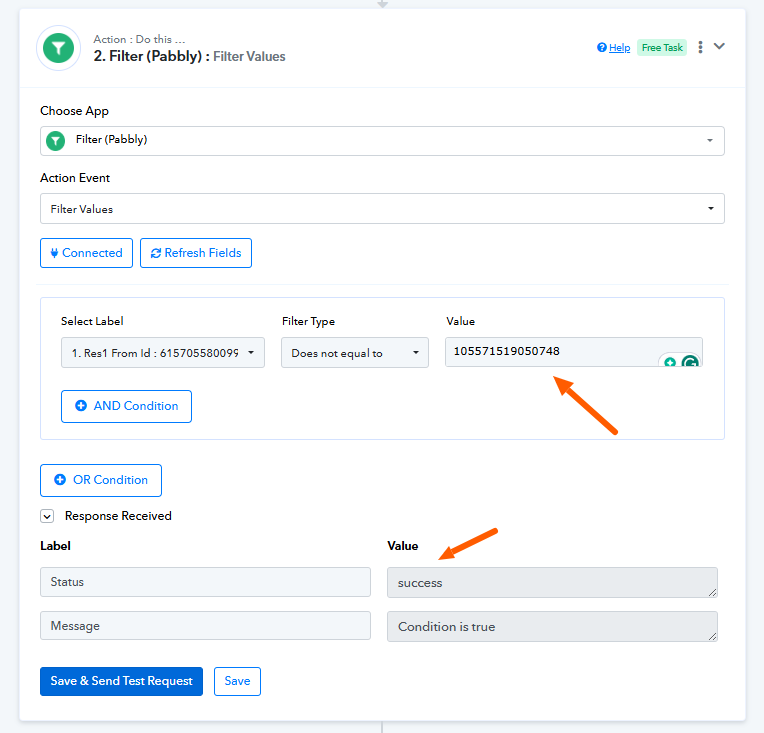

Please set proper my workflow . I have mapped the filter post ID and comment ID . Apply the filter so that my page cannot reply own comment . because I have set other workflow post comment automation.

I want in this it should not reply own comment . Like it doing right now
Hello @sonuku,
You can add a Filter step with a condition to check if the comment is not made from your account ID. Set the filter type to “Doesn’t Contain” and specify your account ID in the value field.
This setup will help you manage the flow more effectively and achieve your use case as intended.

can you please do that .
Hello @sonuku,
We have made some changes to the filter and it should work fine now, refer to the attached image for more info.
Please try adding a few tests and let us know if it works fine for you.

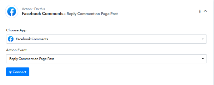

@ArshilAhmad Hello Arshi, do you know the reason why this "Reply comment on page post" event was removed? As far as I checked, there is now only one Reply option via Messenger. Looks like the change is from Facebook.
Hey @Pabbly Newbie,
The action is still available under the Facebook Comments application, refer to the attached image.
