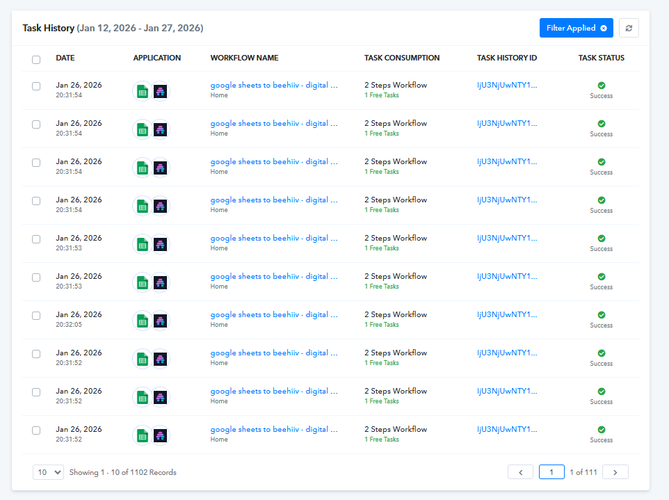

On pably it show that my workflow is active but when I went to laod leads onto my google sheet so they could be transfered to my beehiiv account nothing is happening. I tried a few days ago and only 12 leads got transfered out of over 100. I have waited a few days and closed the google sheet and re-opened it but still no leads are transferring. I am hoping you can help me troubleshoot the issue

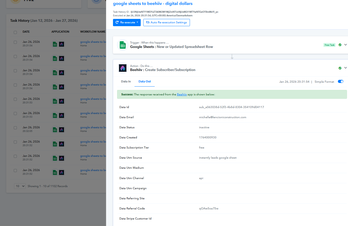

Hello @RyanG,
Thanks for reaching out to us.
Upon checking your workflow and task history, we can see that the workflow is triggering correctly and the Beehiiv action is executing successfully. The subscribers are indeed being created in your Beehiiv account; however, they are being added with an inactive status.
This indicates that the data transfer from Google Sheets to Beehiiv is working as expected from Pabbly’s end. We recommend checking your Beehiiv account settings to verify why subscribers are being marked as inactive (for example, double opt-in, confirmation requirements, or audience settings).
Please review this from your Beehiiv dashboard and let us know if you are able to locate the subscribers there. If you need help reviewing the Beehiiv-side configuration, feel free to share the details and we’ll assist further.
