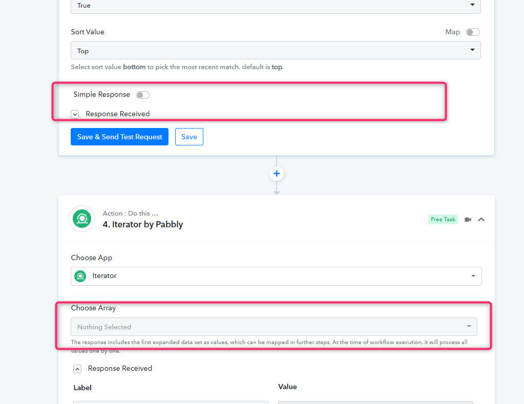

I have set a workflow. At the time of setting and testing it is working properly but when it is executing at its own it is showing an error (data not found).

sir mere evening ke to email ja rahe ha but morning ke email nahi ja rahe ha
Hey @anya mathur
If you are using the Iterator action step then you need to capture the API response in advance response by switching the simple response from the respective action step.
Although we have corrected your workflow and also the workflow will work when the desired date is present in your Google Sheets rest your workflow will work properly.
Kindly try again and let us know if that works for you.
