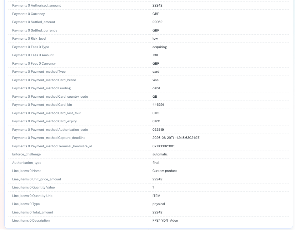

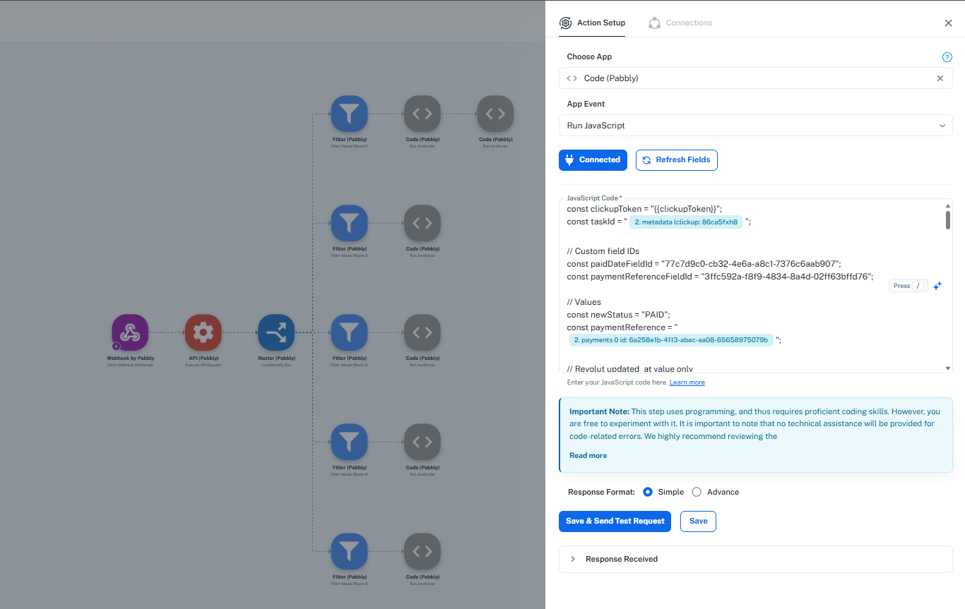

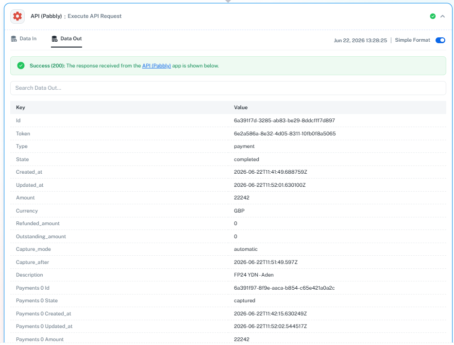

Hi Preeti I have another issue like one above.
I can see that the data does appear in a previous step but it does not load into the next api step.
It loads in as "" but in the previous step there is in fact an ID with a value.
History ID: IjU3NjYwNTZjMDYzNzA0MzM1MjZjNTUzMDUxMzE1MTY3NTQzNzBmMzYi_p
Could you please share a screenshot showing the exact step and the data you are referring to?
