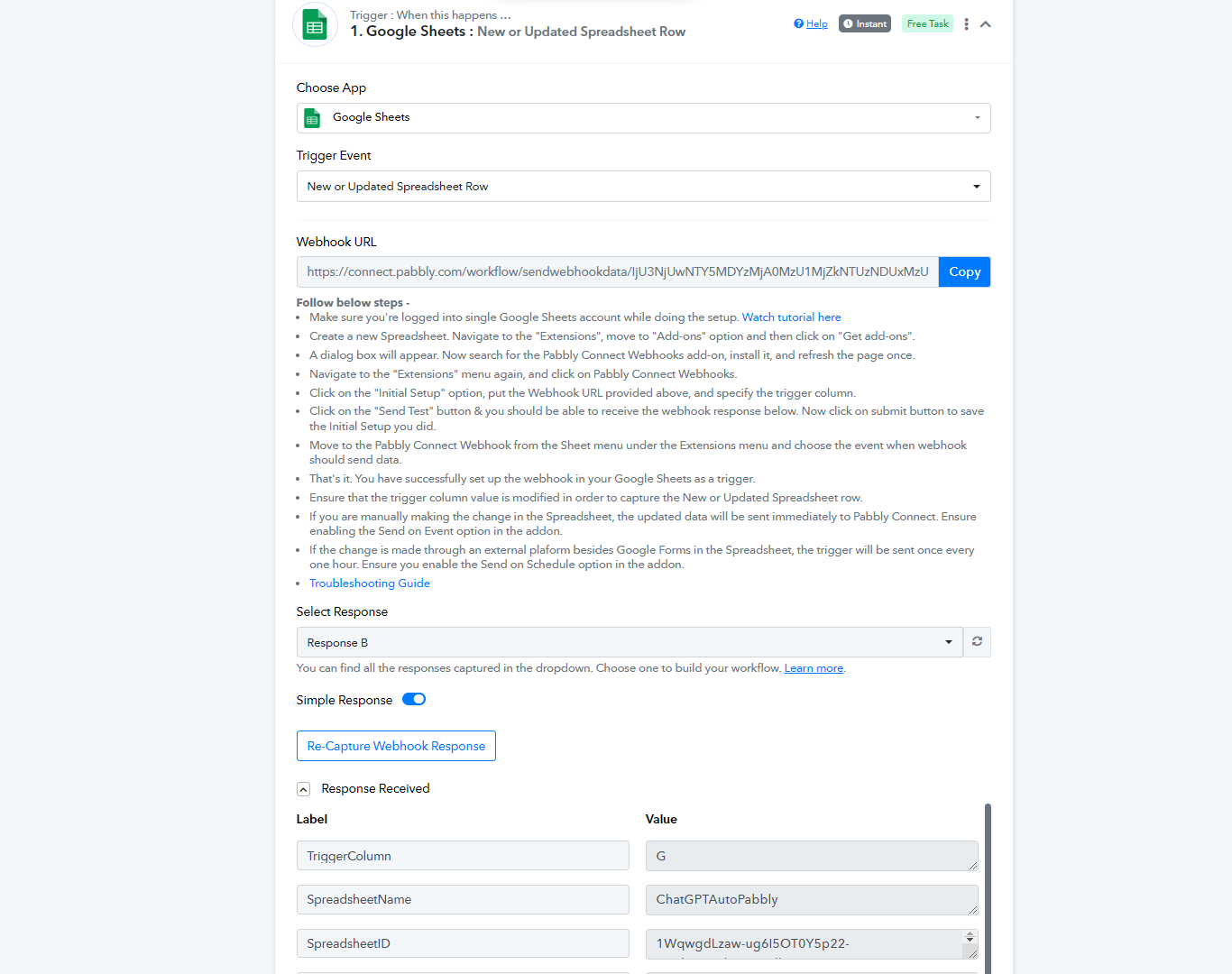

I am facing a major issue on my workflow, where the google sheets trigger is not fired. I inserted it right and tested the connection. Data is sent on testing the connection, but afterwards the workflow does not get triggered and it does not run therefore. Please help!
Hi @mattara,
To make automation work, you need to enable 'Send On Event' if you're manually entering data into your Google Sheets. If the data added to your Google Sheets comes from another API or third party application, you also need to enable 'Auto Send on Schedule'.
Please make sure that you have enabled the 'Auto Send on Schedule' feature.

Note: If your data is being added from an external source/API, your workflow will take up to 1 hour to get triggered.
mattara — Reply ·
Hi, thank you! That was the problem. Thank you, now working.

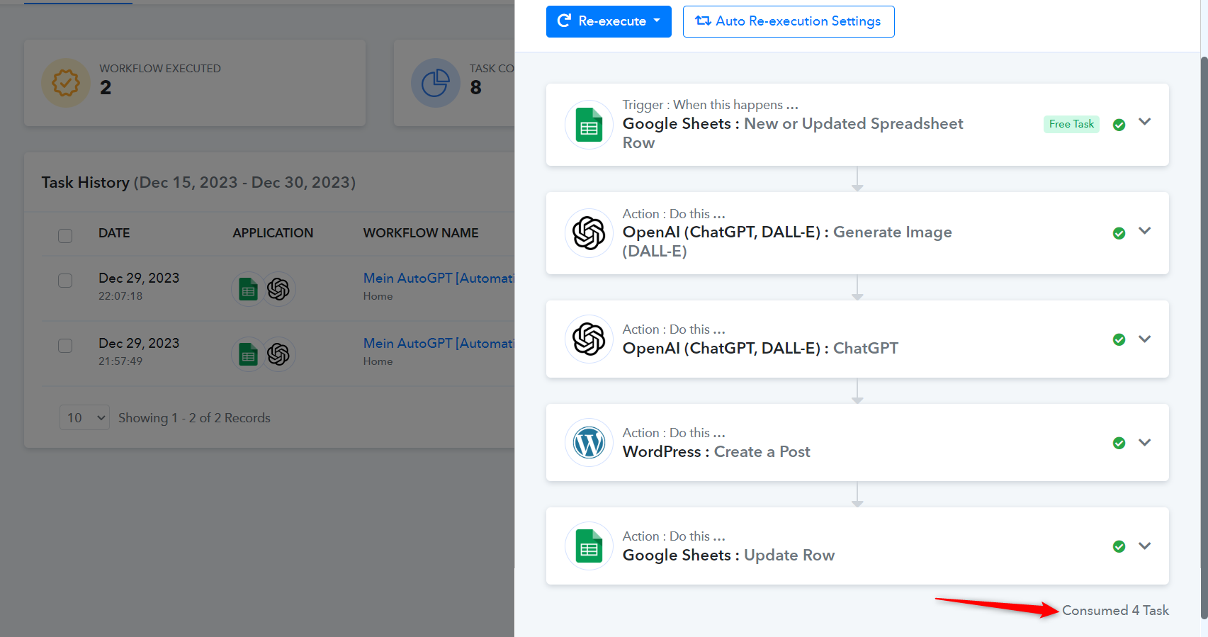

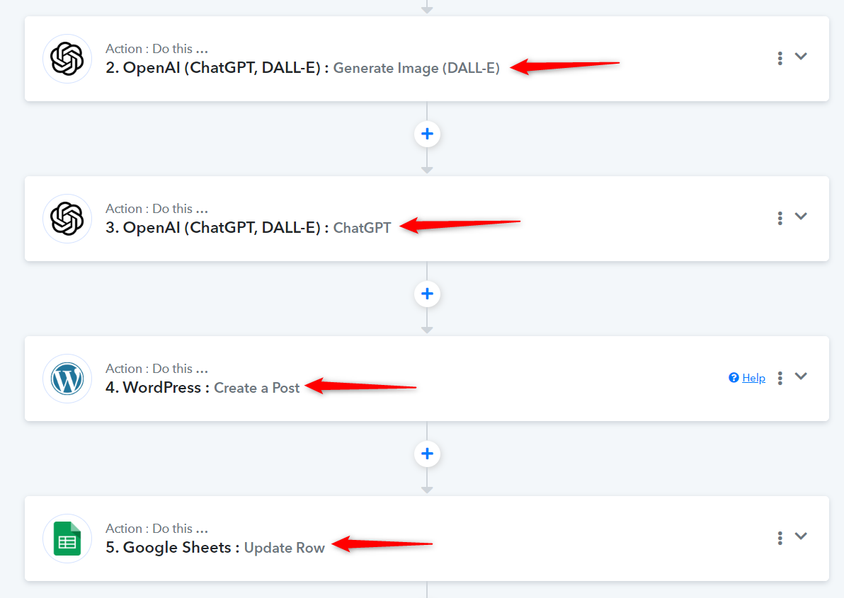

The workflow you have shared has 4 paid tasks.
Therefore, each time you add a new line to your Google Sheets spreadsheet and your workflow gets triggered, 4 tasks will be consumed from your allotted REMAINING TASKS.
